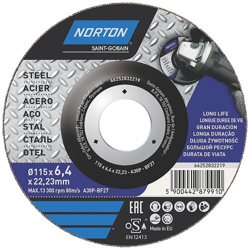

im not surprised it took so long the link is for a grinding dics not a cutting disc
cutting discs are 1mm - 2.5mm & yes it makes a massive difference
Oh, how long do you think it would take with a cutting disc? I effectively have a disposable link now so I can look at doing another test.
EDIT: Aw hell. I put the wrong bloody link and screen shot in the video. I actually used these.
Looks like I’ll have to pull the video and re upload it tonight.
Praise to Screwfix Hight Street Kensington for selling me the right disc.
