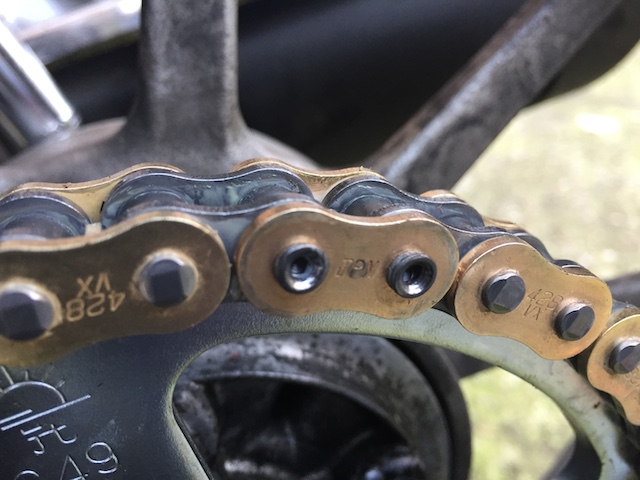

Thanks for all the help so far, two hopefully final questions.
First, slightly off topic, does this link look sufficiently riveted?  I cannot tell if it has stretched at all, but with the tool instructions saying it should only between hundredths and thousandths of an inch I am not sure how noticeable it could be anyway.  Kind-of wished I had just used the clip link instead, I know how to tell when that is on!
