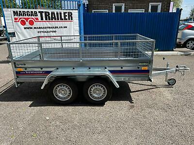

New car on order with a tow-hook though. Looking at two bike trailers. There’s a HUGE jump in price between open air trailers and box trailers. Wondering if it’s legal to take one of these and fabricate an enclosure for it. Wouldn’t be hard:

I’ve used my dad’s box trailer a couple of times, and realized I prefer open
If you get one narrow enough to not need mirror extensors, then you can’t comfortably fit two bikes wide. They look like you can, but bikes are surprisingly wide.
As for legalities, you can largely do what you want so long as it’s secure and but protruding too far from the end
