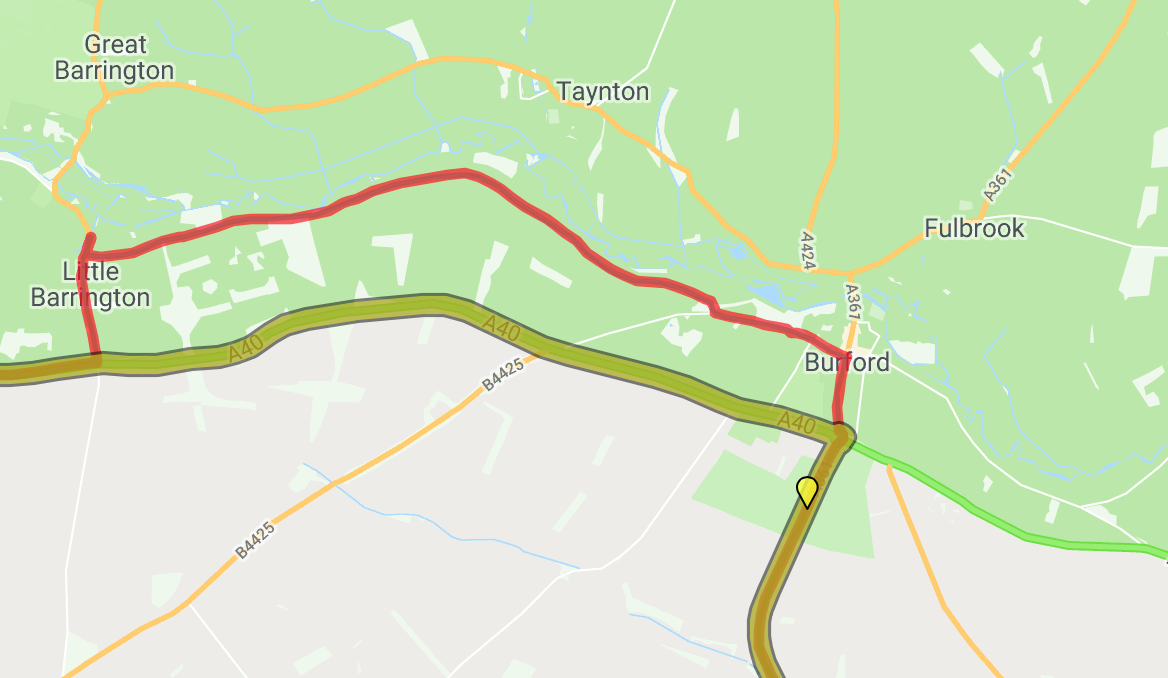

I was using an uploaded GPX route I had made.  I should have simply stayed on the A40 to Burford, then onto the A361 when they meet.  Instead it told me to turn off the A40 to Little Barrington, then take a gravel covered single track lane (with the gravel covered in moss) to Burford. And even after turning onto the A361 there, it still wanted me to go off and do other weird stuff to get to the A40 junction had I not been so confused by it sending me into a random residential street that I missed the turning.

There are three issues that may cause that
  1. Way points - check your way points. If you don’t zoom in enough when making the route its easy to have a way point just off where you really want it to be. I use ITN Converter to plan routes and zoom right in to max zoom to check that the way points are exactly placed right where they need to be.
  2. Mapping or file format compatibility where you plan the route on one map or convert the file from another format the end result can sometimes be a compromise when TomTom plots the the route, always zoom right in on the way points after compiling or converting route files to be sure to be sure.
  3. Windy roads setting. Selecting the last way point of a route file as the destination while in the plan a thrill mode. Depending on the windy roads setting you could end up going any which way to get where you want to be, its not a very good feature once you go beyond the first windy road setting.
My preferred map for planning route files is OpenStreetMap which in conjunction with ITN Converter appears to be perfectly compatible with all my TomTom Sat Navs (TomTom Rider, TomTom One and TomTom XL). It works fine compiling or converting TomTom itn files, TomTom ov2 files or GPS eXchange (gpx) files. I’ve also successfully used ITN Converter to convert Garmin files to TomTom compatible itn, ov2 and gpx files.
but if it’s following a pre planned route it will take you that route …
check your points and that the route settings match device and what you planned it on ie shortest/ quickest .
Yes, it should be following that preplanned route, which is why I am totally confused by what happened.
I was using a GPX file which I created (home made app using Google’s API), so no conversion issues.  And it is what TomTom calls a track. i.e. it has no waypoints, is instead just a list of points every hundred yards or so, and should be followed directly rather than the TomTom itself calculating anything.  And I also always zoom in to check the points are in the correct place when I create the file.  At least I have done ever since it tried to get me to turn onto people’s driveways!
Here is the Burford example, the yellow line is the GPX track I created, and the red line is where it recorded that I went.  Had I not missed the turning, the TomTom wanted me to follow the white line further to the east of Burford which eventually joins the A40, then head back west on that to the A361 junction.
As you can see the only pin I added to create the track was on the A361, the previous one was where I joined the A40 sixteen miles back, so no issues of me causing it.  And checking the GPX file there were 263 of calculated points along that section, and there were also no traffic problems to need to avoid, so no reason for the TomTom to have had to calculate anything there.
This has not happened before, but it makes it a little difficult to trust it when I cannot understand what happened.  It is normally so faithful to a route, as I said trying to force me to use closed roads, yet here it completely ignored the route.
I do know that with the ongoing heat that gps satellite fixes are a bit wayward .My hgv one is having issues staying on roads .
