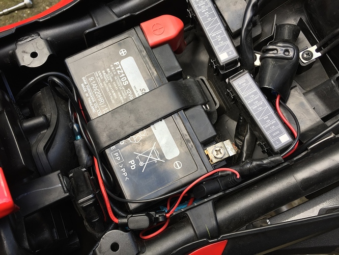

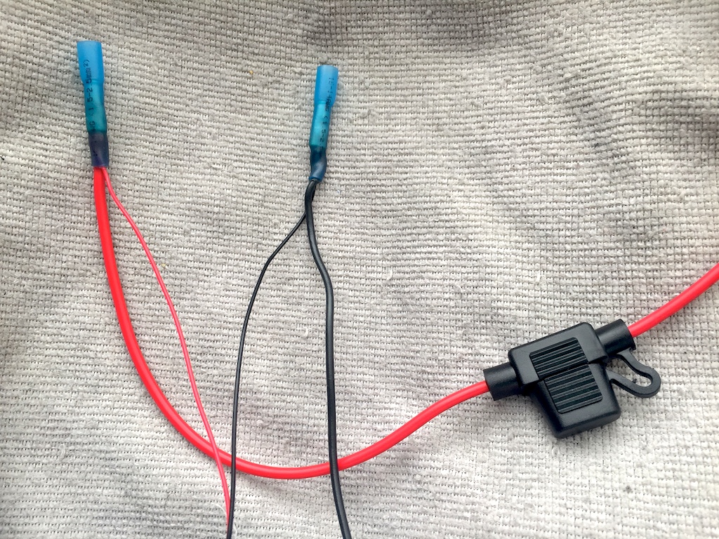

I found this. First picture part way through wiring a future proof accessory harness on The 250. Note the relay terminal 87, the terminal nearest the camera, with a pair of wires spliced into a female spade, one of these splices into another female spade the other into a butt connector giving four independent in-line fused feeds for 12v socket, 5v USB sockets, DRL’s, TomTom and a spare or whatever you want. Second picture almost the completed job with terminal 87a serving as a jump lead to the battery.

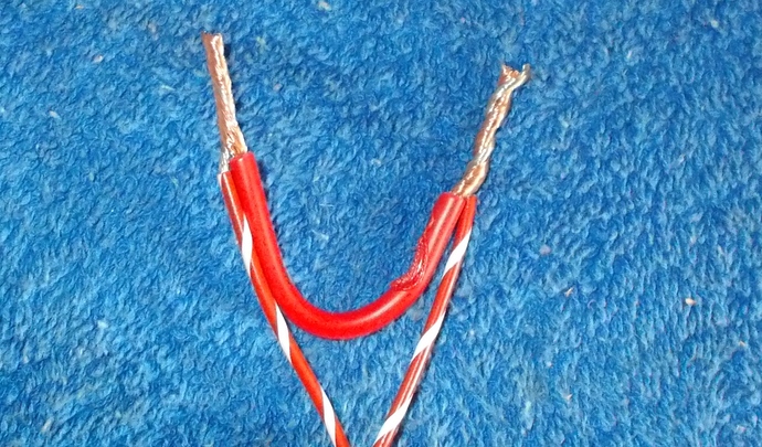

The way to do it is to fan out the individual strands of each cable and twist them together into three or four cables then twist the three or four cables into one as opposed to simply twisting two cables around each other. Left is the way to do it and right is a failure waiting to happen, apologises for the poor photo but you get the idea.
Very nice, and thank you.  Of course, the TomTom people soldered the loose ends of their cable, though was going to cut them off anyway.  Will all have to wait until Sunday now.
Soldering the ends is an option in a vibration free environment, for automotive applications twisting and crimping is the better option.

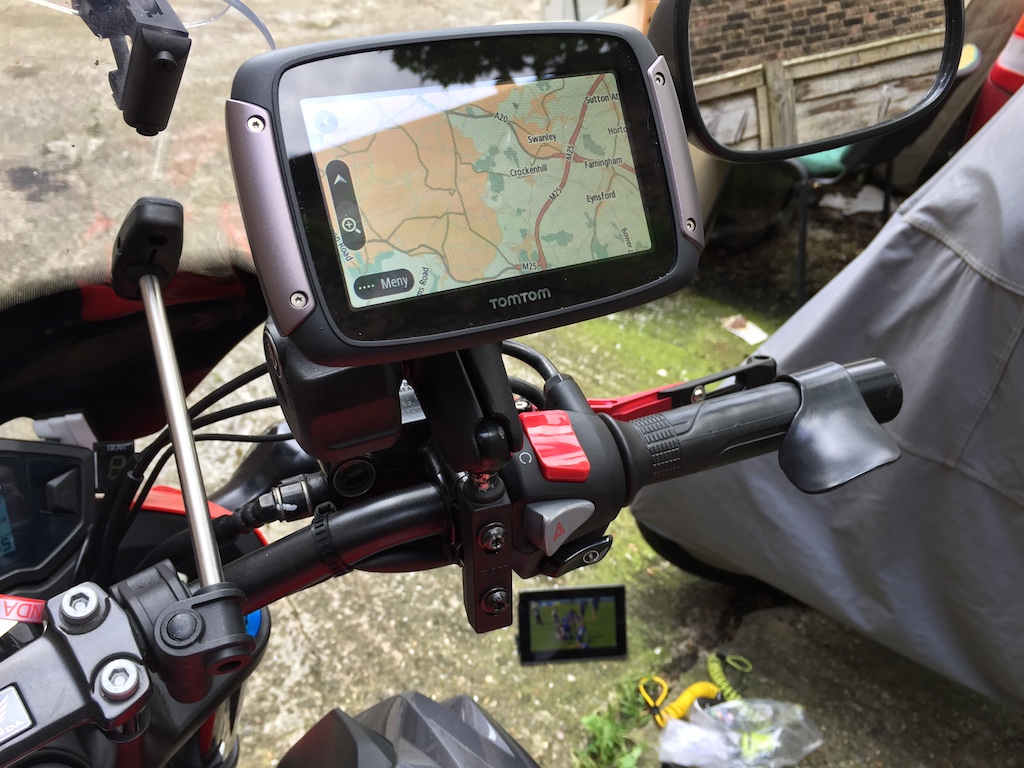

I replaced the included RAM mount arm with a medium length one which I already owned.  A better height and keeps the anti-theft knob out of the way.
All tucked away under the seat so it should be fine.
