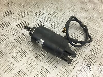

It’ll be the starter. The 675 and 800 engines share a starter and the older (pre-2015) ones tend to fail by around 35k miles
Get one from a more-recent engine off ebay (poke about on fowlers to get the part number you’re after) or a rebuild kit. There’s an american company (rick’s something?) that’s well-regarded among tiger owners.
is this what you mean? (although this is not a great example of one)
and this is the Ricks one… pricey
You want this guy: Triumph T1312223 Starter Motor, Black
So one with T1312223 on the label. That one is T1310060 which is one of the ones replaced by …2223
There are brush kits about I think, too, but I’m not certain. I’d have a poke about on Tiger forums to see what the current thing is, I had all these problems six or seven years ago now :frowning:
