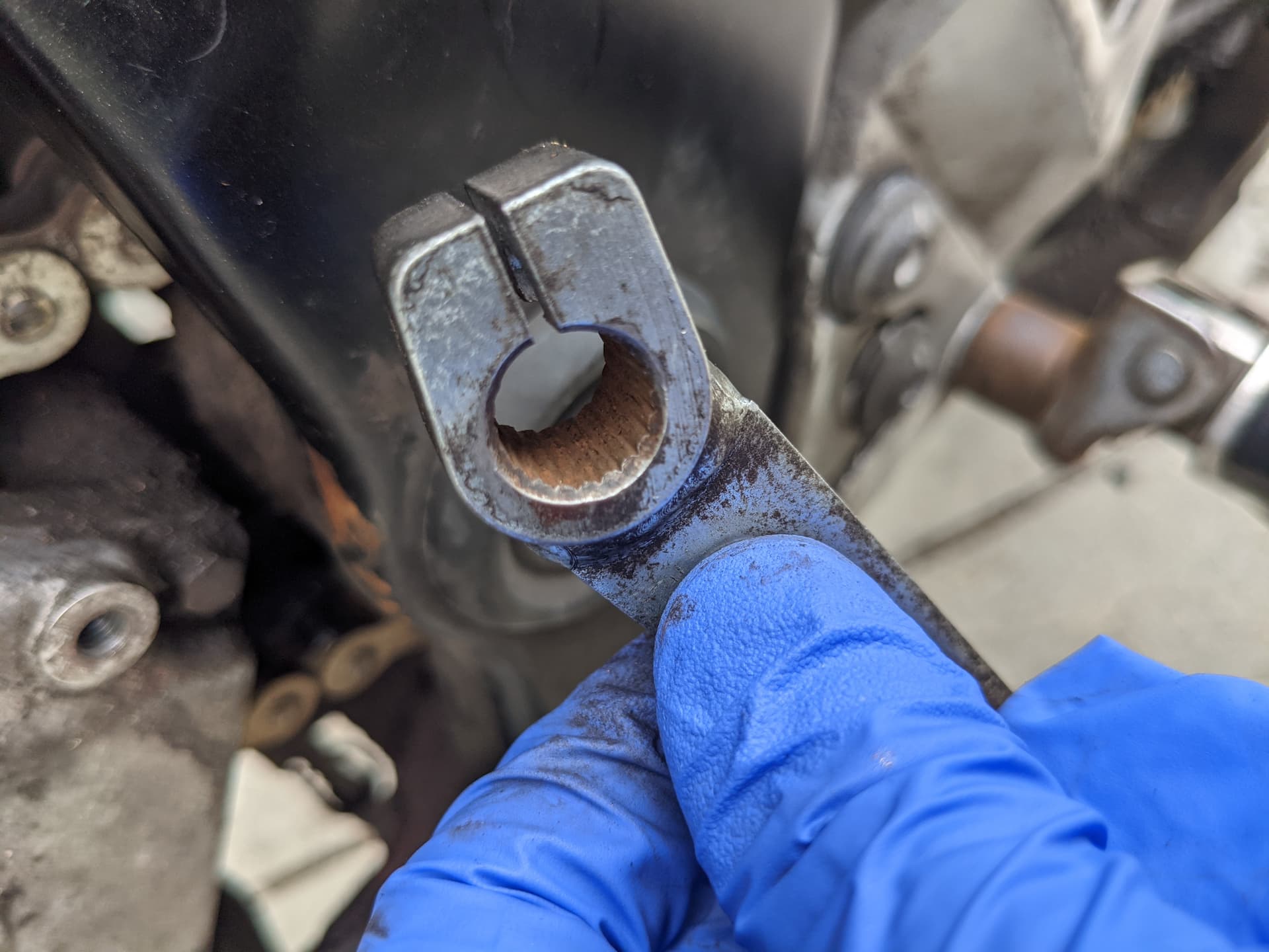

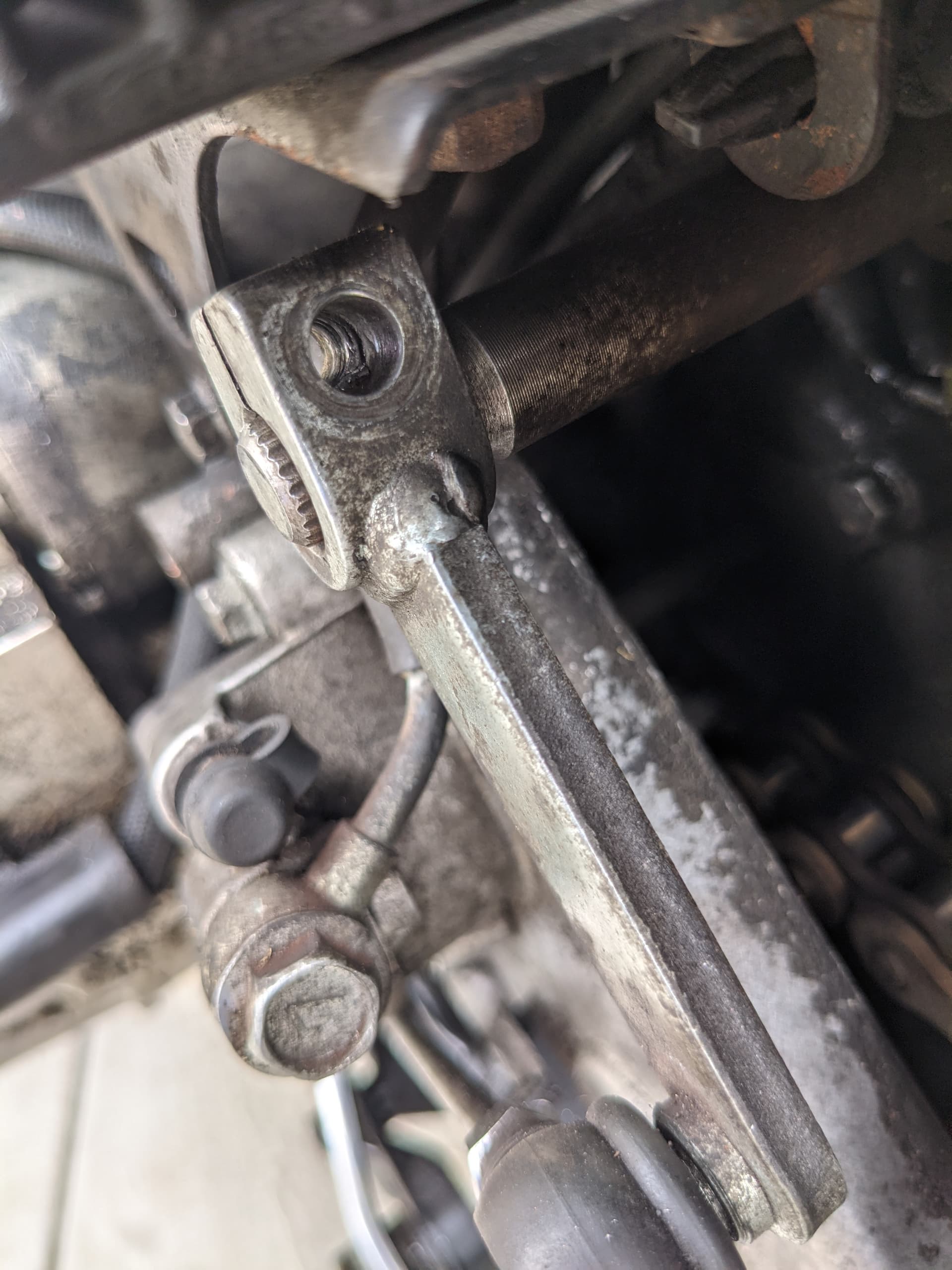

The shifter arm came loose and is revolving around the shaft like a carousel. From what I can see the thread is stripped on the pinchbolt and the arm opening it goes into, so I’ll have to replace those
Hopefully, I won’t have to replace the shaft - looks like a long job?

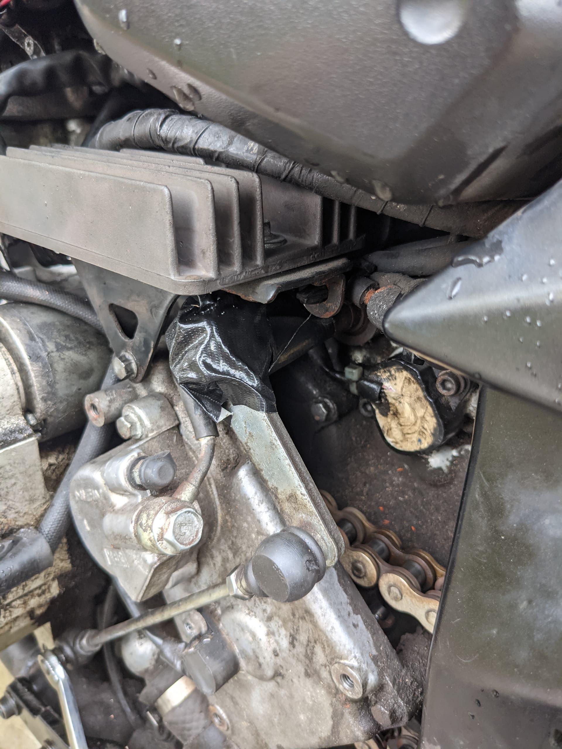

It doesn’t move around if it’s all the way to the inside end of the shaft, but starts moving when it gets closer to the outside edge of the shaft. I wonder if I can fix it in place so I can use it until the replacement parts come in a few days. Maybe wrap a generous amount of tape around the outside part of the shaft or something like that

The pinchbolt is purely to stop the arm coming off the output shaft.
What I fear is that since it’s loose, over time, the splines on the output shaft or the shift lever at the top have ground away and there’s so little connection between them that the arm isn’t engaging on the shaft.
If I’m right you’d better hope to everything that’s holy that it’s the arm and not the shaft that’s knackered. Take the pinch bolt out, take the arm off the shaft and lets see what state the splines are in.

Position where the arm does not revolve around the shaft.
Position where the arm does revolve around the shaft.
Nut and bolt all the way through …
Pinch bolt is to also clamp onto shaft tight by closing the gap …

The splines look good. As above if the pinch bolt thread is stripped replace the pinch bolt with a nut and bolt. If you can’t get enough purchase between the splines then put the gear lever in a vice, tighten the pinch bolt or nut and bolt to close the gap and then with two blades in a hacksaw re-cut a wider gap.

Just to confirm, a wider gap between the ridges of the spline? Just wider not deeper?
Currently, a generous amount of gorilla tape seems to work as a very temporary fix.
Just to be clear your cutting a wider pinch gap to decrease the diameter of the gear changer pinch on the shaft, your not re-cutting the splines.
Oh, you mean like this? That makes a hell of a lot more sense ![]()
