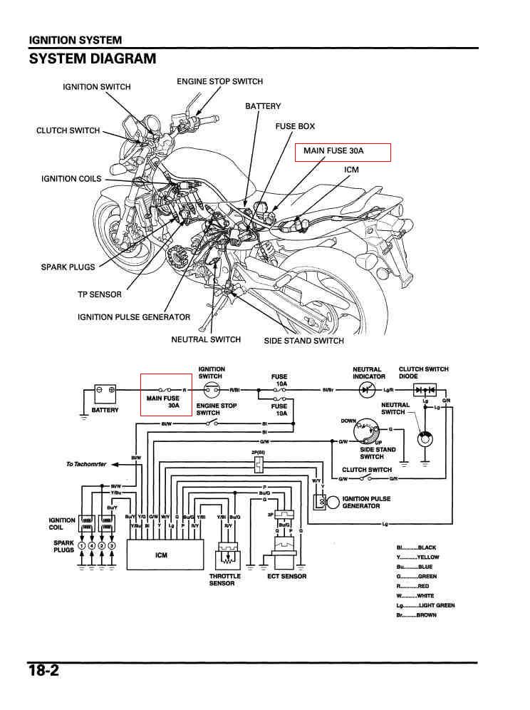

Going home last night from work when my bike died. Was on Peckham High Street, doing 30, in fast moving traffic when, well, nothing. All the electrics went dead. First instinct was to hit the hazards so that the car behind me didn’t smash into to me, but of course that didn’t work. Managed to pull into the middle of the road though. Then had a nightmare time getting off into a side road.

So that is my tale of woe. Any ideas what could have gone wrong!? My first thought is that the alternator has gone based on the fact that it is has something to do with a electricity and I know the name of it. Does anyone with a slightly finer grasp of mechanics have any better ideas?
If you have no power, then it is either your battery or possibly fuse?
If your battery is dead, then you could have a faulty Regulator Rectifier?
Do you have a battery charger?
First check would be battery terminals to make sure they were clean and tight.Then as suggested check the main fuse - There is often a fuse, well hidden sometimes, that everything goes through.
Could be regulator, rectifier, generator, battery etc. but unlikly to leave everything completly dead like that as they will tend to leave a battery that is very low in charge but but wil lstil lshow some life - for exampel the hazards didn’t work in this case.

Checked the main fuse box and everything there was ok. Not sure if there are any other fuses.

So there is a main fuse, seperate to the fuse box then? How would that blow?
there usually is a main fuse somewhere near the fuse box. it sits between the battery and the reg/rec. the other fuses are part of the electircs
Ah ok. Just had a look at the owners manual (you can DL from the Yamaha website - sweet), and have found where the main fuse is.
That a bugger, I thought I was doing everything right checking the fuse box. Didn’t realise there would be another couple lurking about.

Right. I have just got home from the pub. I have been drinking since work ended at 5 ‘o’ clock, so I think it is fair to say I am pretty well intoxicated. Not only am I drunk, but it is dark outside, being as it is nightime. My bike is also, for the record, not parked under any street lights. And I, from the advice garnered here, and from DL’ing the manual earlier off the Yamaha website, have just fixed my bike.
It was the master fuse. I have it here in front of me. This little ******* bugger, barely the size of a thumbnail, nealry got me killed.

Thank you LB. I feel quite good, and releived, that this fix has cost me no money, no hassle, no problems with getting to work. It is a lesson learnt. There may be a box saying “FUSES” but not all of them lurk under it. The master has his own pad away from it.
