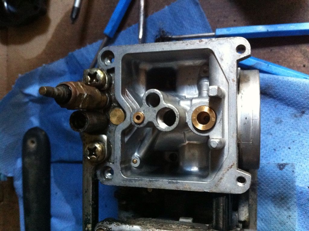

Conrad: I completely cleaned them! diapragms/floats/jets/seals you name it, the in side is shiny as new! (thats the only picture I took of the mafter the cleaning procces!)

When you put the carbs back together did you screw the jets back in to the exact same number of turns as before? This will affect the petrol/air mix…
They will also need balancing after having been removed and rebuilt.
Nice cleaning job though! Good on you for getting stuck in
Same number of turns? huh? The only ones I done for the exact amount of turns was the little screw on the left next to the gold pin… (9 o’clock) The actual jets inside I just tighten back up in there…

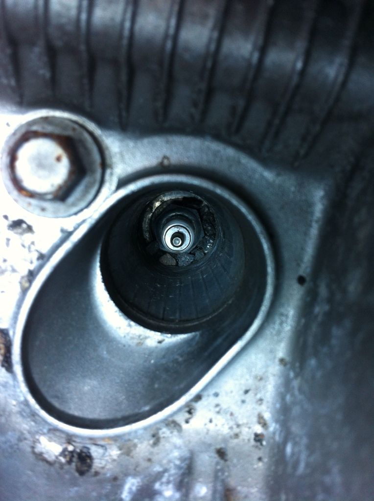

I did ride it to the bike shop to buy the sparks, halfway home she cut out and wouldnt fire at all, i left her for around 20mins and she fired (although very spluttery) then idled fine, rode again for about 2miles and she died. waited 20mins an she started etc etc… got home changed all the spark plugs (after finding aload of stones over spark no 3, romoved them before taking the spark plug out)

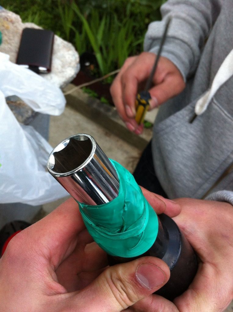

Had a friend come round last night who is studying mechanics he said it smells rich, hes going to come round during the week and adjust it all… (once i get some time off work!!!) starting to seem like itl be easier to sell it and buy a new one!!!
I cant take the plugs out… the tool is at my friends house and for some reason out of all my tools I dont have a socket long enough to fit! :blush:
But… I did fire her up just now and noticed a slight spitting nose… I put my race can onto the end of my stock can and realised its actually backfiring (when Idle) ever so slightly… does this help work it out?
