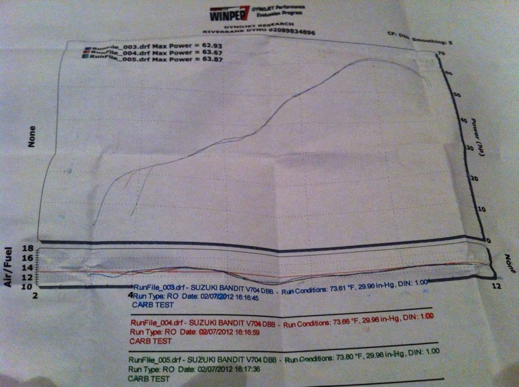

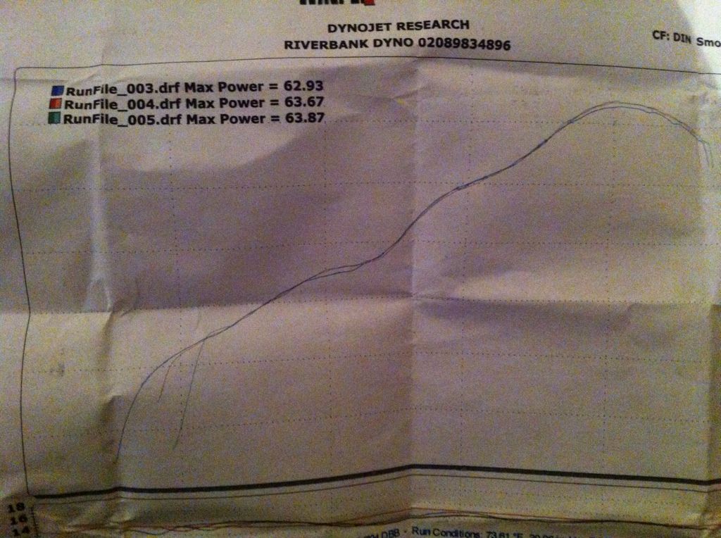

So I have just got back from RIVERBANK MOTORCYCLES who put my bike on the dyno and gave it a run!
They said its running too lean. possibly due too an air leak… He had a butchers and couldnt find any :smiley:
So he said it has too be the mix, he adjusted my 2 outer carbs and it seemed to start sounding better, but he couldnt reach the inner 2 so I have to wait till my engine is nice and cool before I attempt it…
http://www.totalmotorcycle.com/downloads/dynocharts/dynocharts-suzuki-1995-04SuzukiGSF600Bandit.htm
According to that … You could do better :smiley:
I know I know…
He said its too lean so once I fix that im going to put the Viper system on it along with the K&N and take her back… Im hoping that is why its not so great!
