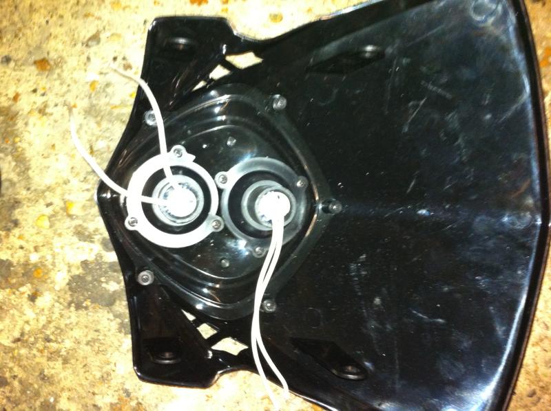

Have this headlight want to wire to front of bike but cant get my head around it…
All it has is 2 white wire coming from eash light at back…
Back of light
Any help be much appreciated
Thanks Dan

I have wired them in myself a few times . They mark bloody nuthin these days . I get a few connectors and splice the wires together thus leaving you with only 2 wires in effect . Then it wont matter what goes to + or - as its just a current through a bulb . So find your existing headlight wires and hook em up and yer done . Unless you dont want em both on and you want one to operate as a sidelight . Then hook one up to your existing sidelight and one up to the head light .And yer done . Once again the + - wont matter .
Don’t tell me your getting rid of the fairing captain slow.
as above if ur having them both on at same time .
If ya having one for high and one for low beam, then first make sure they both work no mater what wires are + or -, then just wire one wire from each light together as earth , then the other wire from top to high beam wire and other wire from bottom light for low beam…

And yer Dan going unfaired only going to smash fairing up anyways…
Ahh yes dipped … I was assuming stunt bike lights not for road
i was wiring in main and high beam and stunt bike has to look semmy legit

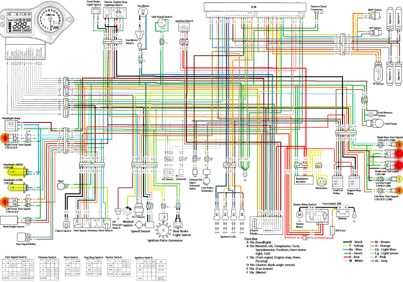

Just found ( and pinched ) this off another forum.
Says its for a F4i, not sure what year …
It shows it has 2 head lights , 1 for high, and 1 for low beam …
Green = earth/-
Blue = High beam live/+
Blue/White = Low beam live/+
If ya still have the standard wires and switch gear, just wire up ya lights to these ,so one would be high, and one for low ??

i think this is the California model F4i as dosent have sidelight in front
