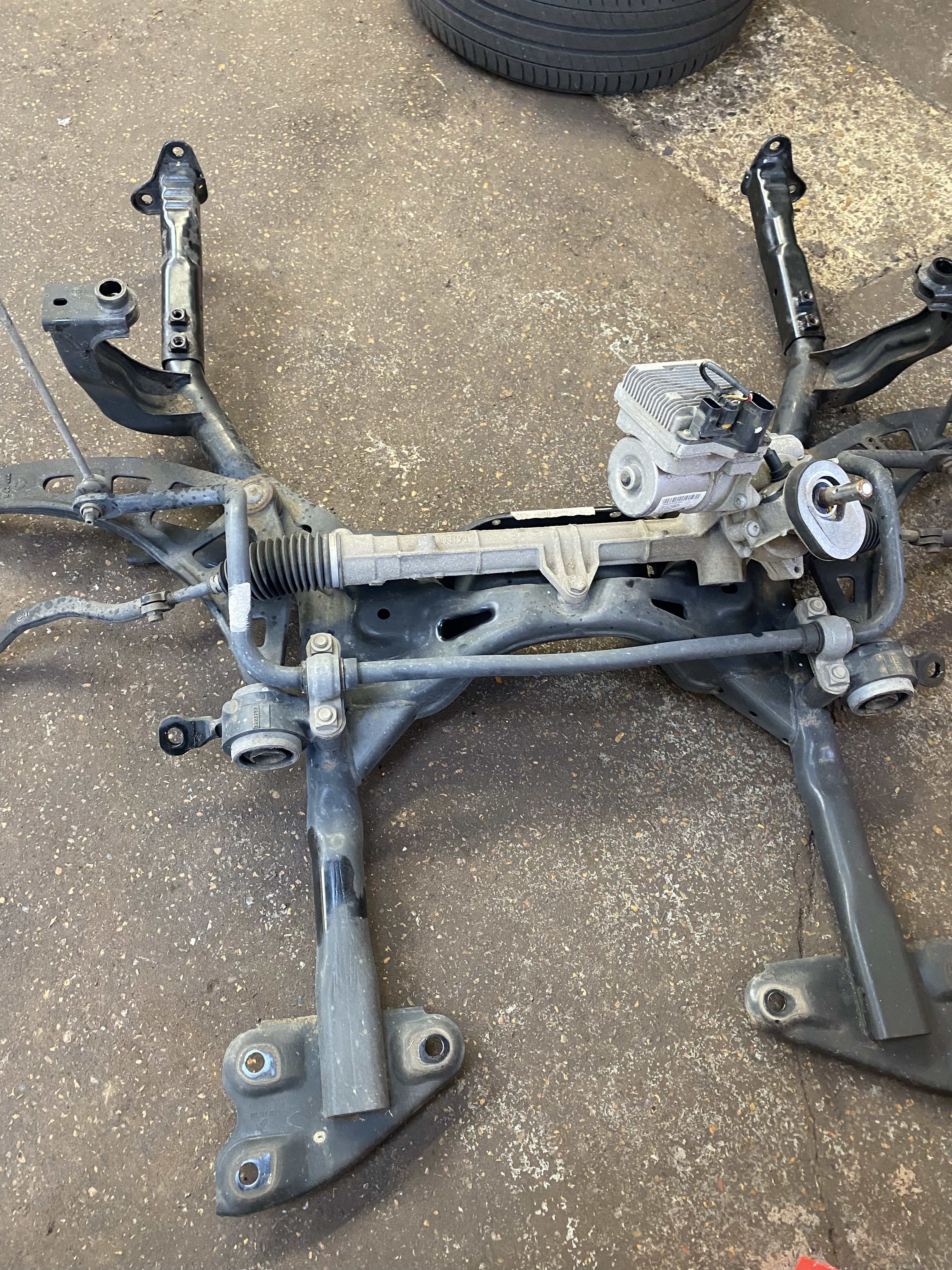

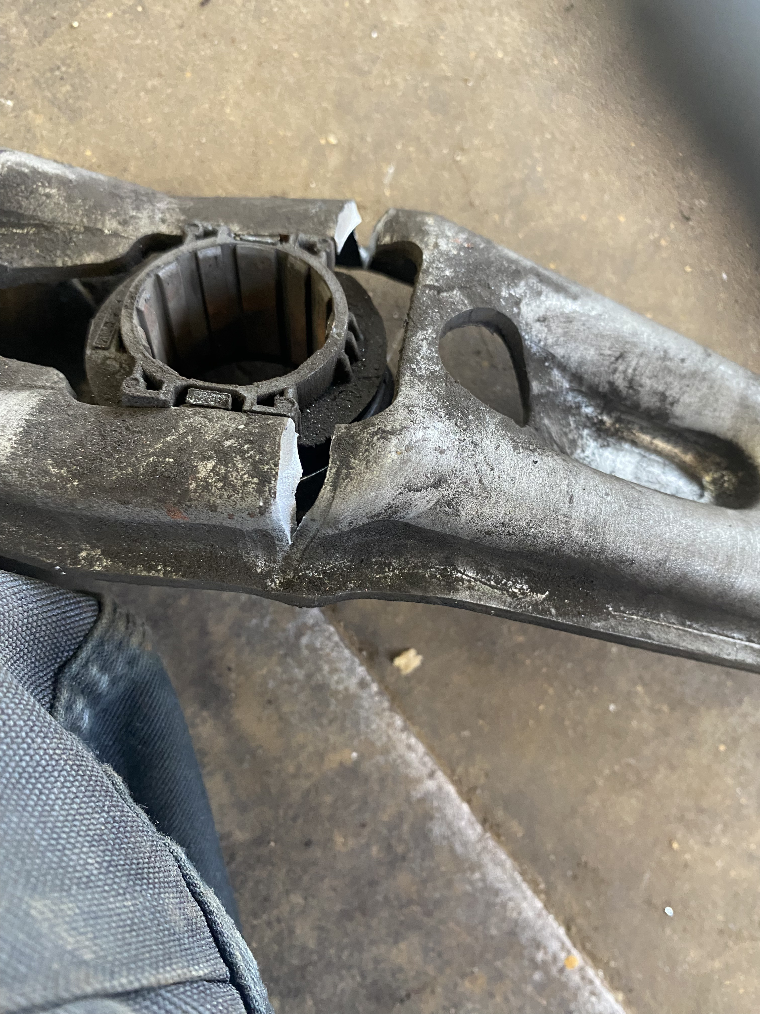

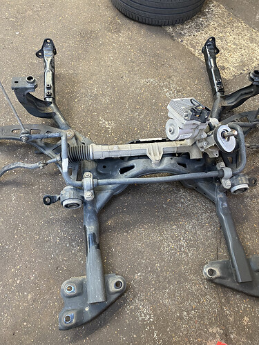

Unfortunately nothing is as simple as it used to be. Many years ago (over 20) I changed clutches on cars taking the gearbox out then refitting it no problem. When my wife’s Mini clutch went recently the fork had snapped. This is a picture of what the garage has to remove to get to the clutch.
Oh lord. I was watching a YouTube video about how to change the master cylinder on a V70. 10 minutes in he was still removing parts that were just in the way.
