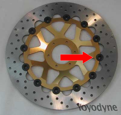

ex mechanic I know instantly suggested that dirt/road salt had got into these “spacers” on the disc
He said there should be some slight movement, allowing the rotor to move when braking and there wasn’t any.
It felt like a pulsing, brakes going on and off…warped disc.
I gave them a good clean…squirt of WD40 (carefully wiped off) and a gentle tap with a mallet.

had the same thing was a bent disc carrier. take the calipers off tape a pen bolt or what not steady to the forks with an end flush to the disc then slowly turn the wheel to see if the disc pushes or dives check both sides.
To check if the rivots are loose just hold the brake on and pump the forks any clicking or movement will be them
