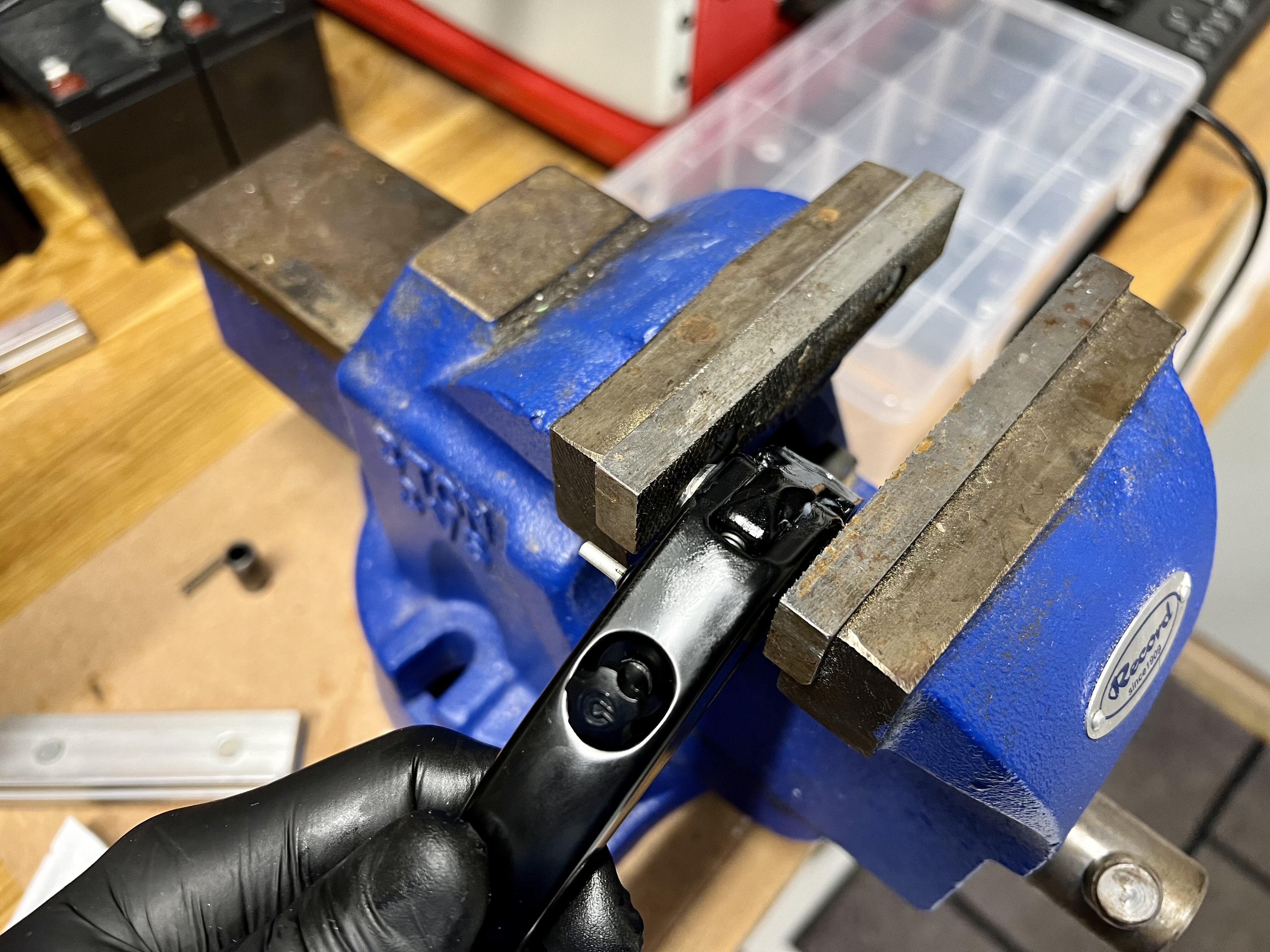

Replaced the clip on bar and clutch lever today.

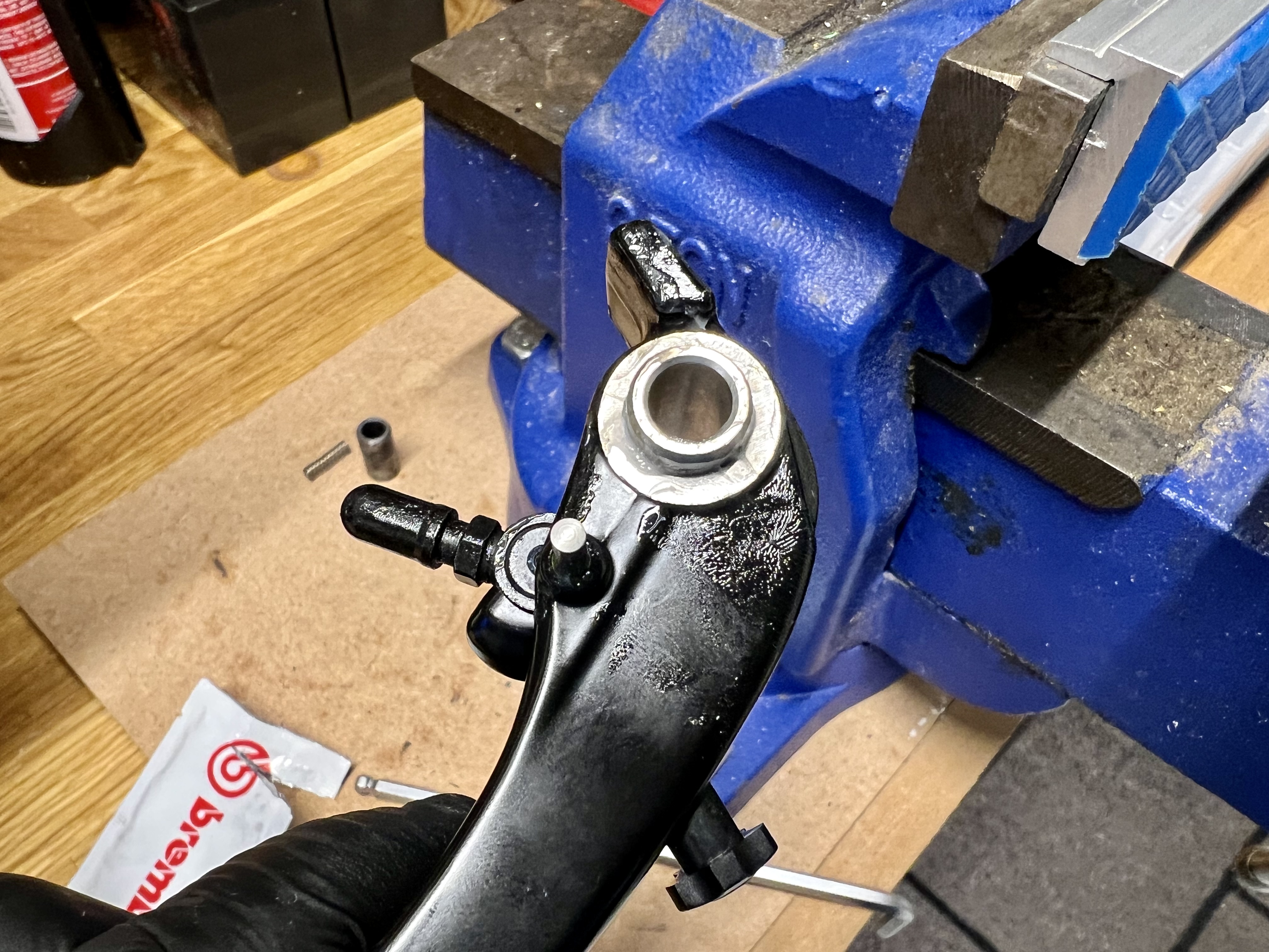

The bar was simple, the clutch lever was tricky due to not knowing how to get the main pin out (used a vice in the end), and difficulty getting the plunger through the boot. Ended up using some pliers to hold the boot in place whilst pushing the plunger in the boot.

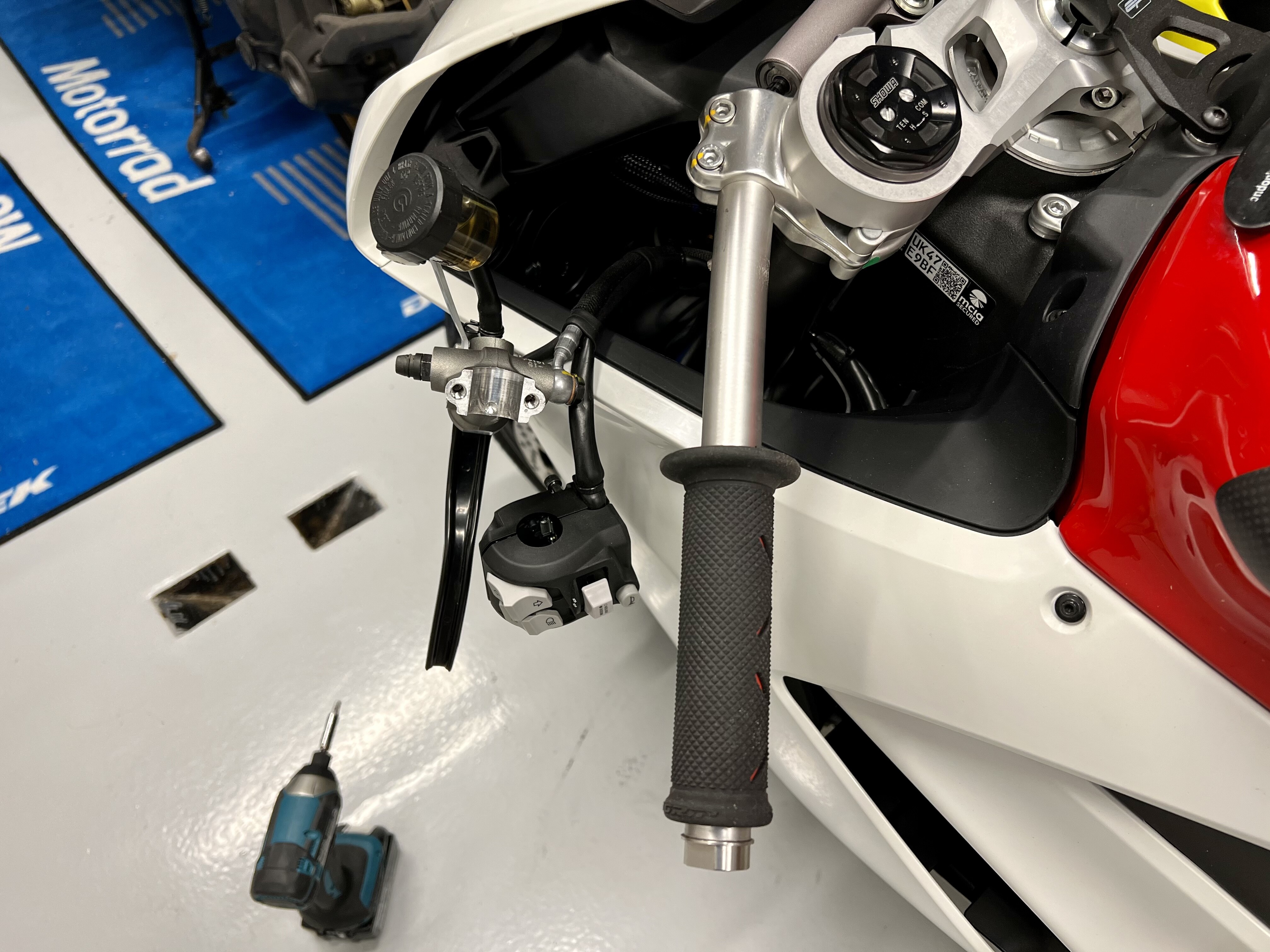

Exposing the bent clip-on

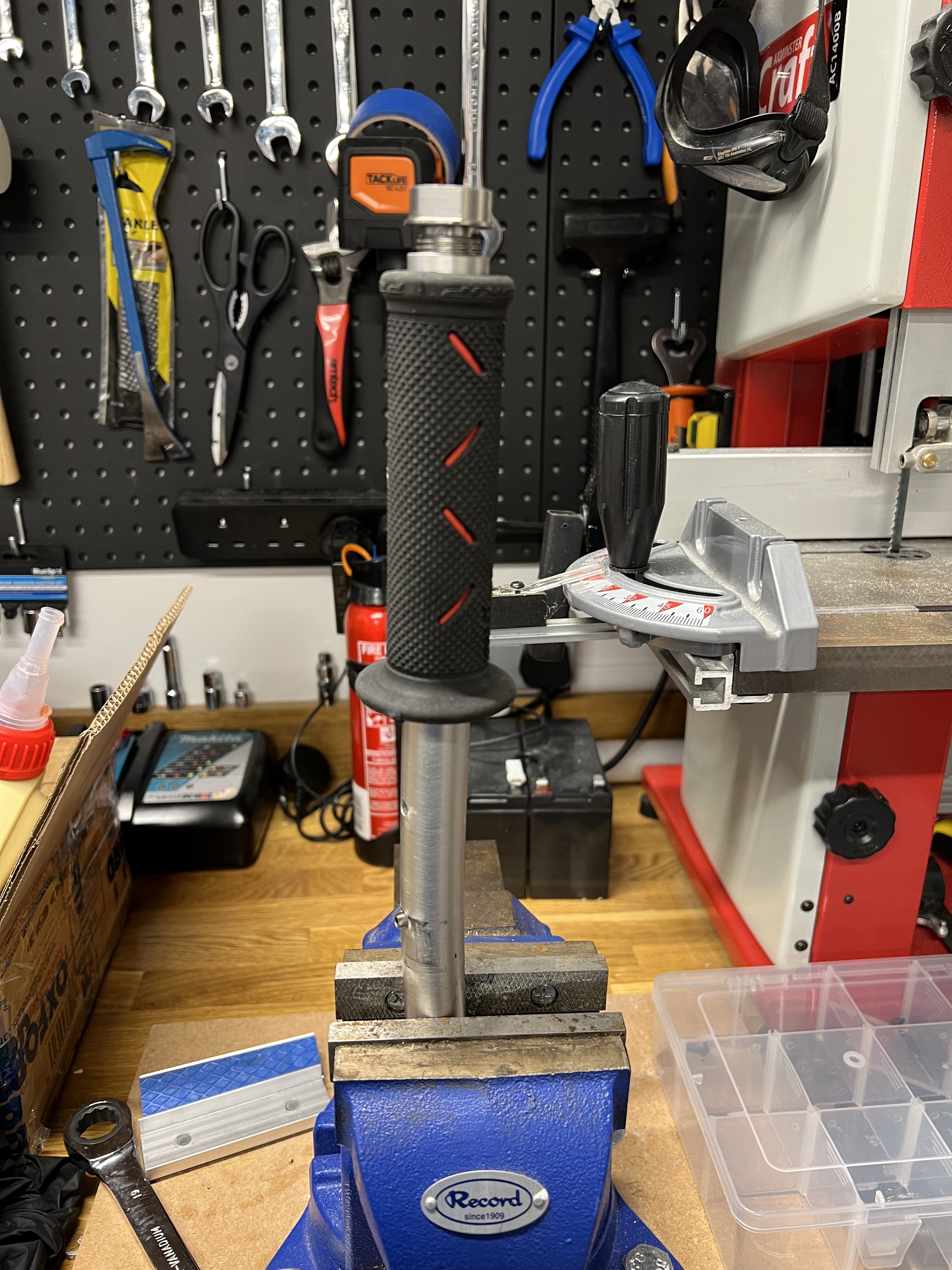

Getting the bar-end big-bolt off and some WD-40 under the grip to slide it off for re-use

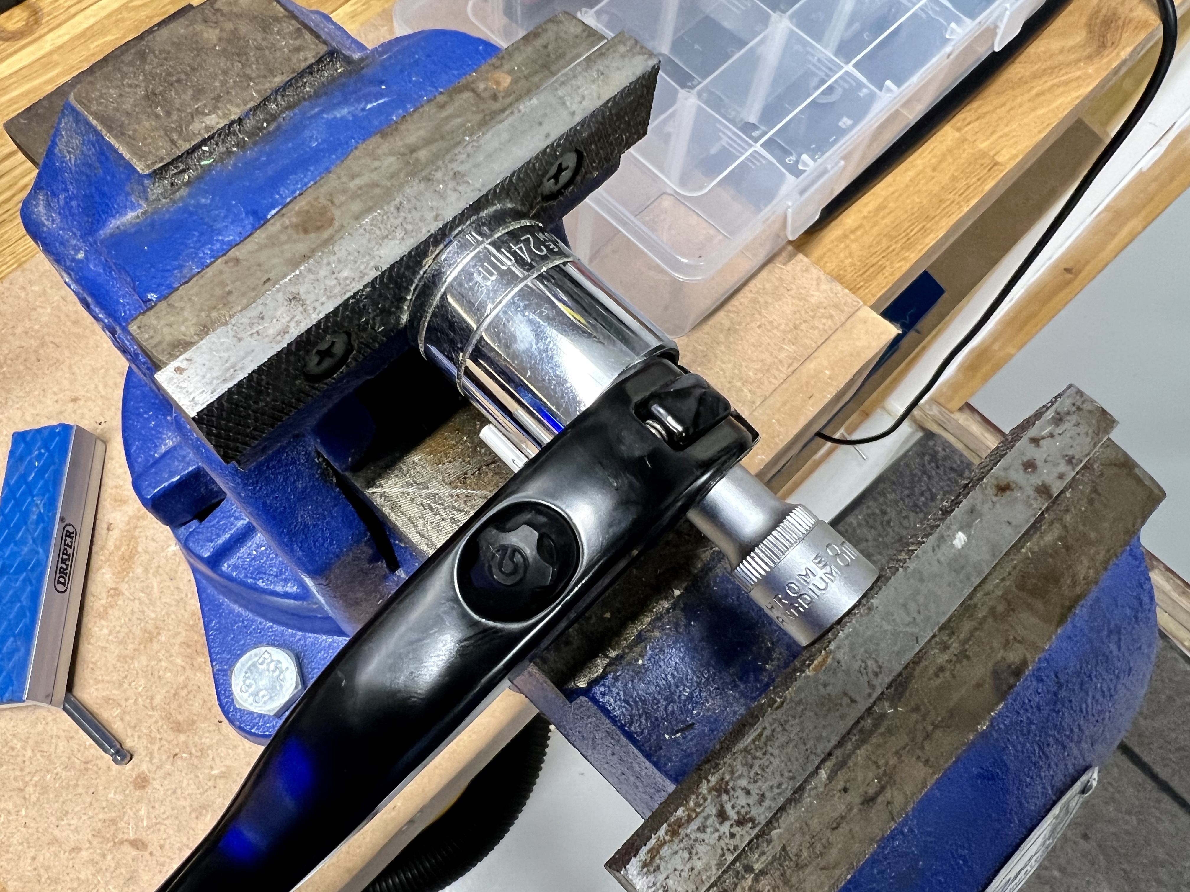

Using a couple of sockets to push the old main pin out the broken clutch lever
There it goes
New main pin lubed up and pushed into place

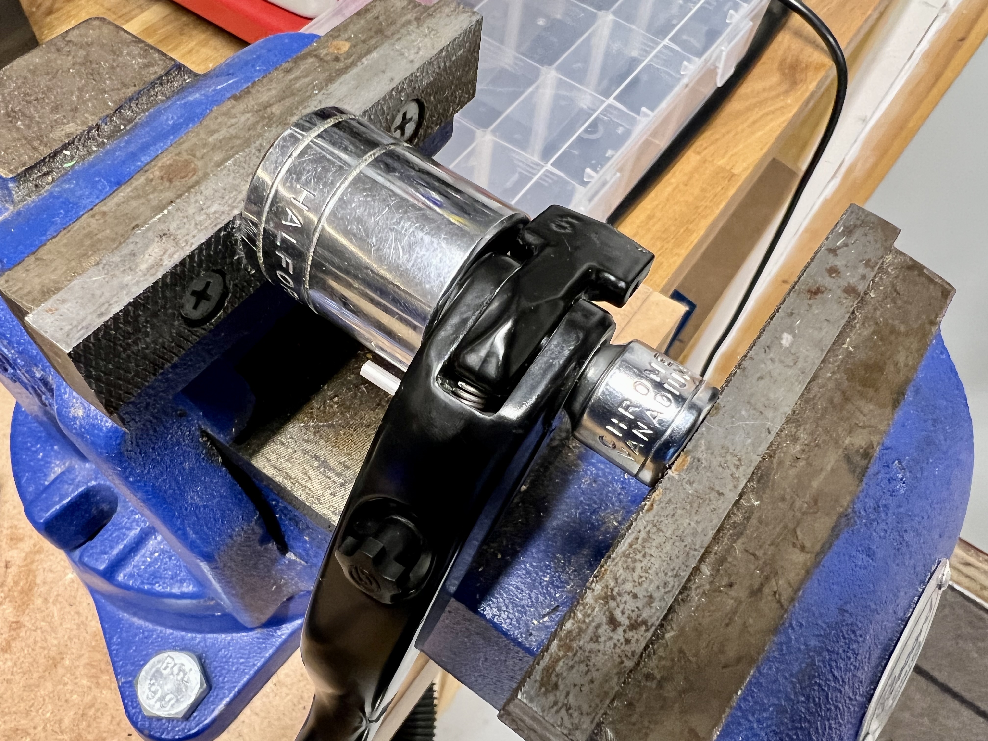

Using the vice again to push it all the way in

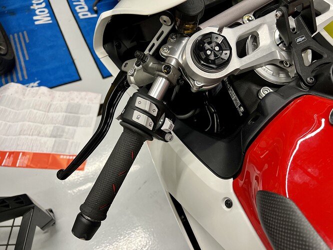

Yay, all back together.
Thread-lock used on all bolts.
Excellent use of the vice
