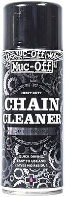

These products recommendable for cleaning chain?
Looking at this here as a cleaner:

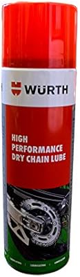

and this as a lube:
Clean chain, then apply some oil, correct?
Which oil should I use?
Haven’t really seen much when looking for ‘motorcycle chain oil’ @ amazon, pops in some 10/40, 15/50 oil etc. in a combo pack with a lube. That good enough?
Also, what’s the difference between dry and wet chain lube?

Paraffin is your friend;)
Clean it with some of that chain cleaner, or paraffin yes, or wd40 (shoot me) - I’d recommend a Kettenmax chain cleaner as it’s like 15 toothbrushes and delivers/catches (most of) the cleaner nice and neatly.

Then dry the chain, apply lube. Forget about oil if you’re using lube, some old schoolers will lube a chain with oil but technology has moved on to stuff that is dry, doesn’t come off and lubricates just as well. That wurth dry chain spray comes highly recommended to me, it’s what I’ll buy when my current stuff runs out.

I clean the chain using white spirit. Assuming that the O/X rings aren’t a fanciful material, and are plain nitrile, then white spirit or any paraffinic oils are perfect to use.

so the dry lube as I understand replaces the oil, no oil needed after cleaning, only this stuff, right?

paraffin
paraffin (to clean) is yr best bet i got mine from b and q about 7 quid for half a gallon how long that will last outweighs 8 quid a time for muc off(fuc off its shite) just dampen a rag over and clean yr chain and a small paint brush to dab and poke inside the chain being careful not to get any on the tyres of course

Another vote for paraffin. Cheap and does as the job good, if not better as anything else.
K, am split now between Paraffin and that Kettenmax thingy.
I don’t suppose I can use the Paraffin in that Kettenmax?
What about that Lube in my first post, can that be combined with that Kettenmax?
Yes and yes
brilliant, cheers.
And just to clarify for me noob muppet here, the paraffin to clean, the lube to lube it, and with that type of lube no oil needed as I read here, right? :slight_smile:
Yep. Probably a cloth to dry the chain in between cleaning and lubing too.
Cheers :slight_smile:
