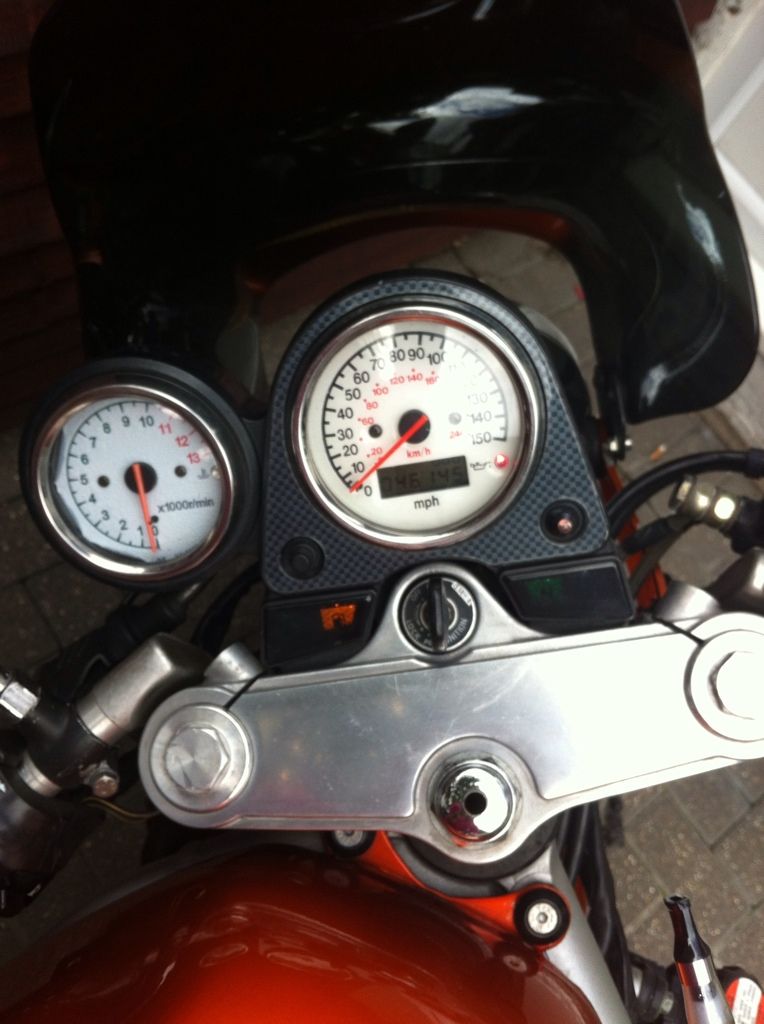

Can you take a pic of the clocks?
I cant open that link for some reason.
But these are my clocks!

Has anyone else got/owned this shape SV??? That clock face does not look right, it may be worth following the cable from the speed sensor and see if you can locate a speed converter! (common on the imports to put a converter on rather then changing the clocks!)
Other then that, if the speed is inaccurate then it may just be a faulty sensor - loads on fleabay!
I reckon that those are after-market.
The speedo is in miles but the bike remembers kilometers and is showing that on the display?
IIRC, analogue clocks remember mileage in the clock mechanism, digital ones like this remember it elsewhere? a change of clocks is essentially just a change of screen?
I’m not sure if thats how it works but if it is, your bike could be in kilometers and your clock’s speedo is in MPH. I think the screen holds no data and just displays it from somewhere else?
Thats the only way I can think of your 10 mile per day recording as over that AND the clocks being in MPH…
Definitely the wrong clocks for a carby SV.
