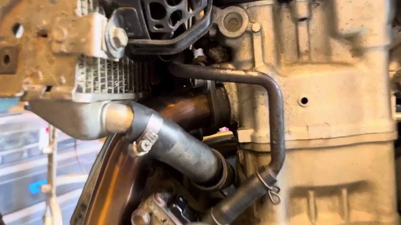

She’s in the garage now, for the exhaust manifold fix. Worked out after fitting the aftermarket exhaust, that it did in fact need an o-ring between the exhaust port and the exhaust header, despite it not mentioning this at all. Got one from eBay.
Need more room to work on the exhaust manifold. Taking the left radiator off. This has seen better days. Will try and clean up/improve later.
Drained the coolant. It had dirt in it. Need to work out how to flush it. Don’t want crap in the system.

Exhaust manifold was blowing. Turns out the standard cooper o-ring was missing. Put one in and tried to use new OEM header bolts but they didn’t seem to want to go in, so found some aluminium bolts I had laying around and they fit perfectly. Hopefully I won’t regret this. I do prefer to replace with original or performance parts where possible.
Will check soon to see if it’s cured the blowing. Can probably do without the washers now after finding shorter bolts in my bolt drawer.
Did want to remove that emissions management pipe thing in the way of the header to get better access, but for the love of me, I could not find what hex bolt it needed. 4, 4.5 and 5mm would not fit. Bizarre. As usual, Suzuki documentation doesn’t say what it is.
OEM header bolts
The left radiator is in worst shape than I thought. It’s taken a hit at some point and been dented. The fan was actually touching the radiator in places, so I heated up some bent tabs and got it back into alignment. one bolt hole is unusable though, but that doesn’t seem to affect things.
Manifold seems fixed. Not blowing anymore. Yay.
