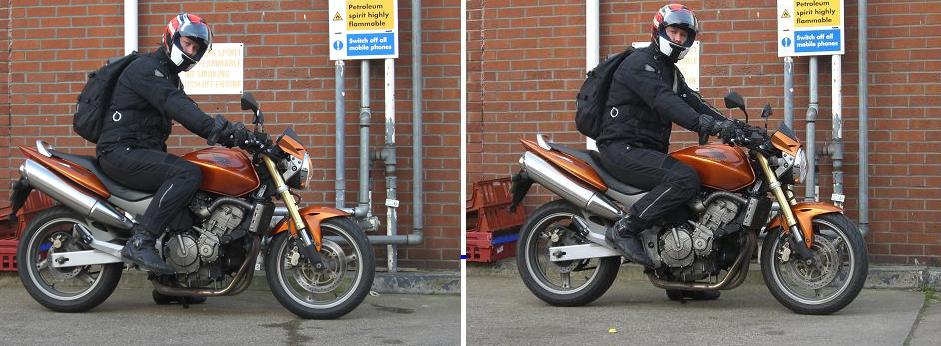

took another pic this time at max (one is at max-2) and cant see much difference :ermm:
Have you set the static sag on the bike ?
Preload is basically putting tension on the spring which, contrary to popular belief doesn’t ‘harden’ anything up, but it does raise the ride height.
