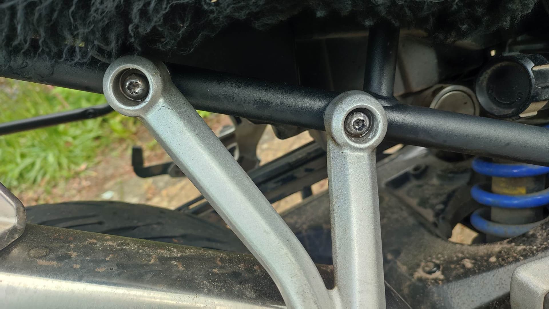

Installing new panniers on the Tiger, need to take the passenger peg hangers off. Left side no issue, right side has resulted in a sheared torx bit, a pulled muscle and much swearing and they’re still not out

Unfortunately heat didn’t help. Stopped short of stripping them but it’s going into the garage tomorrow instead

Well £63 lighter they’re out. Now to order some replacements, although there’s no way I’m paying £7.70 each for them from Triumph!

Unfortunately one of those wouldn’t have helped on these, though fair dos the garage managed to get them out without drilling the heads off.
