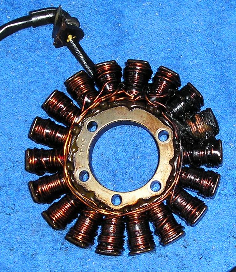

Whoops, out and about Sunday and I had to resort to a bump start :frowning:
Made it back home and found the battery had just 11.9v of charge in it, started the engine at 1200 revs no change, revved it to 5,000 no change, no charging battery remained at 11.9v :frowning:
Next test stator output to ground - short :frowning:
So the choices are West Country Windings (bad reviews lately), M&P, Wemoto don’t list a 2006 CBF 1000A, any other suggestions or recommendations?

I’m leaning towards M&P at £97.99 including delivery http://www.ebay.co.uk/itm/Honda-CBF1000-2008-Replacement-Replica-Generator-Stator-/131952717524?hash=item1eb8feaed4:g:hA4AAOSwLF1X6qoY that is for a 2008 I’m sure the 2006 is the same pattern, I’ll give them a ring to be sure to be sure.
Failing M&P the Electrex World stator http://www.electrexworld.co.uk/cgi-bin/sh000001.pl?WD=cbf1000&PN=G112%2ehtml#SID=41?aG112 at £114.00
I’ve heard West Country Windings http://www.westcountrywindings.co.uk/services.htm will charge £150.00 for their service, I’ll give them a call all the same.
I remember following Scorch’s exploits rewinding his Triumph’s stator. From memory he did the job twice. The first ‘practice run’ he needed to improve on the winding technique, the second winding although successful proved to be a labour of love due to the time involved. If only I had the patience to follow his example and do it myself.
Ordered from M&P at £95.99 http://www.mandp.co.uk/honda-cbf1000-06-12-generator-stator-electrosport.html

Sorted - 12.9v at the battery, 13.5v on tickover, 14.1v at 3,000 revs.
