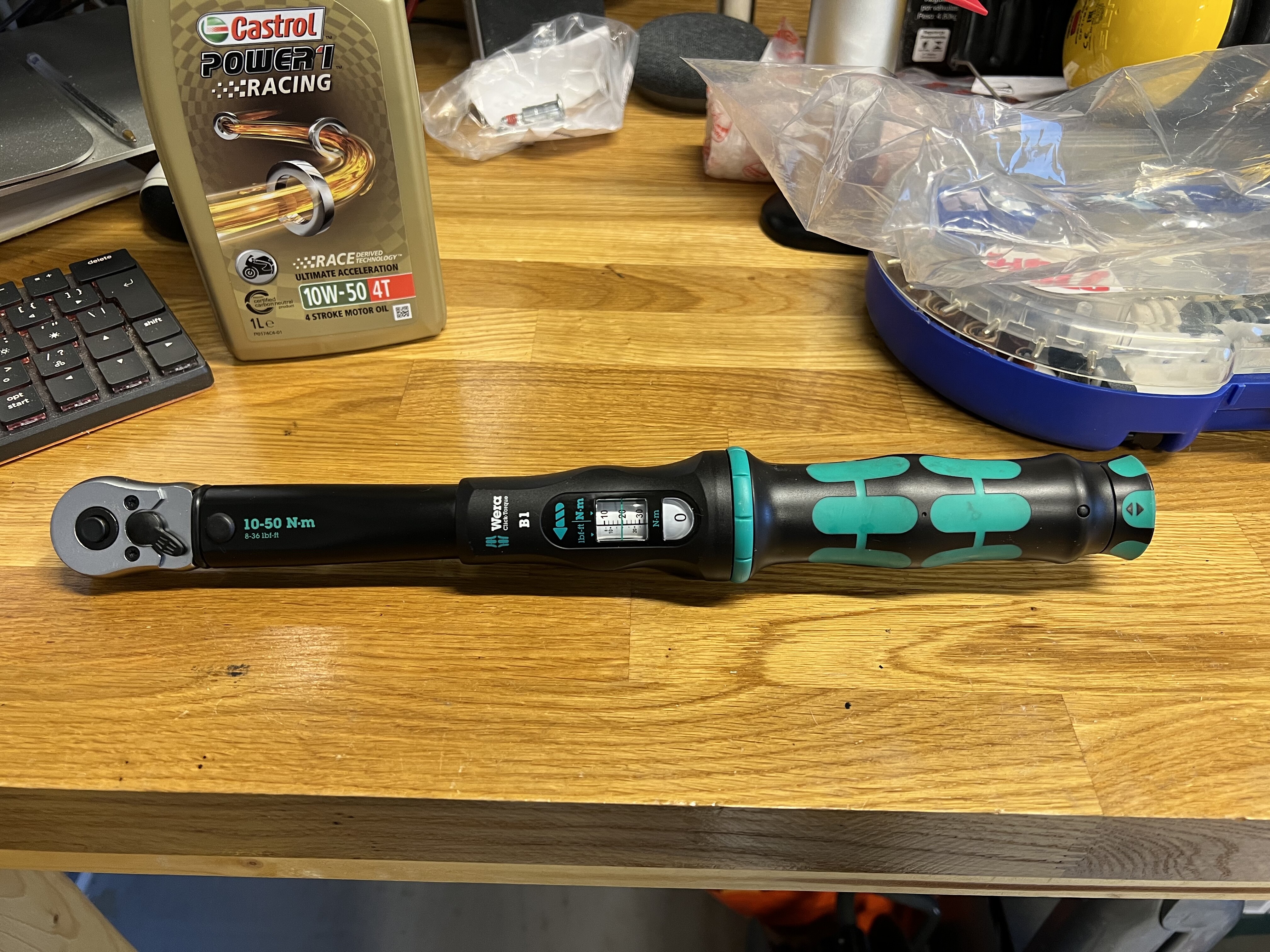

Performed an oil and filter change service on the Ducati V2 and Aprilia RS 660 today. Ready for their first trackday of the season in a couple of weeks. The Aprilia was a cinch to work on. The Ducati, not so much, heh.
Had to buy a new torque wrench for the low rating on these, and took a while to work out you need to use two bolts to push the oil filter cover off the engine block on the Ducati. That was a little frustrating.
The Ducati has a loo-roll style filter that sits in the engine. Quite cool, but nowhere near as accessible as the simple, old fashioned Aprilia method. Got the Aprilia done in no time. It needed no more than the 2700ml of oil the specs state, bonus.
The V2 specs state 3.8L of oil needed, but it took 4 before showing below the minimum level after idling the engine. I’ll take it for a tootle round the block tomorrow to see if it needs running, not idling to get an accurate reading. Hesitant to add more in, in case I end up over filling it. That said, have ordered another litre, as I’m all out.

talking of torque wrenches! I need a new one, the wife dropped mine behind our cupboard and it would be less effort and cost to get a new one…
Damn. Strong magnet on string not an option?
Maybe one of those magnet fishing magnets might work, as it is in it’s case so a normal one would probably not work :frowning_face:
This being said, mine it not remotely as posh as yours! if I’d lost one of those I’d probably have ripped th kitchen out…
