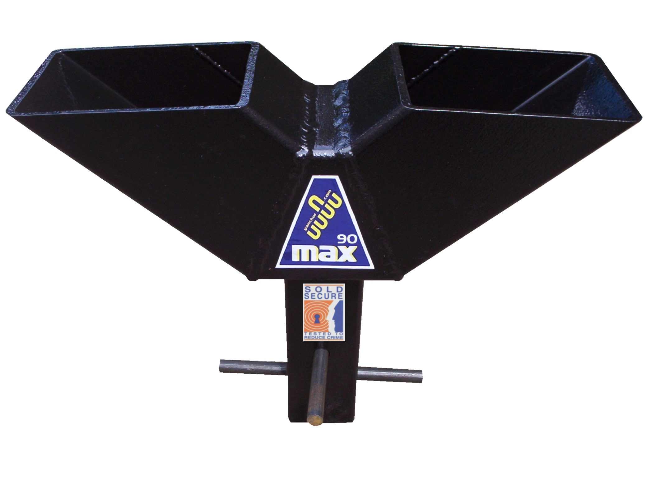

Yep self level it if was me. I’m a carpenter by trade and would rather use screed, while you at it why not dig a hole for some ground anchors if you not got any
good plan with the ground anchor. gives you somewhere to sweep all the dust into
What would the maximum depth be
The minute depth for screen is 25mm
For your talking a couple of mm you need to use a self levelling latex
