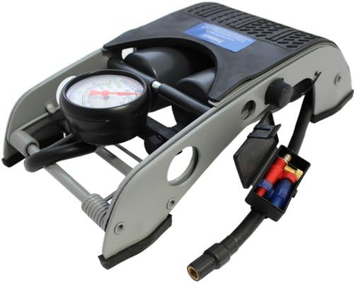

I have a collection of digital and manual gauges, all but one of which give different readings that aren’t same as my Honda dealer’s expensive machine – the most consistently accurate gauge of all is the non-digital one actually on my footpump:
