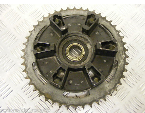

Thaks for the replies guys - here is a pic of the underside of the carrier.
looking at the constructon it doesnt look like a captive bolt - I’m guessing the thread is gone as you say which would require a helicoil repair.
However - i’ve just seen one on ebay for £12 + £7 postage so I guess that’s probably the best route - assuming it is in A1 condition.

They are all torqued up properly - apart from this last one which got to the torque bite point and then kept turning - so it is on safely - but when I come to change the sprocket in the future I am anticipating that I’m not going to be able to get the sprocket off the carrier - becuase the bolt is not fixed anymore and is turning independently of the carrier.
So the simplest solution seems to be sourcing a new carrier and have it ready for the next chain/sprockets replacement.
Go for the one on fleabay if it’s in good condition.
They look like those cwap “bolts” that have a round mushroom heads and splined shanks. It’s common for the steel bolts to strip the splines in the alloy so they just spin in the hole.

does it keep turning or turning the stud too?
Yes Oldguy - it will be easier and cheaper to get one off ebay than do a helicoil repair - there are a couple of reputable sellers who state that the part is in perfect condition.
Yes Choprocker - the stud is turning in the carrier - so the internal thread/ribbing has gone.

was thinking if stud comes out try using a bolt of same size that could slot in and not turn on the back.

or an allen bolt, does not matter if thread is stripped on the carrier, bolt can slot through hole and the bolt it on etc.

Sticking a bolt through the hole is so blindingly obvious I missed it.
Note to self: Must stop thinking like an engineer.
(The old fashioned fix was to drill a hole through the joint between the “stud” and the casting and tap in a dowel to lock one to the other. Sticking a bolt through, even if you have to drill/ream out the hole to get a snug fit, is so much easier.)
