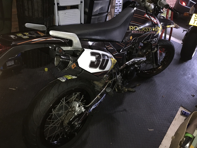

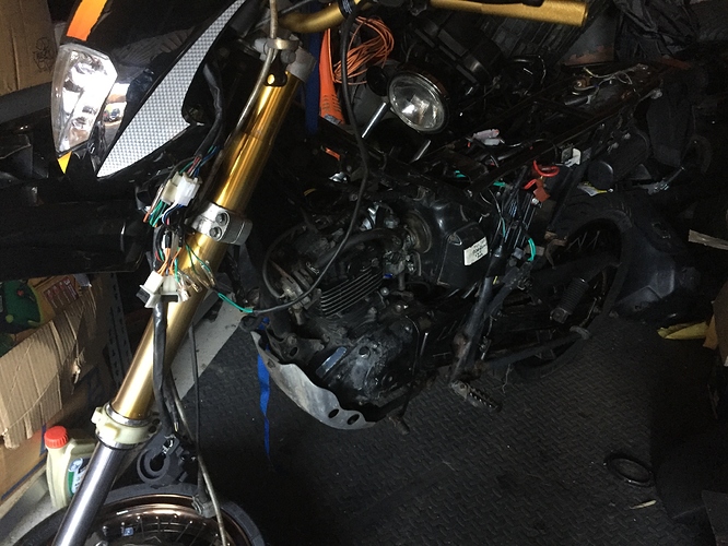

Here are the pics as it was picked up on Friday… brace yourselves!

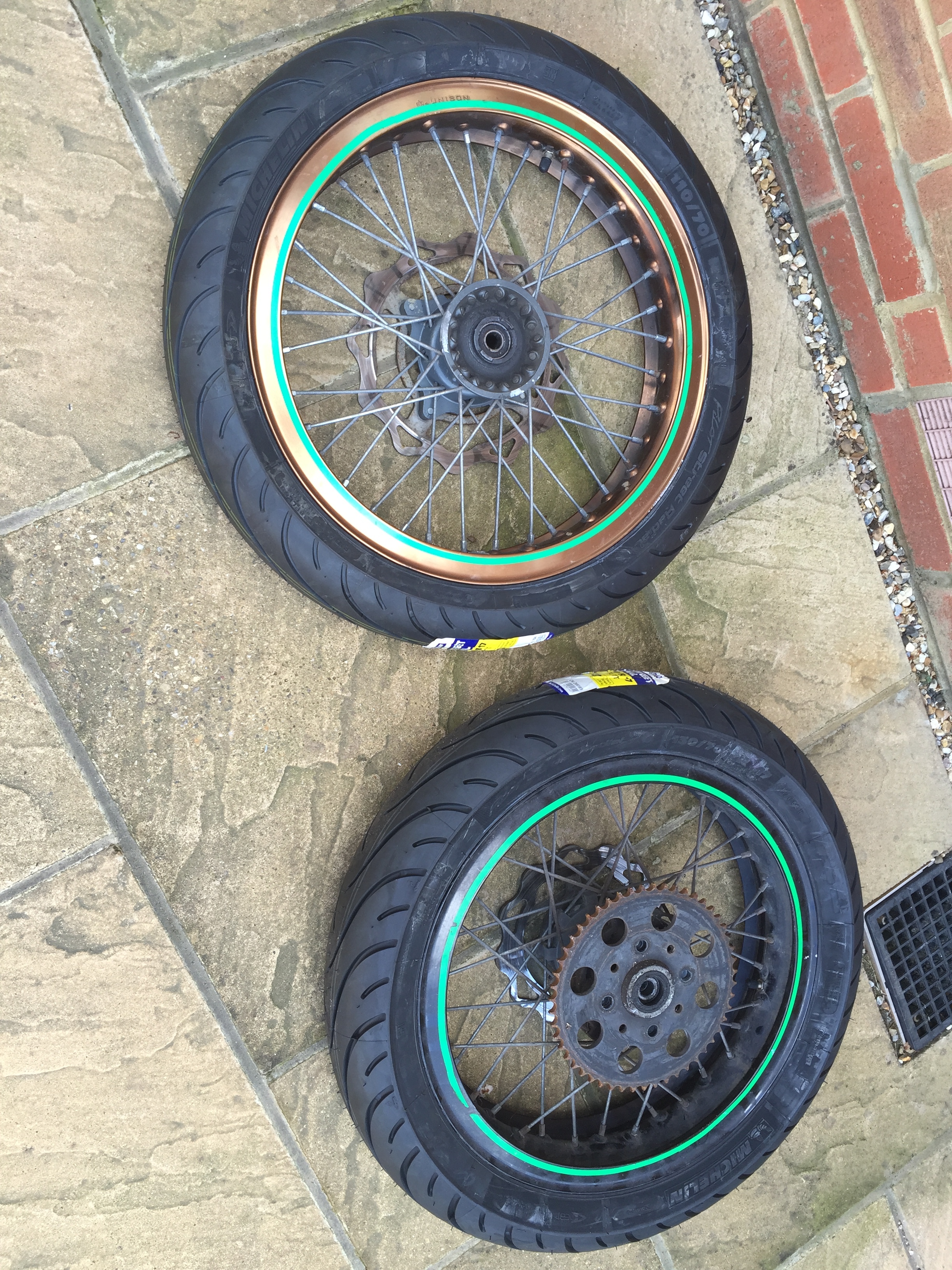

Tyres 110/70 x 17, 130/70 x 17: Neeed replacing, knackered.

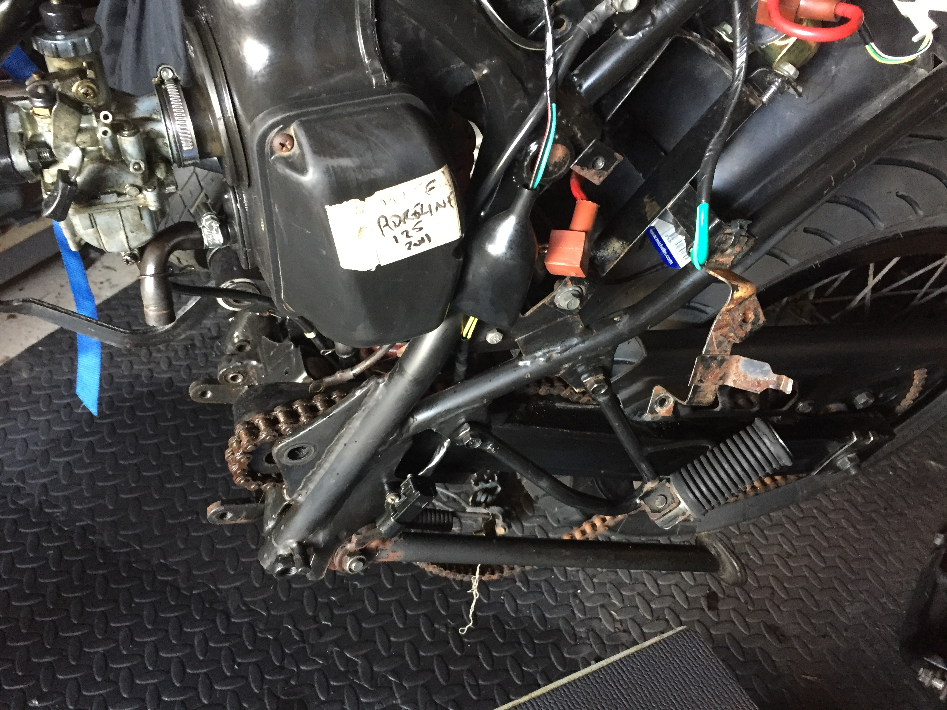

Loom: May need replacing, will check this weekend

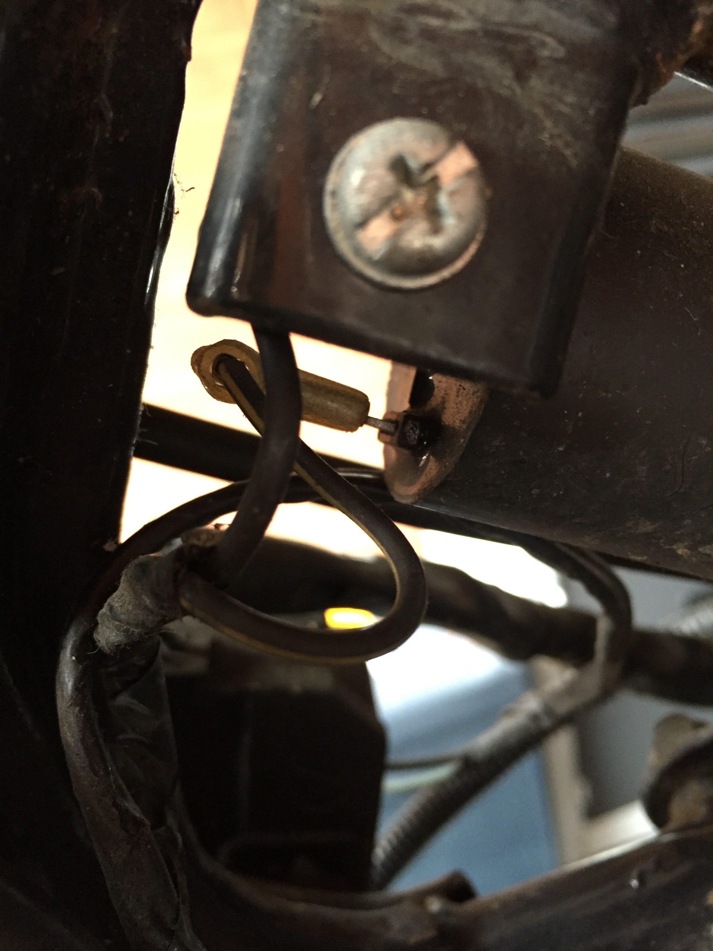

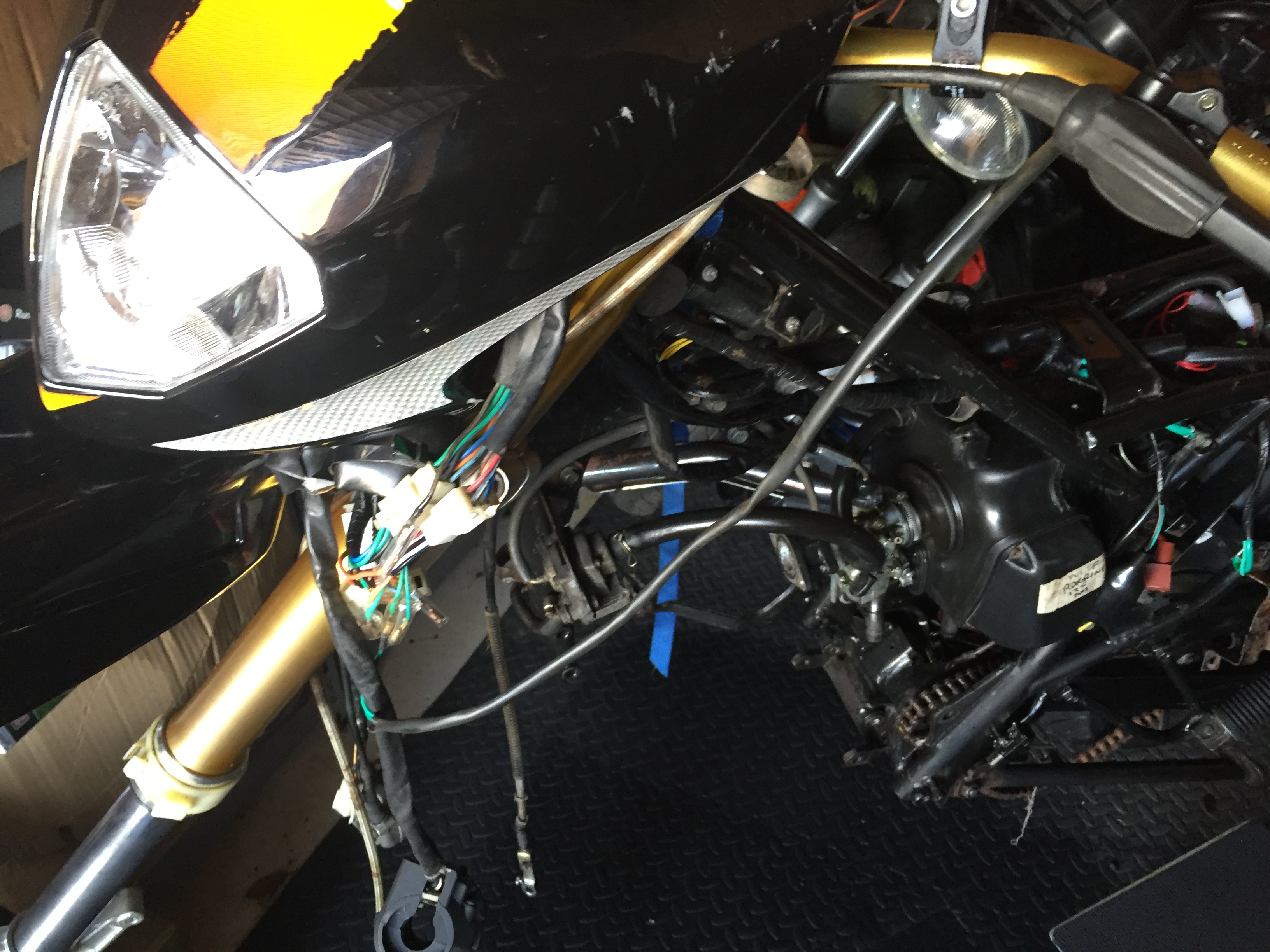

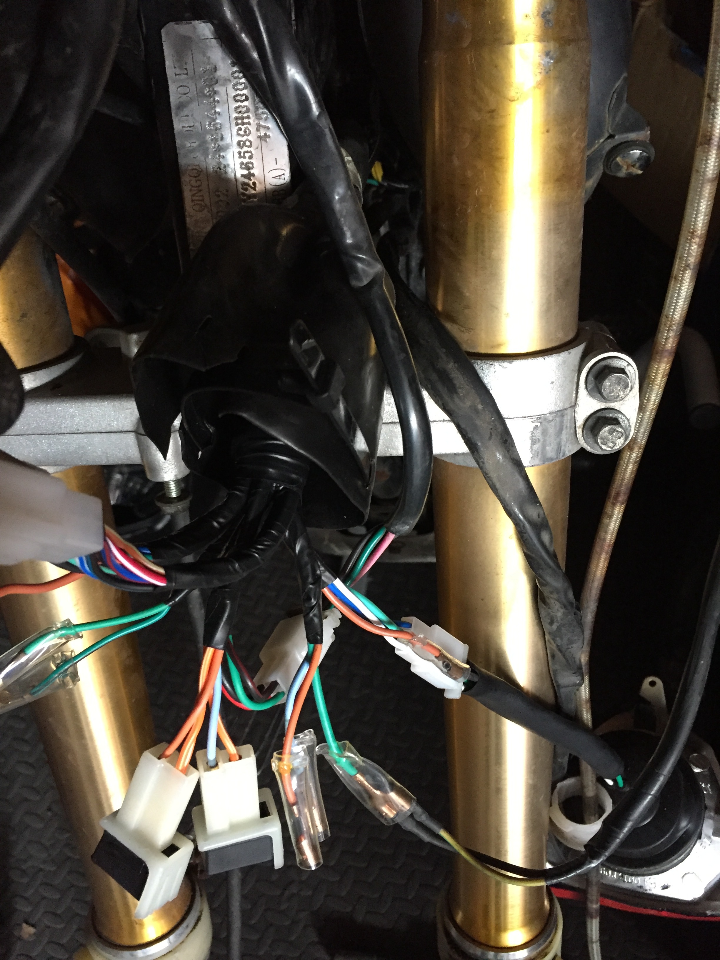

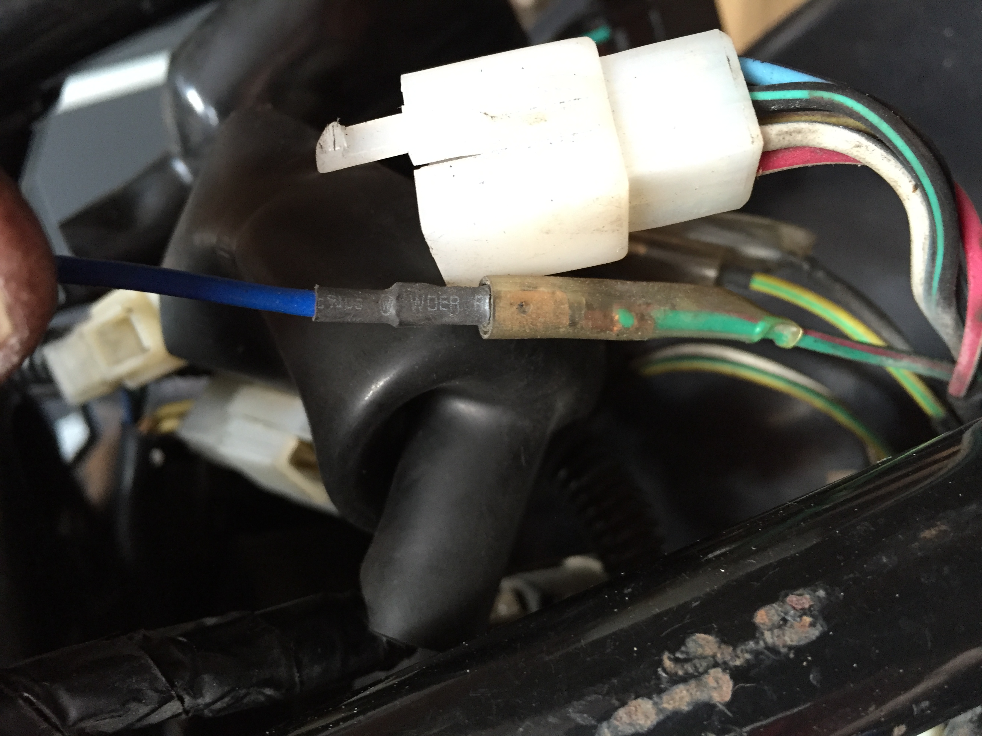

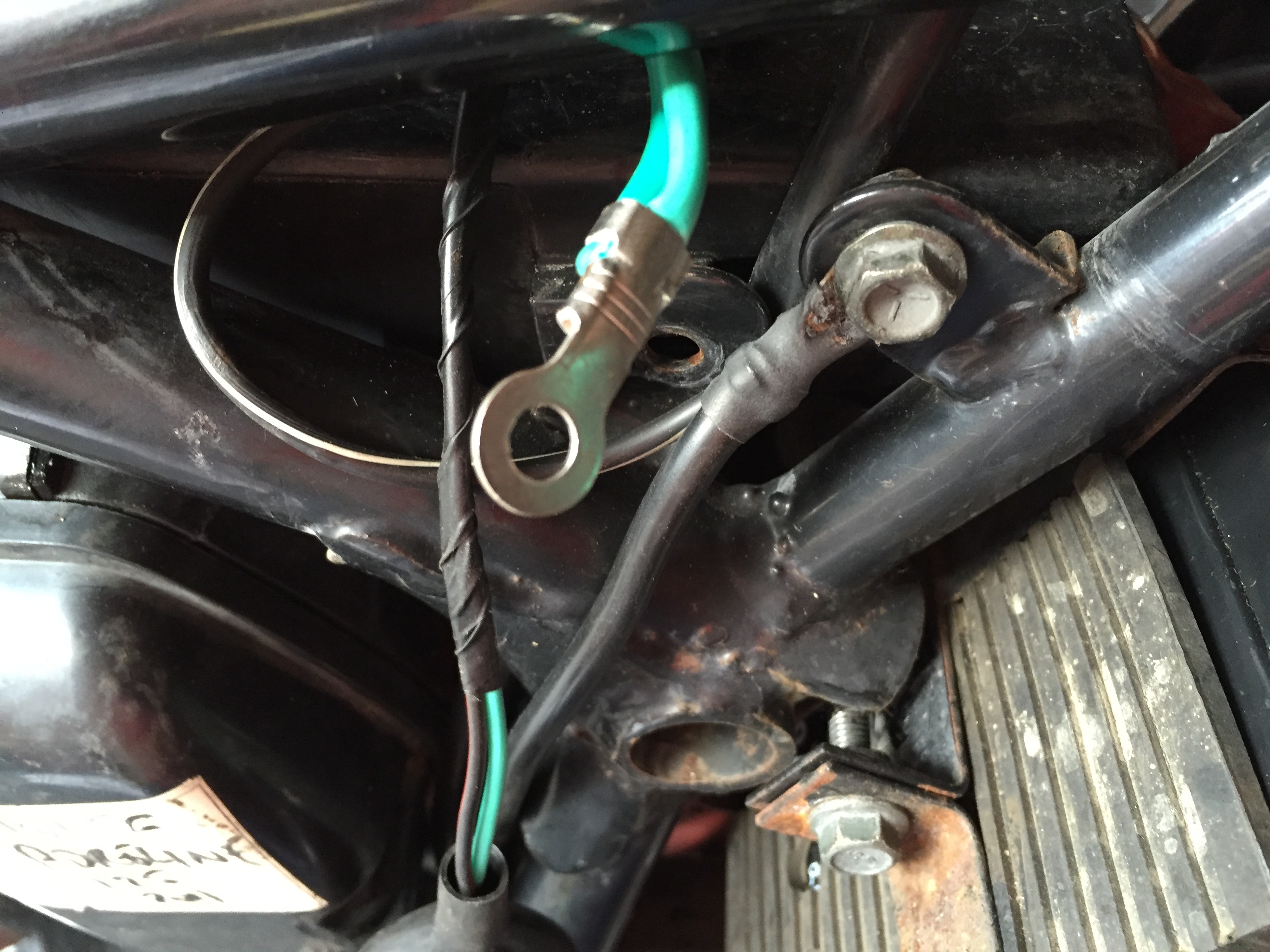

Wow, there’s a lot of bodge-jobs in there!

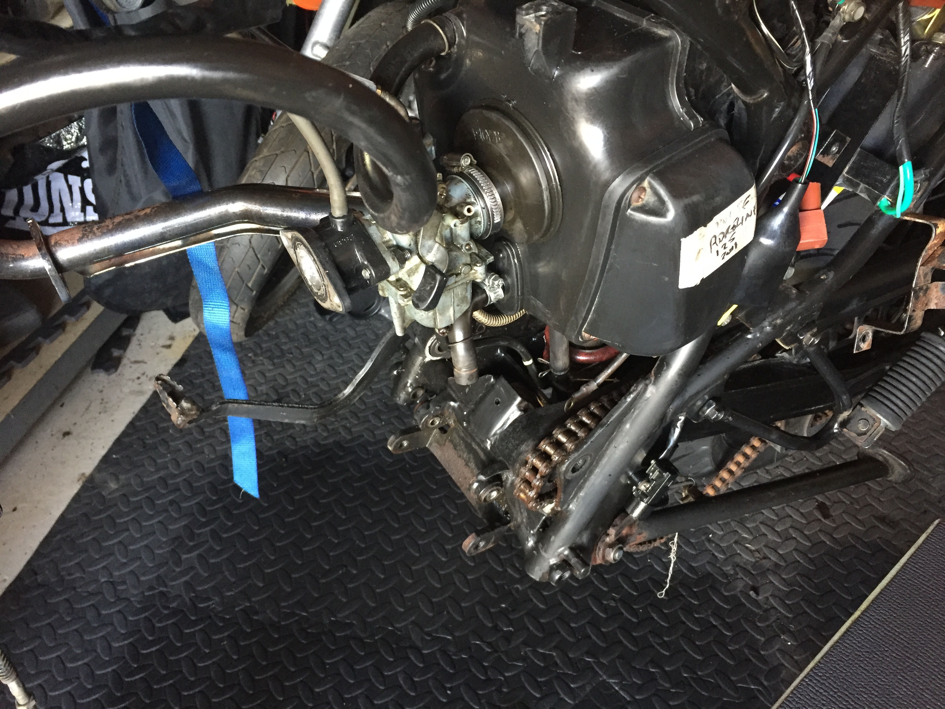

Jobs done today before rain stopped play:
Change plug
Change plug cap
Install air box (secondhand)
Install new air filter
Oil and oil filter change

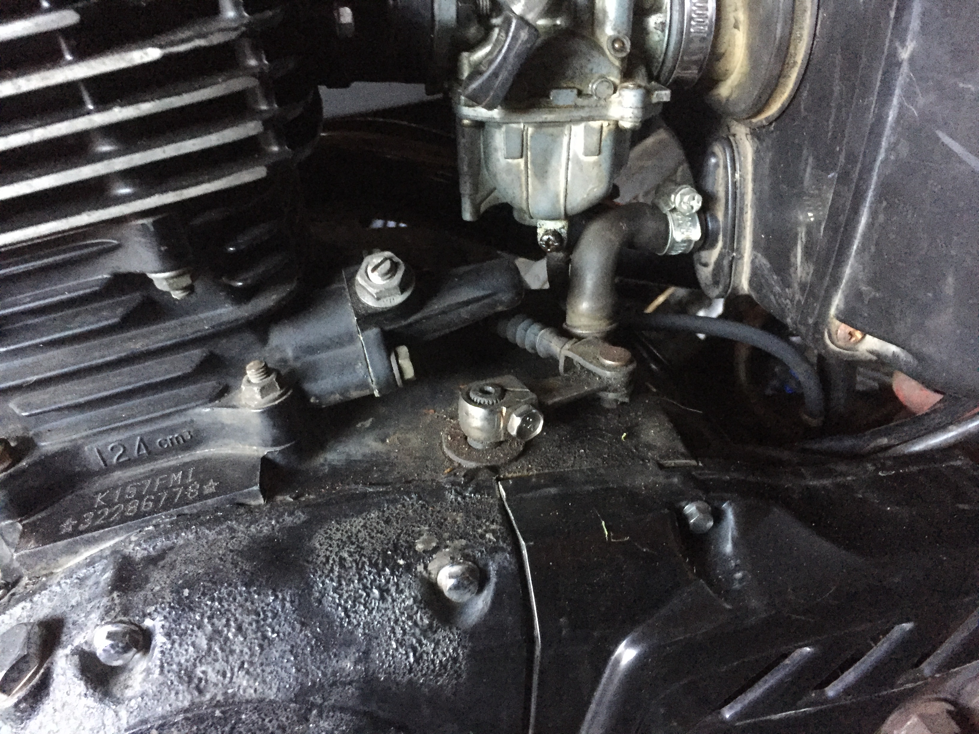

Re-jet carb back to standard
Remove previous owners bypass of the EGR valve
Had intended to get the replacement (secondhand) exhaust on and the new can, and get it started, but seized exhaust bolts are going to need drilling out. Job for next week.

  • Replaced Loom (it was so knackered and chopped up I didn't even think about using it)

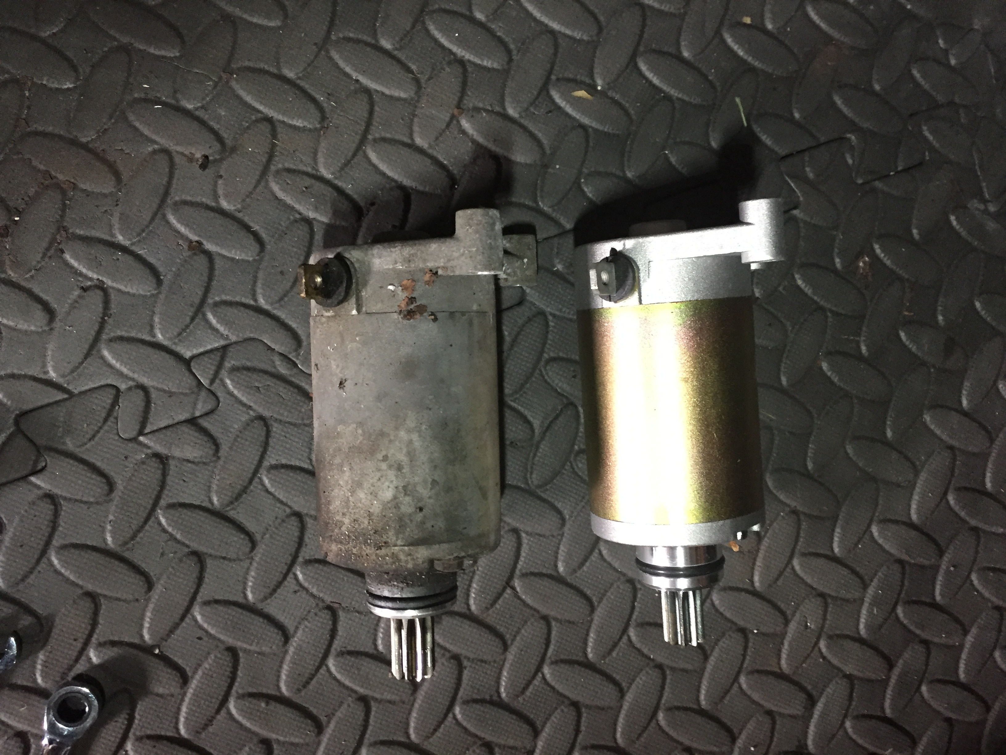

  • Replaced starter motor

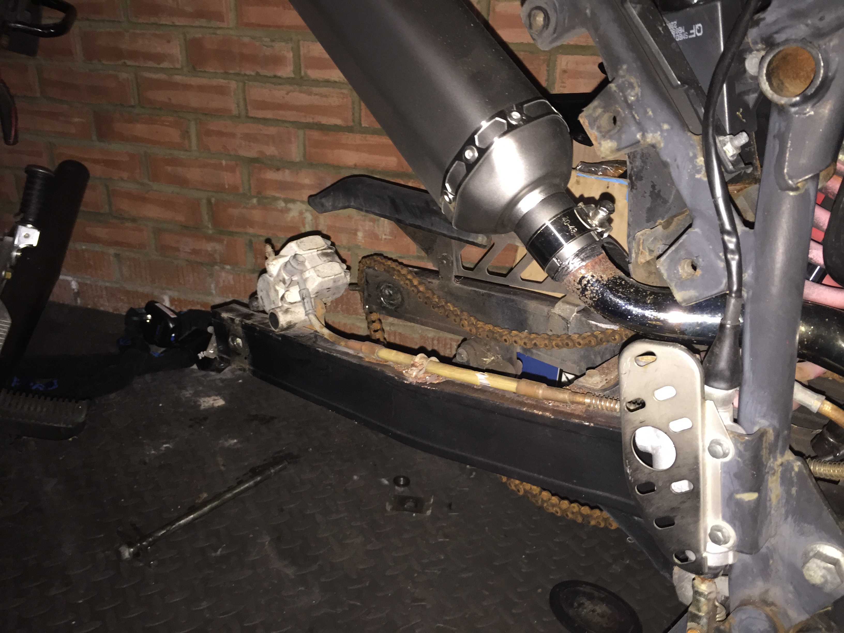

  • Replaced exhaust with a second hand downpipe and new end can
Then I tried to start it... nothing. Turned out the engine was seized. Solid. So:
  • Replaced engine

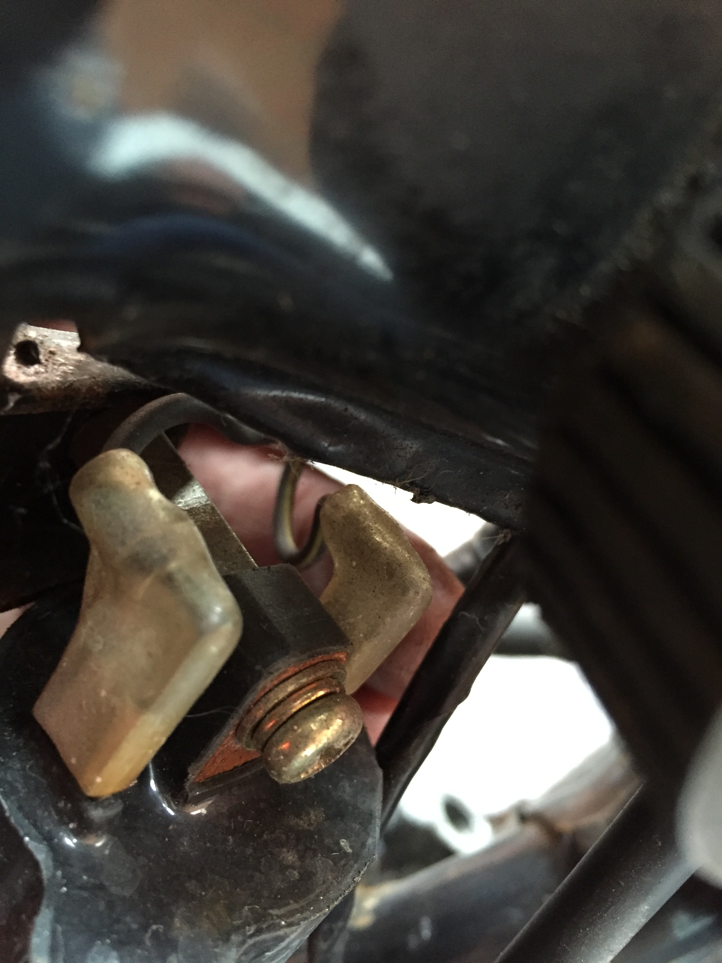

  • Replaced side stand switch
  • Replaced clutch switch

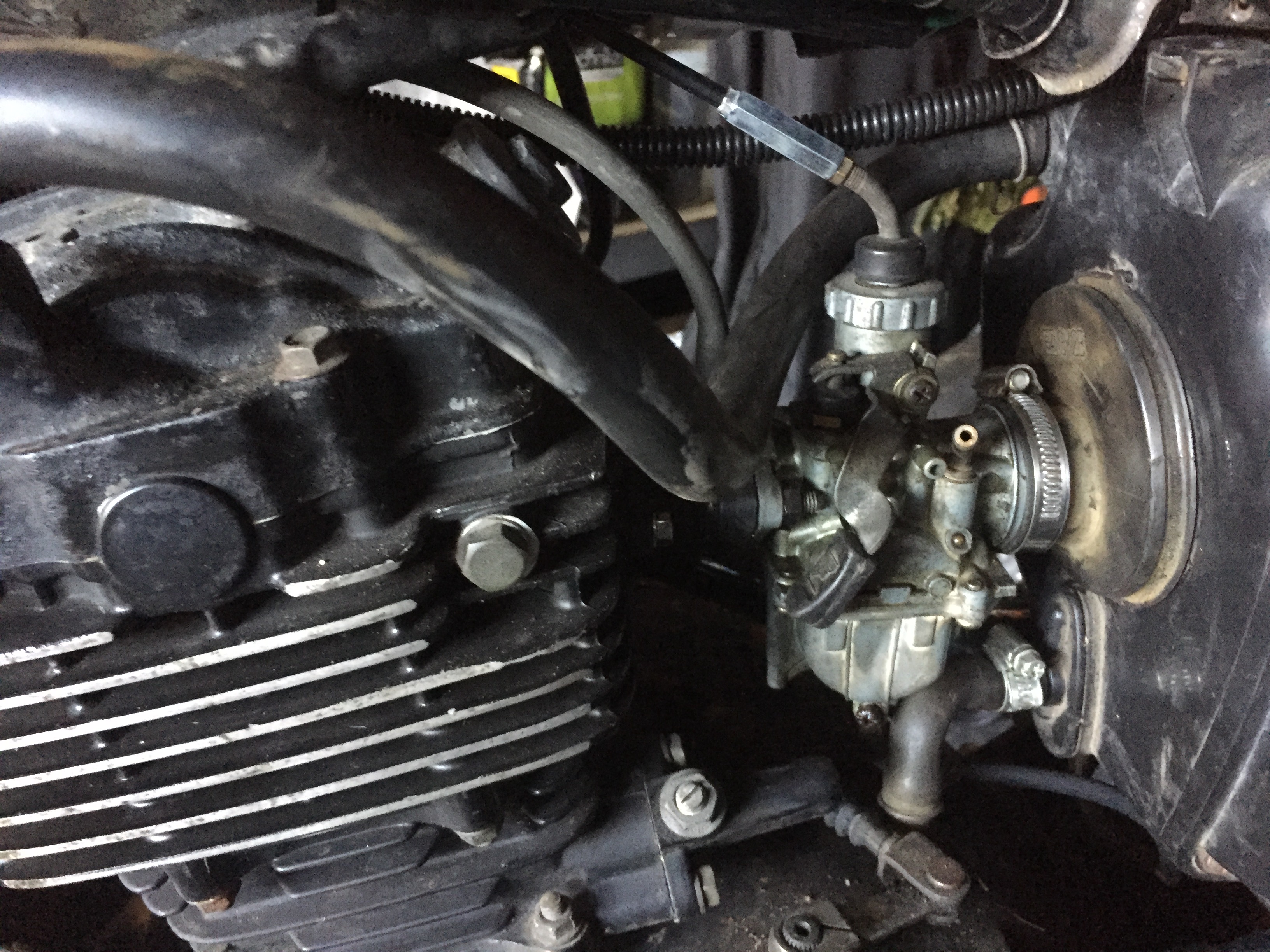

Then it started! But ran terribly. Over the years this poor thing had been utterly abused by a previous owner, so I'm not sure i totally trusted the carb set up. So:
  • New jets
  • Cleaned carb and reset air screw to standard
  • Runs properly now! So that was good. Then I set about the rest of it:

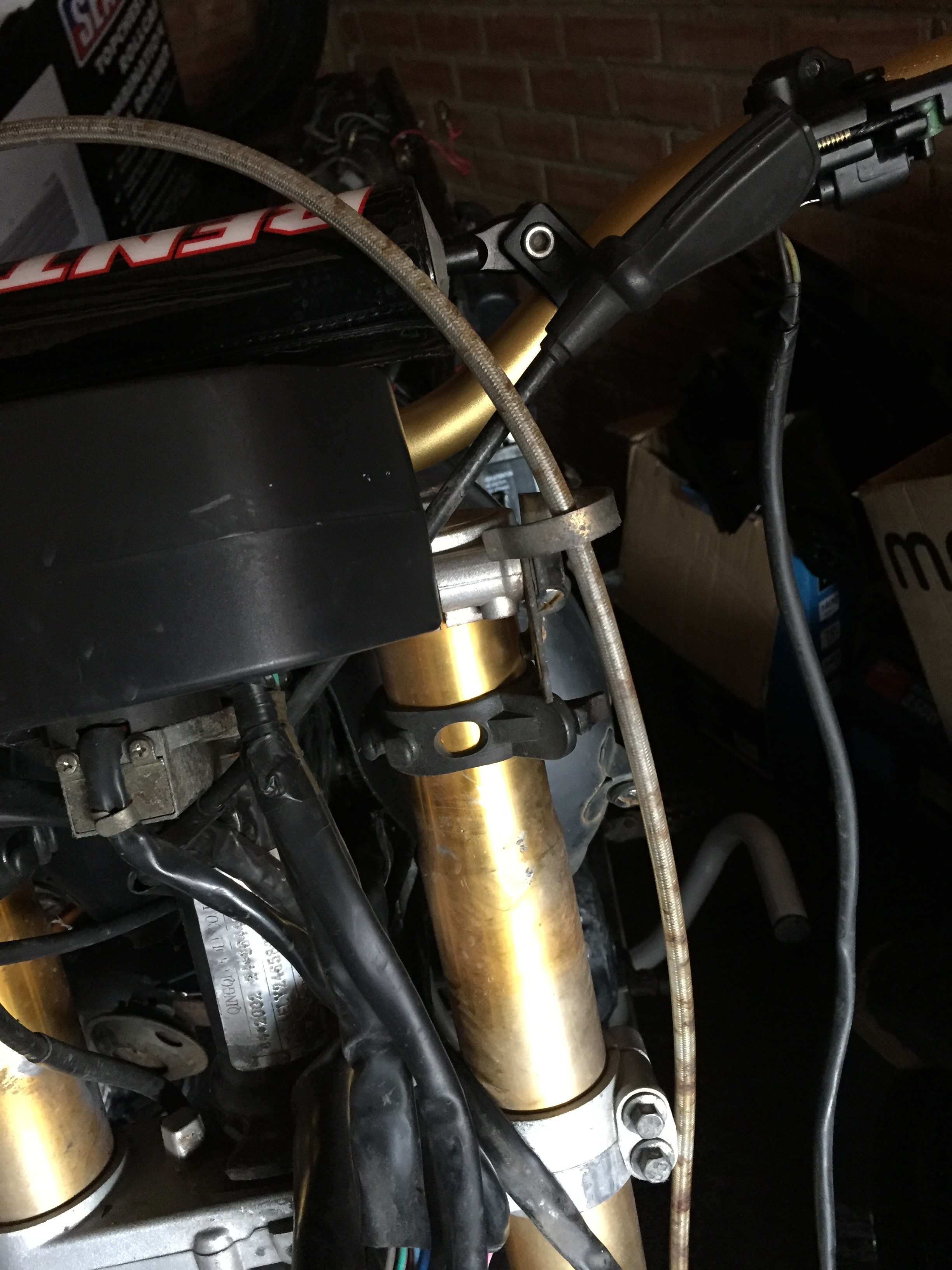

  • New bars (Renthal gold ones, fancy)
  • New levers
  • New throttle tube
  • New throttle cable
  • New clutch cable
  • New levers

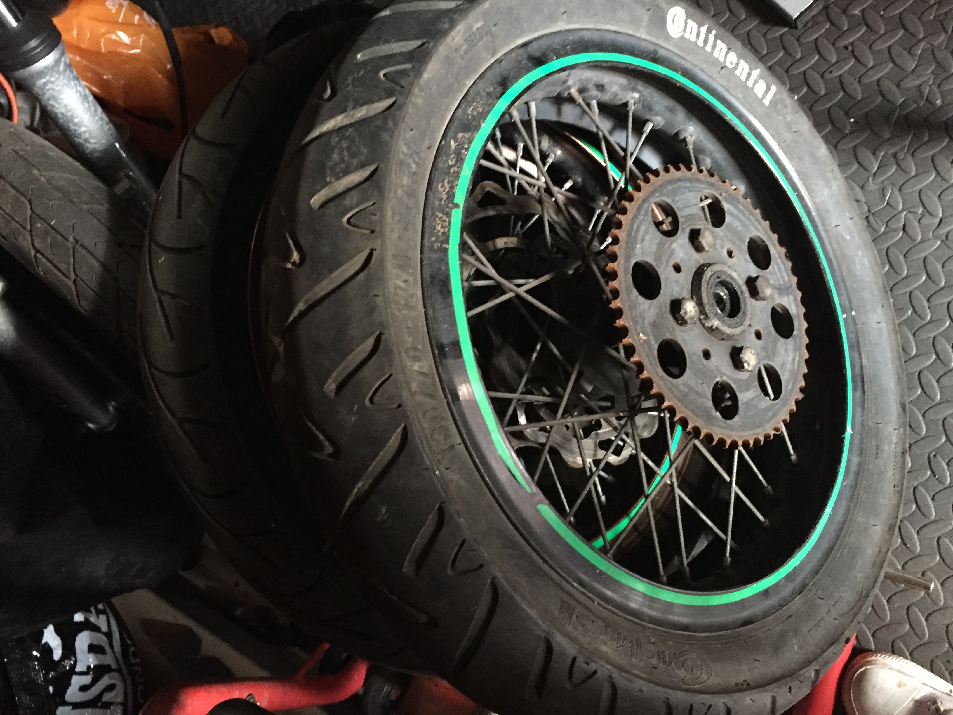

  • New wheel bearings
  • Cleaned up and checked all spokes

  • New chain
  • New sprockets

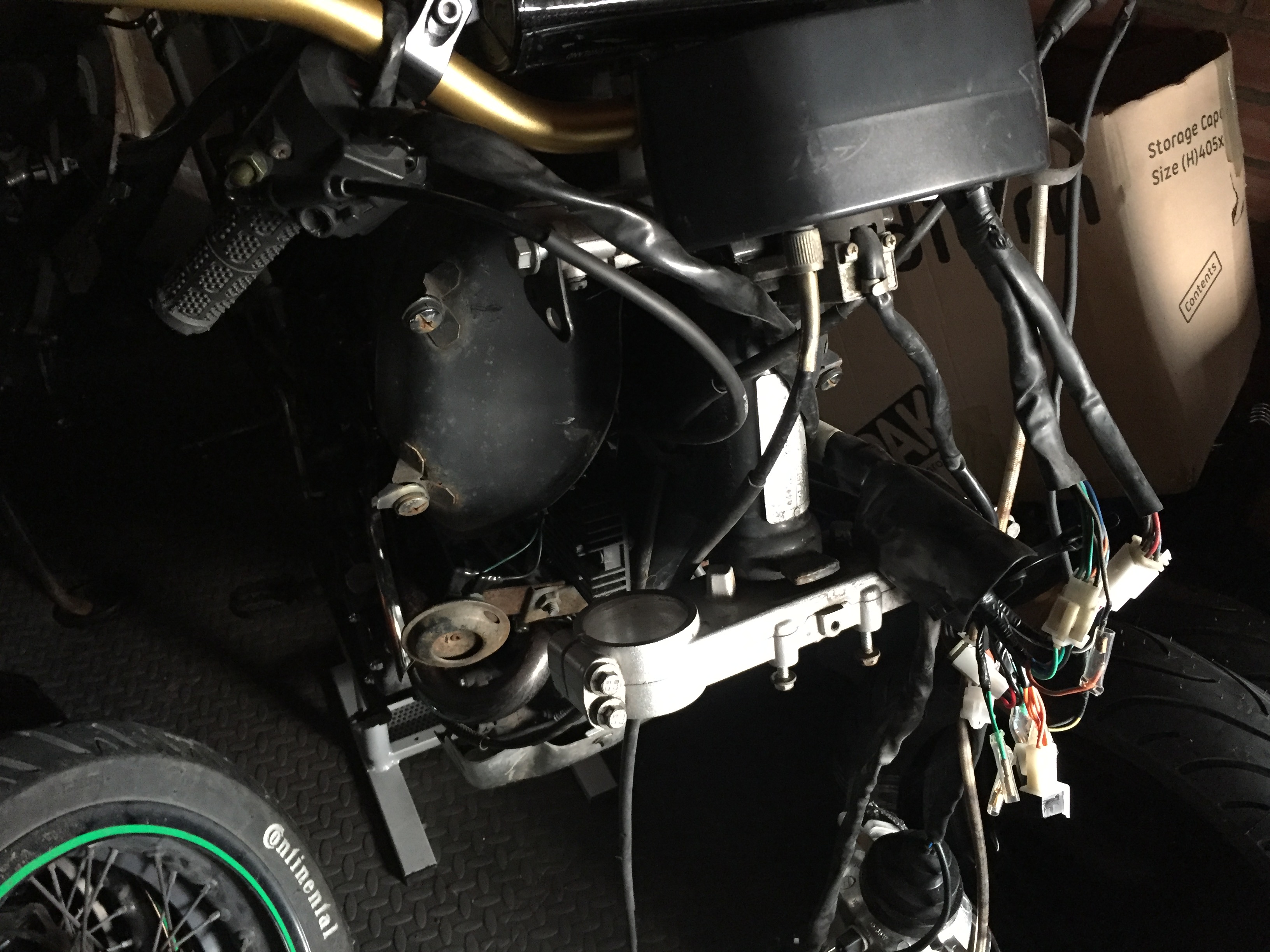

  • Rebuilt forks with new bushes, seals and oil
  • Check and regressed head bearings and swingarm bearings

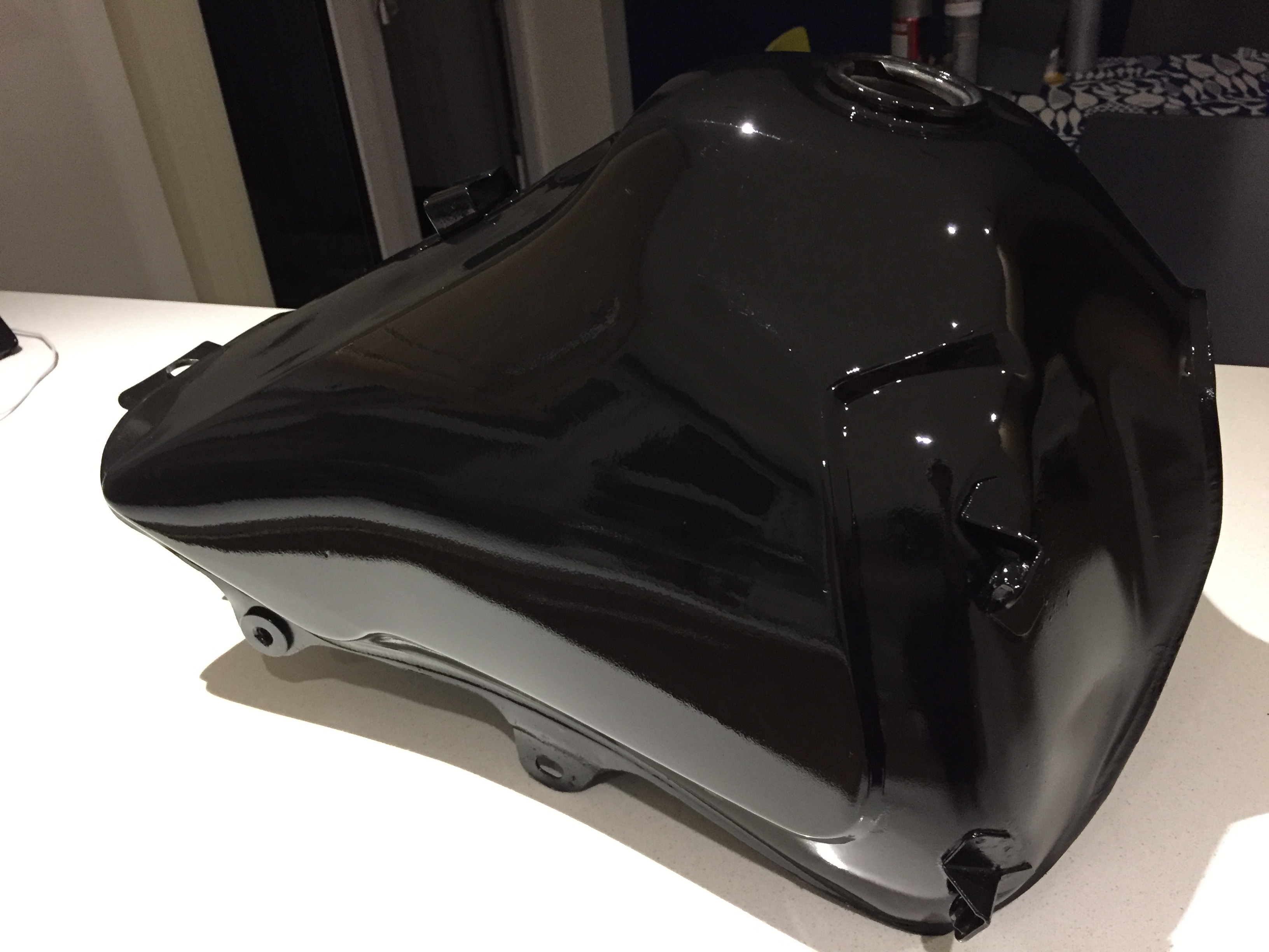

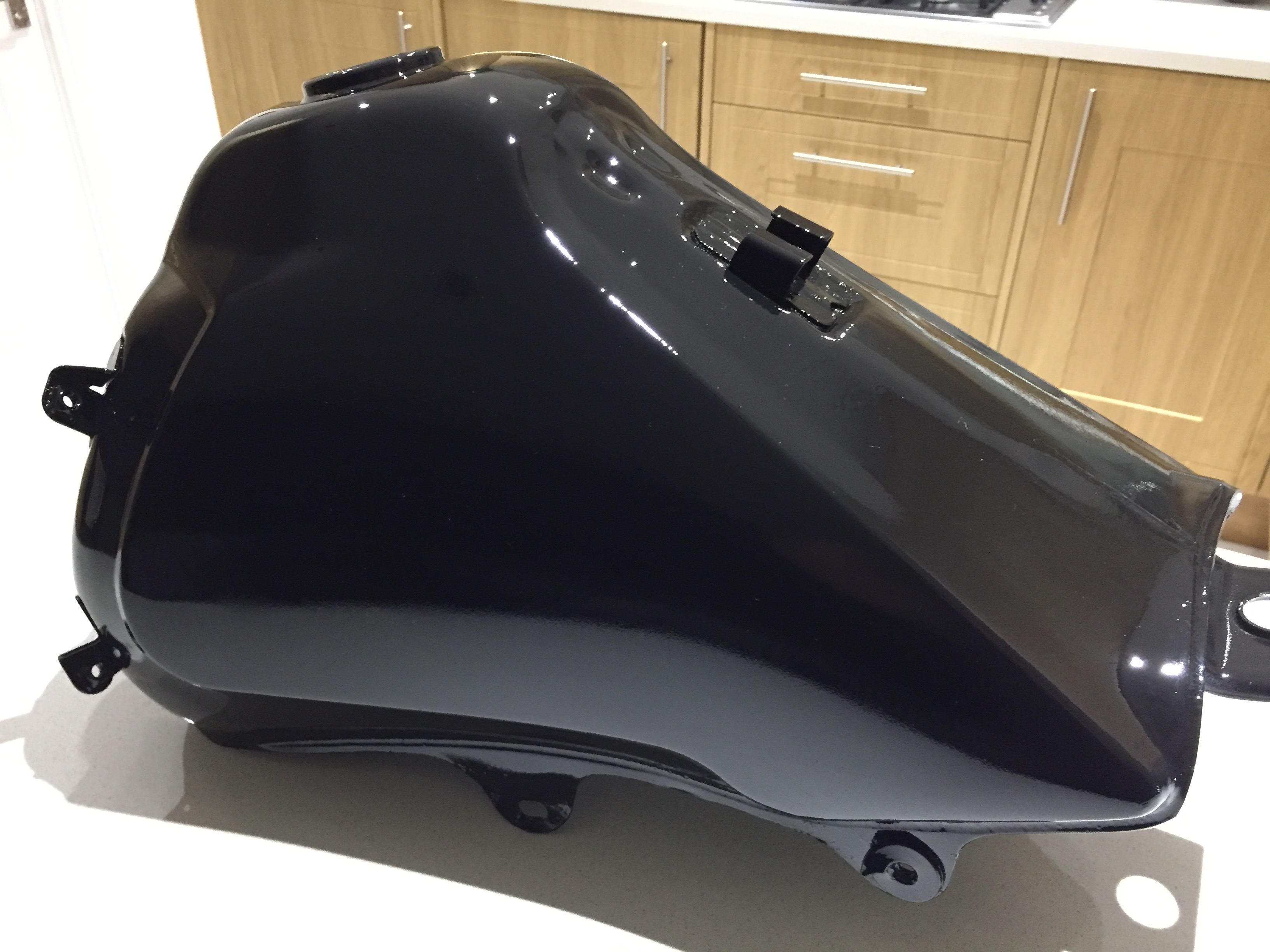

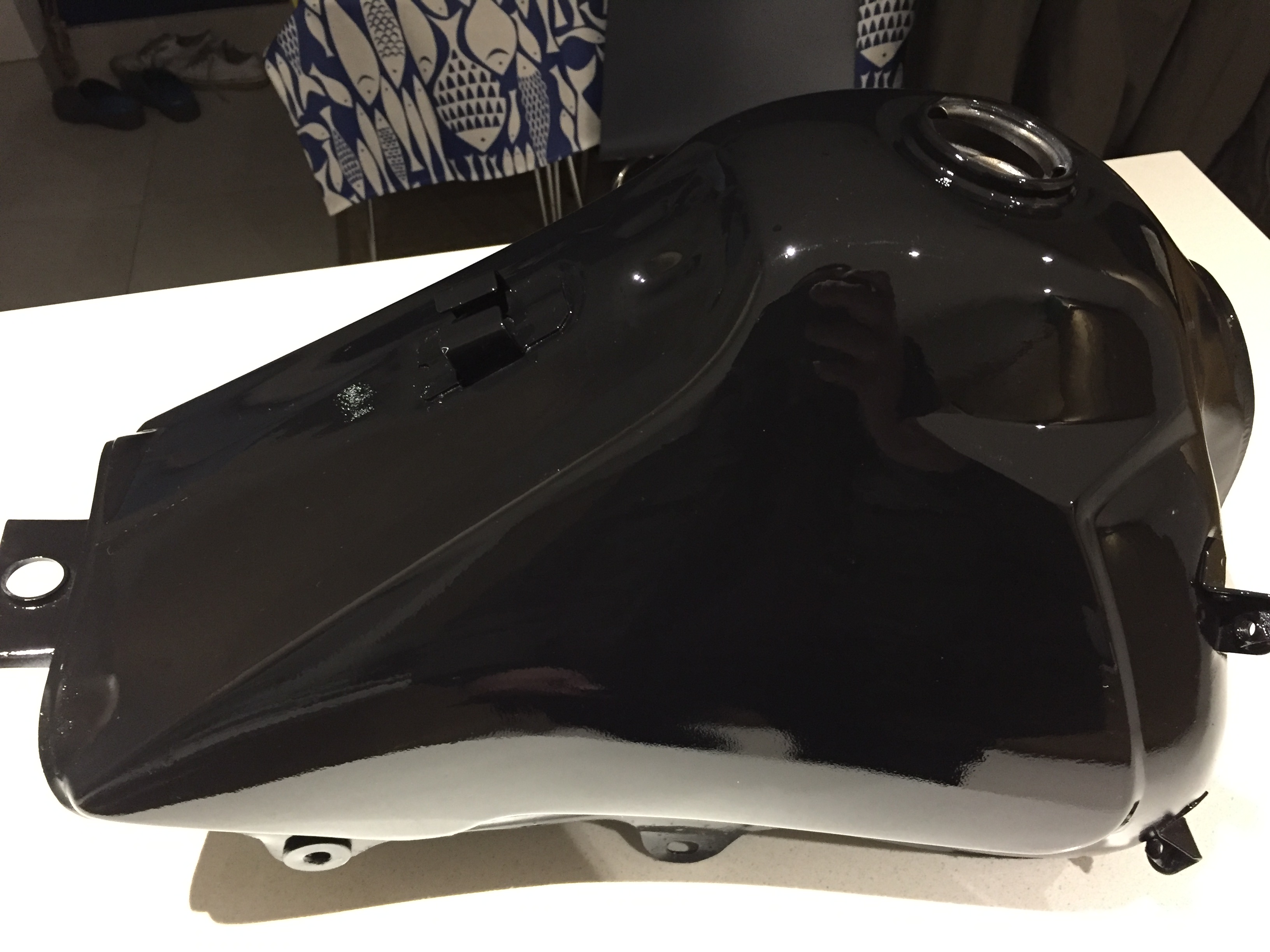

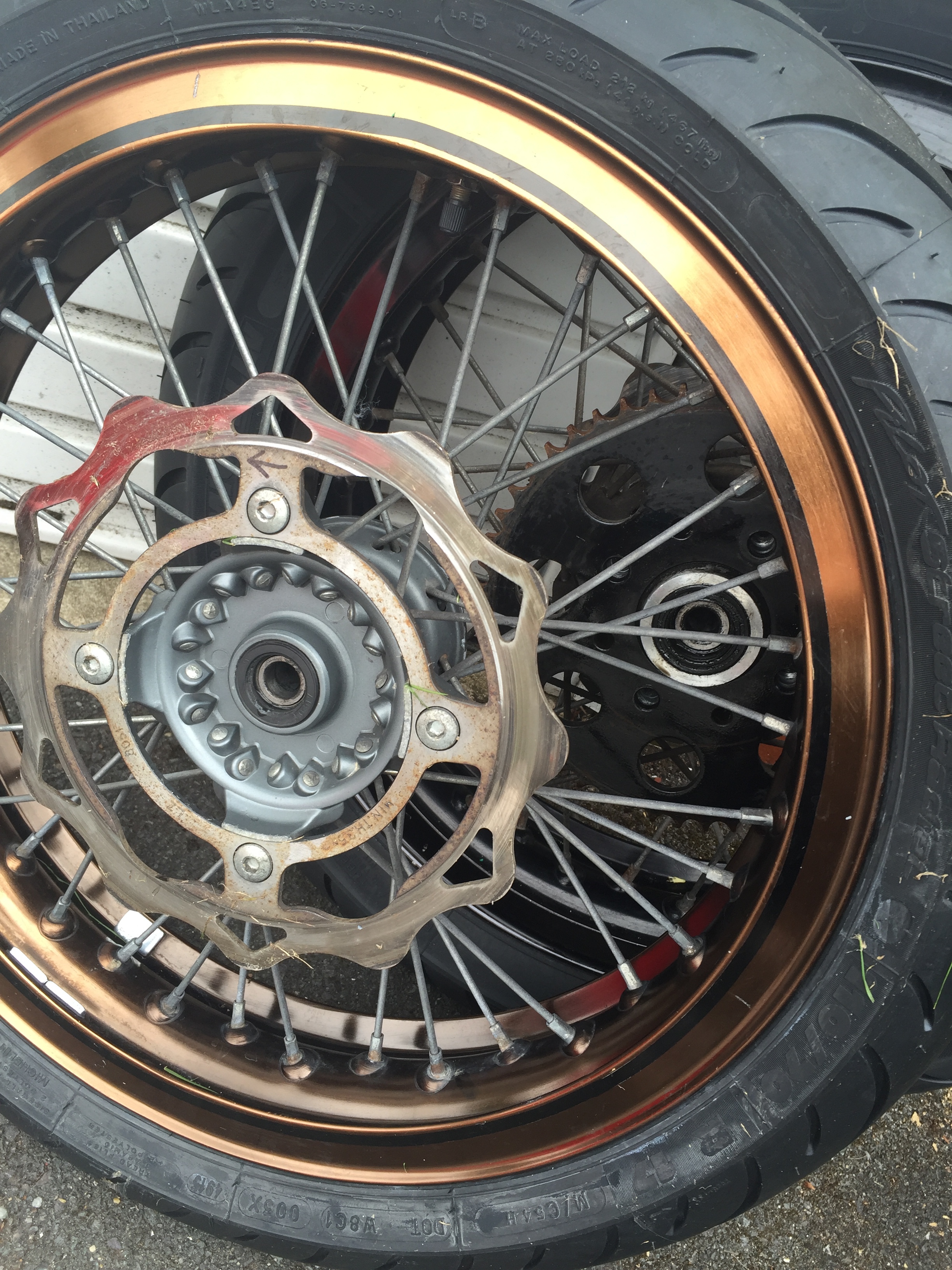

  • Resprayed tank (by hand with rattle cans... looks ok tho)

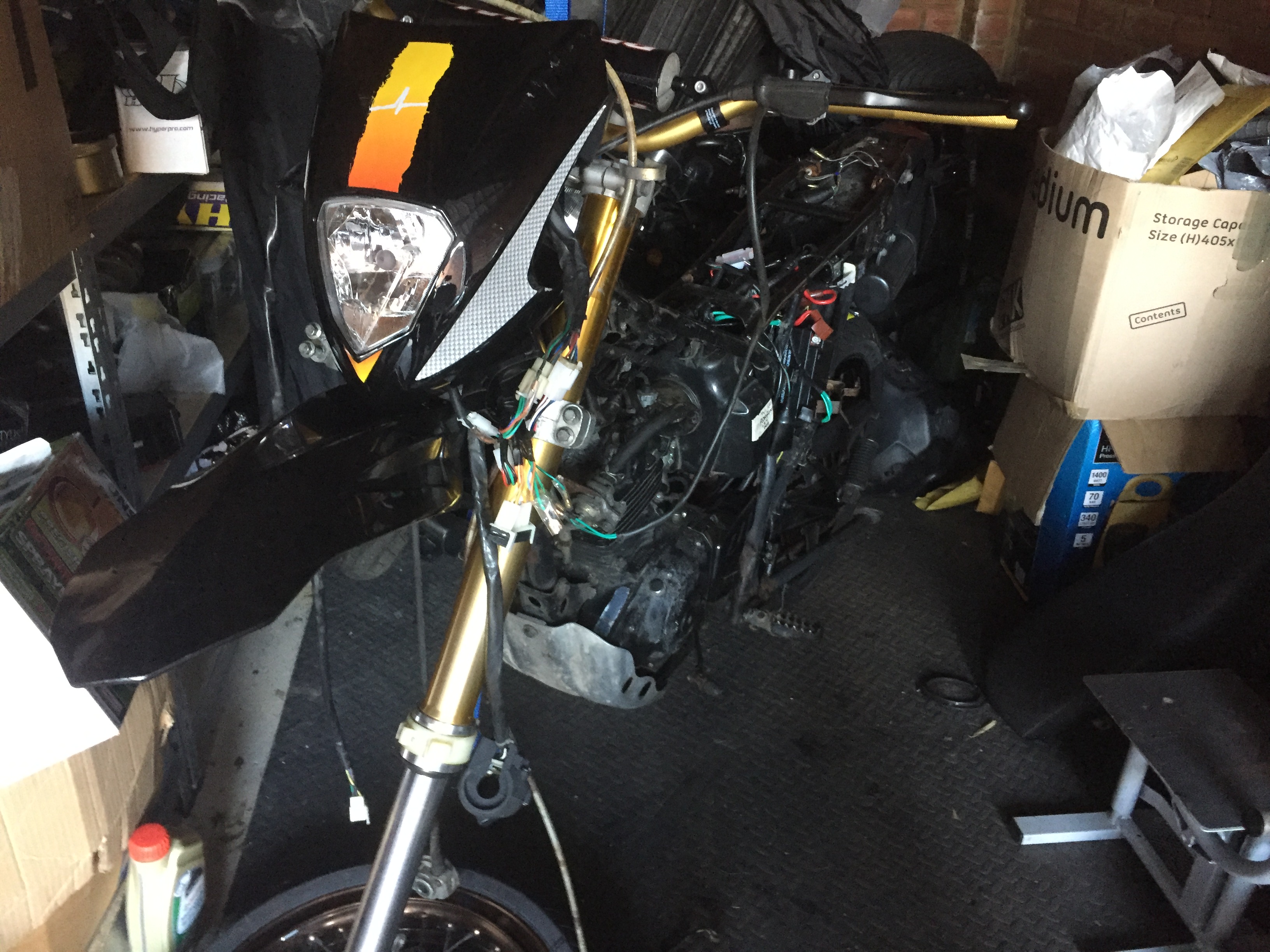

Pretty much done. Couple of tidy up bits and pieces, and MOT next weekend! Pretty happy with the outcome:
Looks a real beauty, well done!
Looks nice :) Now take it outside in the light and take some more photos :)
