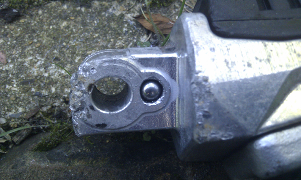

I would be very grateful for any advice on removing a stuck ball bearing from one of my pillion footpegs, photo below.
Its job is to keep the footpeg in the “up” position. It has a spring on the other side.
Since dropping the bike on a friend’s uneven driveway last week the ball has become stuck inside and is refusing to come out. It’s very odd as the spring should just push it out. If the spring was broken it should just drop out. There’s nothing visibly obvious keeping it in there.
I have tried soaking it in WD40, pushing it in with a screwdriver to coax it out (there’s about half a millimetre of movement inwards), freezing the ball to shrink it, freezing the whole thing, freezing then using boiling water (to heat the surface and remove ice), strong magnets, and (as you can see) bashing it with a hammer against a stone.

Replacement of the whole peg is a last resort, loathe to get rid of this one just because of a stuck ball. Will probably end up drilling it out and replacing the ball and probably the spring as well but will be difficult to drill it without damaging the soft aluminium around it.
Hold the rubber end and whack the other end either with a hammer, or on the bench.
Could youdrill a very small hole into the back and push it out with an unfolded paper clip or similar?
Although the peg looks a bit battered and the ball bearing is just going to get stuck again when you put it back. A new peg is probably not expensive.

hmmm… Would be good to get some heavy vibrations through it but I’m not sure how you could do that…
There should be a spring behind the ball, can you get some oil in there and push it inwards to try and get things moving?

The oil/inwards technique took up about 3 hours of my life last Saturday :crazy:
Thanks for the suggestions though, please keep them coming.
That’s a good idea re the hole from the other side, I might try that as a last-ditch option. Many thanks.
New peg, ball and spring from this website is only £25 but it seems a shame to throw away the existing one if a simple solution might fix it.

can you not get something very thin and pointy :w00t: like what the dentists use to clean teeth to get it out?
I would use my welder and try to stick a 2.5 mm arc rod to it . If that didn’t work all that would be left is to chuck it in the scrap bucket and buy a new one .
I would run the point of a stanley knife round the diameter of the ball, de-burring the alloy around the ball until it popped free. Ball is tough stainless, but those pegs are made of cheese. Ten minutes, a couple of stanley blades and some patience…:slight_smile:

Thanks for the advice. I broke a tiny precision screwdriver doing this then getting desperate and trying to prise the ball out, not what the screwdriver was designed for. I then tried it with various Swiss Army Knife blades.
Thanks for the other suggestions, will try those in time. Thankfully as most of my riding is two-up there’s no major urgency so will have another try in the next couple of weeks, otherwise will just pick up a replacement at Metropolis.
I might give the arc welder suggestion a miss…
the welding idea is a good one, if you have access to a welder…
