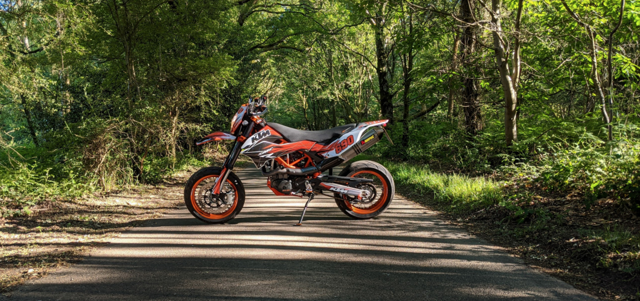

Decals
First thing I did was get some decals from the German company
https://www.independentracing.de/shop/de/markenshops/ktm-shop/ktm-street-dekore/smc-dekore/
there is a variaty of things you can customize like logos, number plate numbers etc
So once I decided what i wanted, I placed the order and the guys even changed the color of a few things for me. The process was great and decals actually came before the bike was delivered ![]()
So first order of business was to remove panels and old decals
Then get the new stickers on. I used the dry method and a small hairdryer to put the stickers on and for a first timer they went on ok.
Note: the sidepanel stock decal is ‘in’ the panel - it doesnt come off. option one is to get a new panel without a decal but they are only available in orange and black.
Option two and what i did is to try and cover the stock sticker, it needed some stretching in some areas but the oem decal isnt noticeable.
and put them back on! happy with the result! ![]()

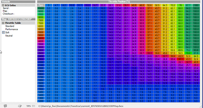

TuneECU dongle
Next on the agenda was a dongle to the ECU and having a play with tuneECU. (note you cant use tuneECU on the 2019+ models - you need to go down the power commander route).
Looks like this:
and plugs into a port under the seat. It can be used for fault finding, and obviously tuning.
Info and installation found here
https://www.tuneecu.net/
There is a free PC program (note - doesnt work on a mac)
Or a paid for mobile app.
I have only ever used the PC program
Once connected to the bike i could double check that the correct map was installed on the bike i.e.:
km765eu12b0233ep
km765eu12b0233fi
after some research decided not to do any modifications on the throttle maps (the 100% one) but i do have them saved if anyone needs them.
so mapping left as is until the booster plug (see later post)

Some notes on tuneECU
My bike is a '12 SMC-R with Akra pipe, normal filter and 02 and SAS still on the bike
Currently the map thats on the bike is the km765eu12b0233 (EP&FI) and the bike starts easily (minus the cold stall - see above for fix),it doesnt hunt and has good throttle responce.
Note 233 is a combination of 2012 EVO1 FI (KM765EU12B0231FI) and stock 2013 EP (KM765EU12B0216EP).
Also note there is no AKRA map post 2011, the EVO one covers the Akra pipe.
Another thing i noticed is that the km765eu12b0233FI map has the same setting for all tables F1,2&3, L1,2&3, I1,2&3
Meaning that once you load the 233 mapping all that the mapping dongle does is change the EP settings not the Fueling (The throttle map looks like it is relative RPM)
I need to test this against AMA’s Relative RPM and report back
(unless someone else has already tested the above)
There is also the chance of setting the throttle map to 100% where it means you get what you ask from the engine, but I believe the consensus is an RPM relative mapping is better
There is also the myth of changing the F-L setting to 10-10-0-0-0-0-0 but this seems to be a bad idea for bikes post 2011.
