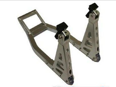

Rear stands;
There are 3 types here.

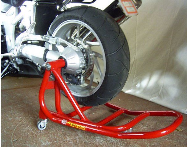

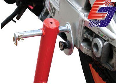

The first one is if you have a single sided swingarm, if so, then there is only this design.
and this is how it looks on the bike;

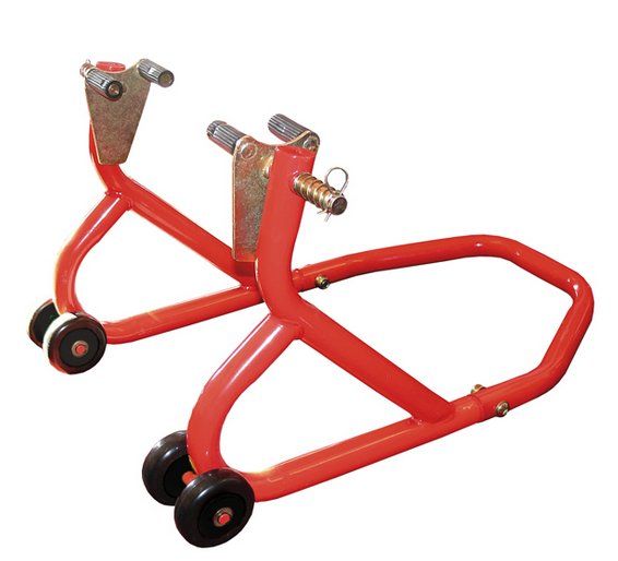

The other 2 are for conventional swing arms.
The first one of these has rubber pads on adjustable arms. These pads just locate on the underside of the swingarm, and lift the bike from there. These are ok, but can be a little fiddly to use, depending on what bike you have.
They look like this;

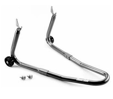

The second type, is the one that uses bobbins (or cotton reels)
attached to the swingarm, to lift the bike.
And they look like this;

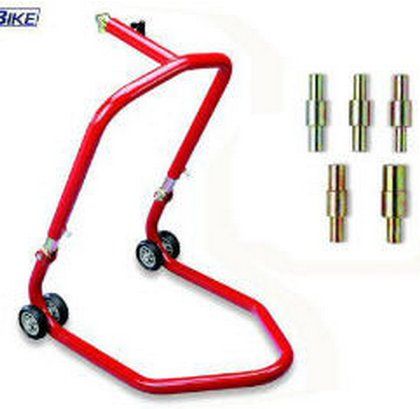

These stands have a fixed or adjustable v piece (or some have a curved hook), that locates on the bobins to lift the bike up.
This is the curved hook type;

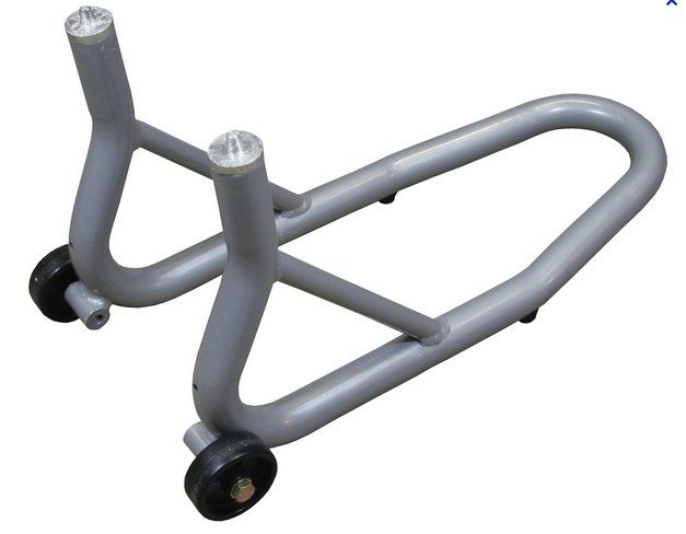

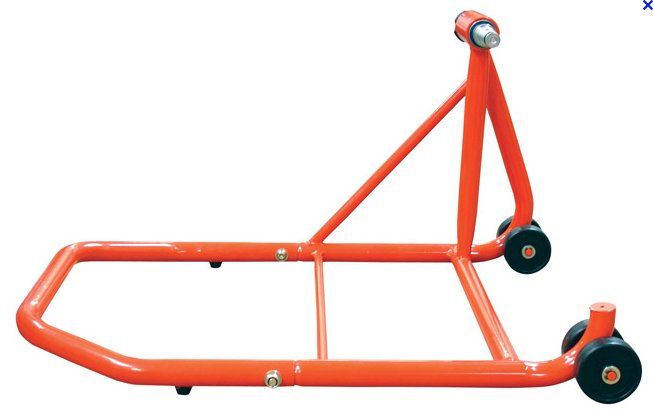

As far as front stands are concerned, there are generally 4 types here.

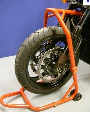

Under yoke;
and on the bike;

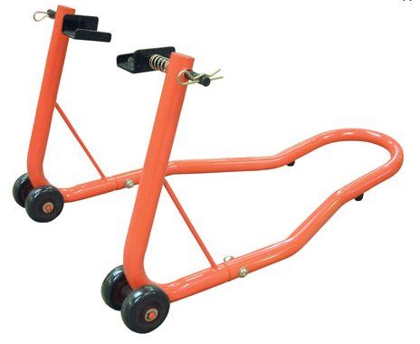

And then the 3 types that fit under the fork legs. again, it will depend on what bike you have, to decide which will be the best stand for you (your bike)
This is the first type;
one of the arms hooks under the bottom of the fork, whilst the other arm presses against the back of the fork leg to lift the bike (if you have radial calipers, then this type can be a little tricky to use.

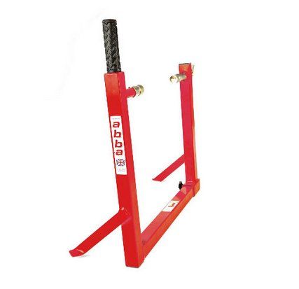

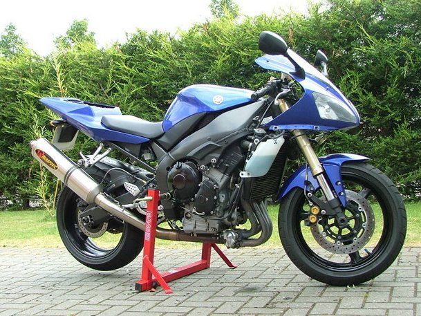

The final option is in Abba stand, which looks like this;
And on the bike, looks like this;
These are quite good and very sturdy and allow good access to the rear of the bike. They don’t lift the front of the bike, but with the bike on the stand, it’s easy to pop a small trolley jack under the sump to also lift the front wheel up, if needed.

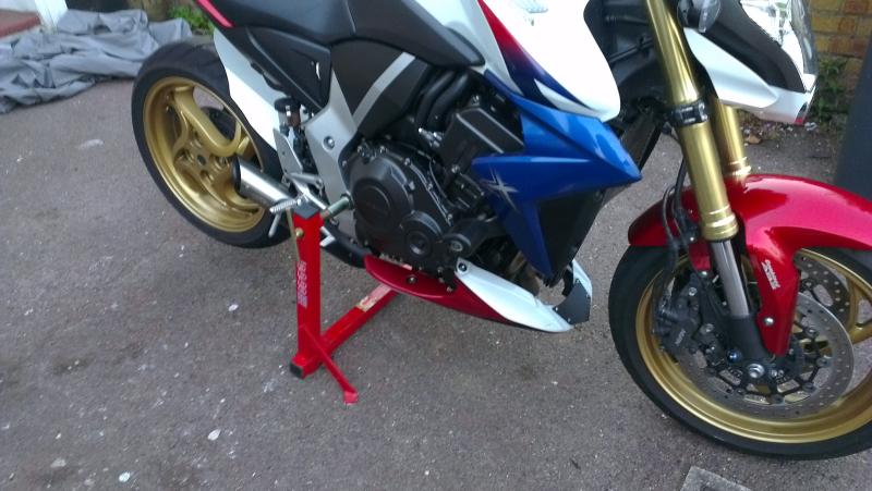

So, I have my Abba stand and some fittings from Pan, although not specifically the CB1000R fittings. Not as easy as they make it look at first…
Should the fitting be as loose as that? The connecting rod seems a little reluctant to move along the base too. Maybe a little lubricant?
I managed it in the end of course. Standing over from the left side, holding the fitting in place with my knee while I connected the opposite side rod to the base.
Oh dear, Pan I think I’ll be returning yours and getting the right ones. Abba tell me “This is completely the wrong fitting kit and looks very dangerous if you was to lift the bike on this kit!” :Whistling:

just saw this… as said they are from a gixxer but seem to fit on the bike. i thought it looked stable on mine but if Abba say its dangerous then dont use them
was worth a try
btw the fitting shouldnt be that loose. did you put in on the correct side?
