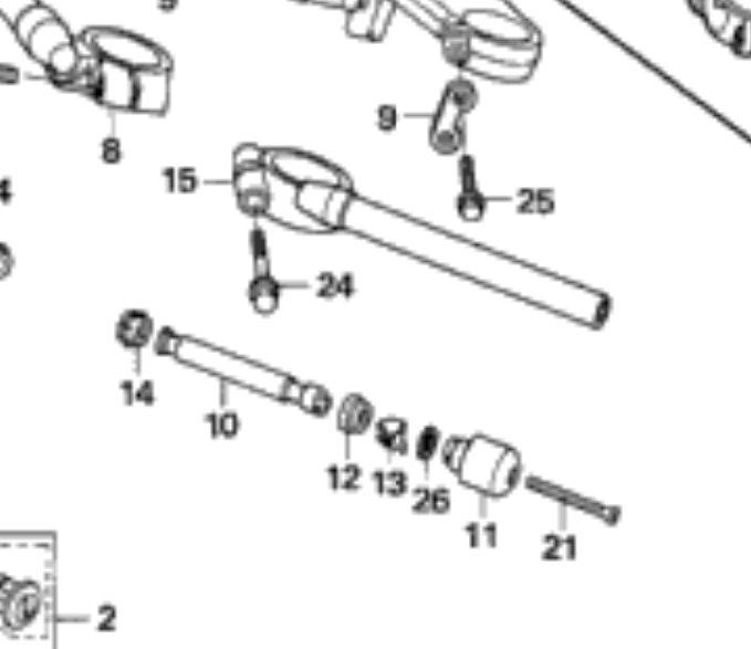

I’m not sure if the pics will show properly but my set up only has a short bar end (item #11) due to the OEM inner weight (item #10) so the universal fit will be too long.
I am not really understanding this, and yet I want so ask whether buying fully threaded bolts for the inner weight then cutting down to size for the guards might be an answer?
Maybe I’m over complicating this… And I can just not use the expanding mechanism and the existing bolt that screws into the inner weight.
The problem I have (apart from being clueless) is with the expanding mechanism, there won’t be enough space for that AND the inner weight.
I understand now, but unfortunately I have also remembered my idea will not work.
The inner weights sit free inside the bars, so the Honda bar ends are shaped to ‘lock’ onto the them. That way you can hold it still to remove the bolt, otherwise they will just rotate rather than loosen. The R&G sliders for Honda bikes have the same shape, but it is unlikely anything universal will not. So even if you can tighten them, they will probably never come off.
I would try contacting someone like R&G to see if any of their models for other Honda bikes will work with yours. I would think the bike specific aspects of them might just be the style and size rather than the mount. And that will not be any more of a comprise than using something universal.
Otherwise just replace the weights with some cheap bar ends, go for a ride, and see how it feels. Maybe the vibration will not be a problem that you do not need the weights.

The Honda bar end weight mechanisms were not designed to come off, be replaced or played with. You can replace the outer weight as you’ve done with sliders but replacing the inner mechanism can have an adverse effect. The inner mechanism is a coiled spring damper which has tabs that fit inside securing holes in the bars and when the bar end weight/slider is fitted everything locks in place.
To remove the inner coiled spring damper you must first remove the handlebar grips so you can depress the tabs in order to release and pull the damper out. You can’t fit the after market lever guards without removing the spring damper because there is not enough room for the expanding fitting or, if you try bolting the after market lever guards directly into the spring damper without the expanding fitting you will not get sufficient clamp between the parts.
You can remove the clips from the insides with a screwdriver. Not the easiest but it can be done. Whether there there will be space between the weight and any third-party end will depend on the design. From the diagram above showing the guard recessing it should fit.
But I went the other way as I replaced my happy-to-bend Honda bars with Renthal equivalents. But they are thicker with a smaller inner diameter, so neither Honda inner weights nor normal bar ends will work. So I used some of expansions bolts, wrapped in a bit of amalgamated tape, and some long bolts cut to size, so I could use the Honda bar ends. All good, and was even able to later attach some basic universal hand guards over them too.
