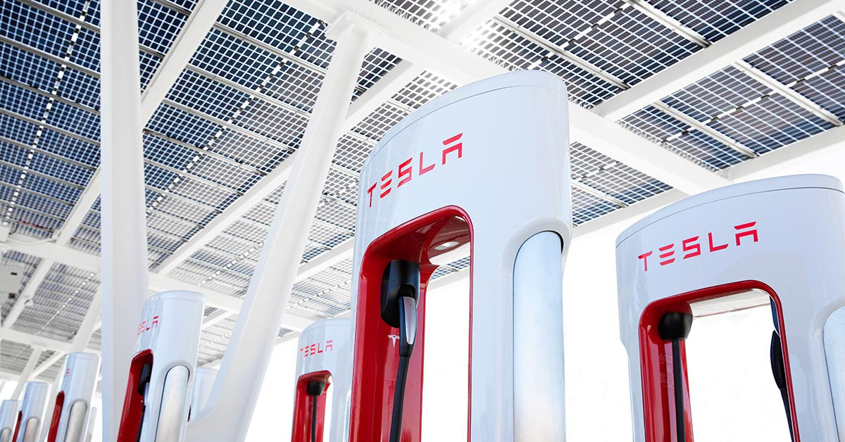

172 miles of range in 15 mins. No supporting figures, but 100% believable, Tesla Superchargers are FAST (250kw)

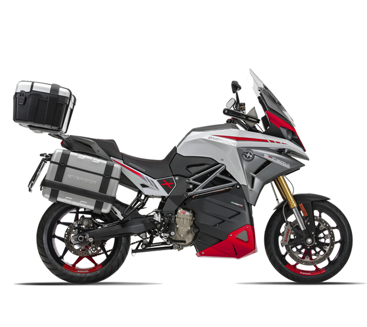

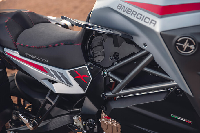

The Energica is quoted as having a 3kW onboard charger, so a lot less, giving a theoretical max charging rate of 180kWh, which should be enough to charge a 20kWh battery in just over 7 minutes. The fact that it can’t suggests that there’s some other bottleneck. Perhaps it’s cooling. Teslas will turn on big fans somewhere under the bonnet to cool the onboard charger when fast-charging as it would seem heat is a big by-product of fast charging. If the ambient temp is high enough and the SoC is low enough this can actually be surprisingly loud. Obviously a bike would be very limited in how it could cool the onboard charger if just using air cooling due to space restrictions.
The brochure quotes 40 mins fast charge. No other info, i.e. to what percentage. I’m going to guess that’s to 80% SoC. For me, this is the main area that needs development.

Also, I would guess that with bikes we’re seeing thermal throttling of the onboard charger due to the lack of space for adequate cooling, like we do with laptops that have tiny form factors and powerful processors - they can only run at full speed for so long before the thermal dissipation capabilities of the laptop are exceeded and power needs to be reduced to prevent thermal damage.
