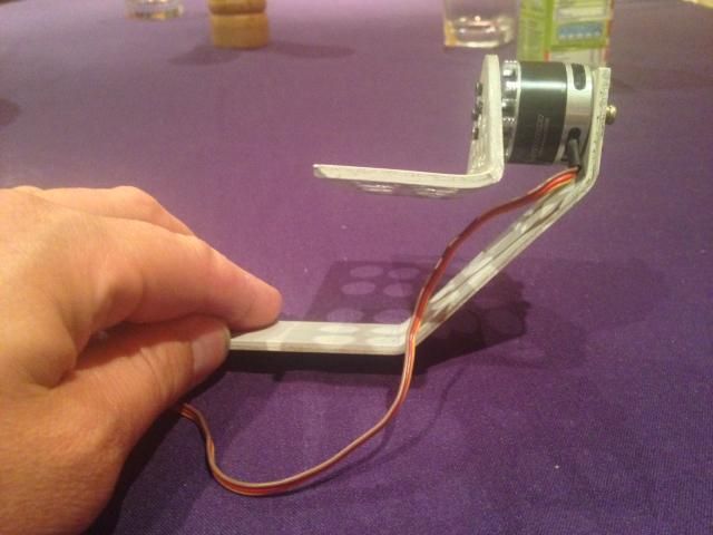

Inspired by the MotoGP cameras, I decided to build my own gyroscopic camera.
Excuse the roughness of it, its a very early prototype at the moment.
Custom made single axis mount, with a single brushless motor, martinez gimbal control board, with different software, Lipo battery, and about 10 hours of programming.
Still needs a lot of software work and some more work on the mount etc.

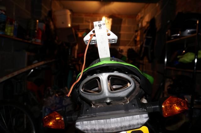

Been super busy at work and home and not had time to update this, however a bit of progress has been made, software is dialled in now, although am waiting on some replacement parts due to my own stupidity. I have made a couple of revisions of the hardware mount. It is now completely different from the original pics, mainly as I have decided to make the mount fit with the standard gopro mounts and a choice of standalone battery or hardwired, the vid below is it attached to my gopro suction mount attached to my tank.
The advantage of this is that it can be used pretty much anywhere, side fairing, rear, tank etc.
I also want to try if it will be able to mount onto my chest harness for the bike and mountain bike. Once I am back up and running I will get some decent footage.

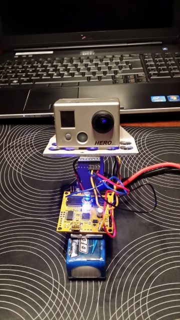

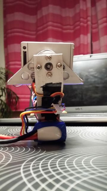

my current status … still in development …
in the hand:
on the bike:

it’s only gyro-/accel-sensor driven with a brushless motor - no gps at all :frowning:
it can be powered by the motorcycle-battery or a 3S LiPo-accu
it’s not for sell (at least now) … I’m not completly satisfied with the result for now - I hope it will work better after some more tests.
The Materials costs about 150€ - but the investments to get to this point where (very) much higher :wink:
I guess I’m willing to sell one of my 3 prototypes for … let’s say … 250€ … but I also guess you should wait until someone (maybe me) get’s it to work out a bit better :wink:
