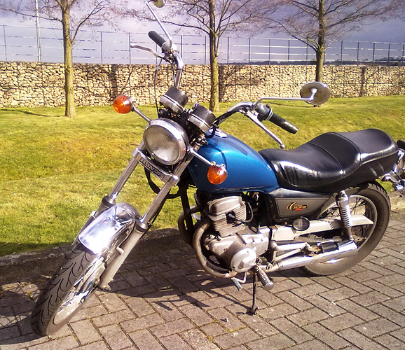

My Honda CM125 is not accelerating. Any knowledgeable bikers / mechanics who can help ? (Can pay)
Hi,
Admittedly im pretty new to bikes and biking and bought a 1983 Honda CM 125
just before christmas. Its a nice bike but seems to be showing its age, as its being very temperamental
and not running smoothly.
Basically I keep getting a problem where the bike just isnt accelerating and once i have changed out of
1st…2nd gear there just isnt any pull in the bike and really have to open the throttle on full in 3rd
just to drag it up to 20mph(!)
This is the 2nd time this has happened. The first time I had a friend
look at it who opened up the air filter and sprayed carb spray into the carbs. We also checked the spark plugs,
cables and topped up the battery fluid as well as oil . This sorted it for a month or so , but now the problem
is back and just want to sort it once and for all! (The friend lives in Cornwall, so isnt available to take a look again
and also their knowledge is reasonably basic too)
It is a simple bike, but im not a mechanic and know the basics but anything else is beyond my knowledge but am assuming its
something to do with the air mixture or fuel / carbs? Maybe needs the carbs taking apart and cleaning out.
Does anyone have any tips on this or ideally im looking for someone who can come take a look
and give me a hand to get it sorted? Pic of the bike is attached.
I will add that I can pay, but dont have alot of cash. Im based near Old Street, so please
let me know if you can help me out! Itching to get out on it while the sun is still out!
Cheers.
Simon
