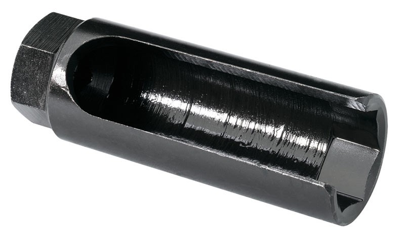

Just wondering if anyone has a 22mm lambda sensor socket that I could borrow. I need to replace the sensor on my car but don’t have a tool that’ll do it.
They look something like this apparently:

Yep, I’ve got one of them. Think it’s same size, was for Vauxhall Zafira engine Lambda sensor. More than welcome to borrow it.

The Lamda’s are a pain to get too often, often in sunken recess. The cut out slot on this socket is to allow for cable attached. As with most jobs, they’re a damned sight easier with the right tools. Think I picked up mine off ebay for about £5-10. ish.

I used an adjustable pipe wrench when I replaced the oxygen sensor on the Vauxhall
No need to worry too much about the torque on these, just nip em up
