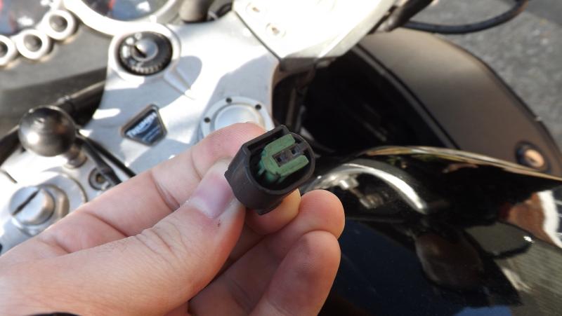

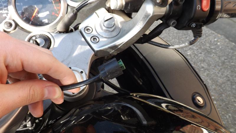

So I was making the most of this lovely weather and giving the sprint a clean. And I came across this:
Now I think it might be a sat nav connector as it’s routed to where the sat nav mount is on the bike, but I’m not sure and can’t seem to find anything online.
No idea. Why don’t you email the PO and ask them?
Looks like a relay connector maybe?
Do you have an electronic fuel gauge?
Looks like the connector I’ve seen on a bike recently (plugged into the tank).
But I’m not firmilliar with triumphs.
It does have one yes but that’s all working fine.
Duh, why didn’t I think of that??? Must be the heat sending me bonkers.
I’ll see if I can find his email address and drop him a line
Looks like the power connector to a Tomtom Rider GPS.
aye, tomtom mount
Damn, can’t use it for my tomtom xl then. Well not without modding it in some way :ermm:
A quick google search shows that this is what the wire for a tomtom looks like.
Looks like you got a free tomtom charging wire with your bike…
Awesome :slight_smile: shame I haven’t got the right tomtom for it though :frowning:
Whoops - wrong connector
The Triumph GPS and Accessory connectors wiring is colour coded the black wire is earth and the purple wire is permanently live. The connector is the one on the right.
If you want to connect a SatNav to it ebay is you friend
12v waterproof motorcycle socket £4.41
6.3 mm spade connectors
The 12v socket will connect to the Triumph socket by means of a pair of 6.3 mm spade connectors, can’t remember if male or female connectors are required but it’ll be obvious from looking at the Triumph socket. Obviously a little insulation will be required, I insulated mine with a winding of PVC tape and some shrink wrap to be sure to be sure.
