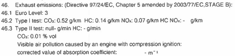

Here’s the data from my Certificate of Conformity. As you can see, it clearly states Euro 3 along with the actual emmissions test figures.

Noteworthy here is that TfL’s ULEZ compliance is based on the level of nitrous oxide (NOx) emissions not the Euro standards, the bottom line for ULEZ exemption being less than 0.08g/km.
Thankfully, it’s not quite that strict. Euro3 for petrol vehicles allows up to 0.15g/km. 0.08g/km is the figure for Euro6 diesels.
