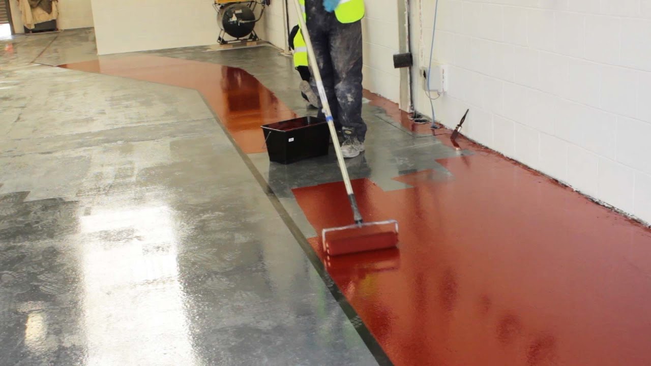

So looking at sorting out my garage floor and torn between using something like the cementone or wether to just coat it with a hard wearing epoxy paint like this, they do a cold surface variant. The floor is level.
If it’s suitable for a HGV workshop sure it’s fine for a single garage
@Jay what did you use on your workshop floor.
Only thing of concern is my garage looks like it may have a bit of damp on the wall near the floor (was raining and garage door had been open hence the damp at the entrance) and has an ?oil spill on floor which needs addressing first
Plan is to then also paint the walls with white gloss masonry paint to help brighten it up
I used this:
Showroom Epoxy Resin Floor Paint | Resincoat
Like decorating the house, it’s all down to prep, the better you prep the floor before applying this stuff, the better the result will be. i.e. resolve all damp issues, level it, screed it flat if necessary and then apply liberally. You’ll want to make sure you can completely seal the room up as well so nothing wafts in with the wind and ruins the finish.
