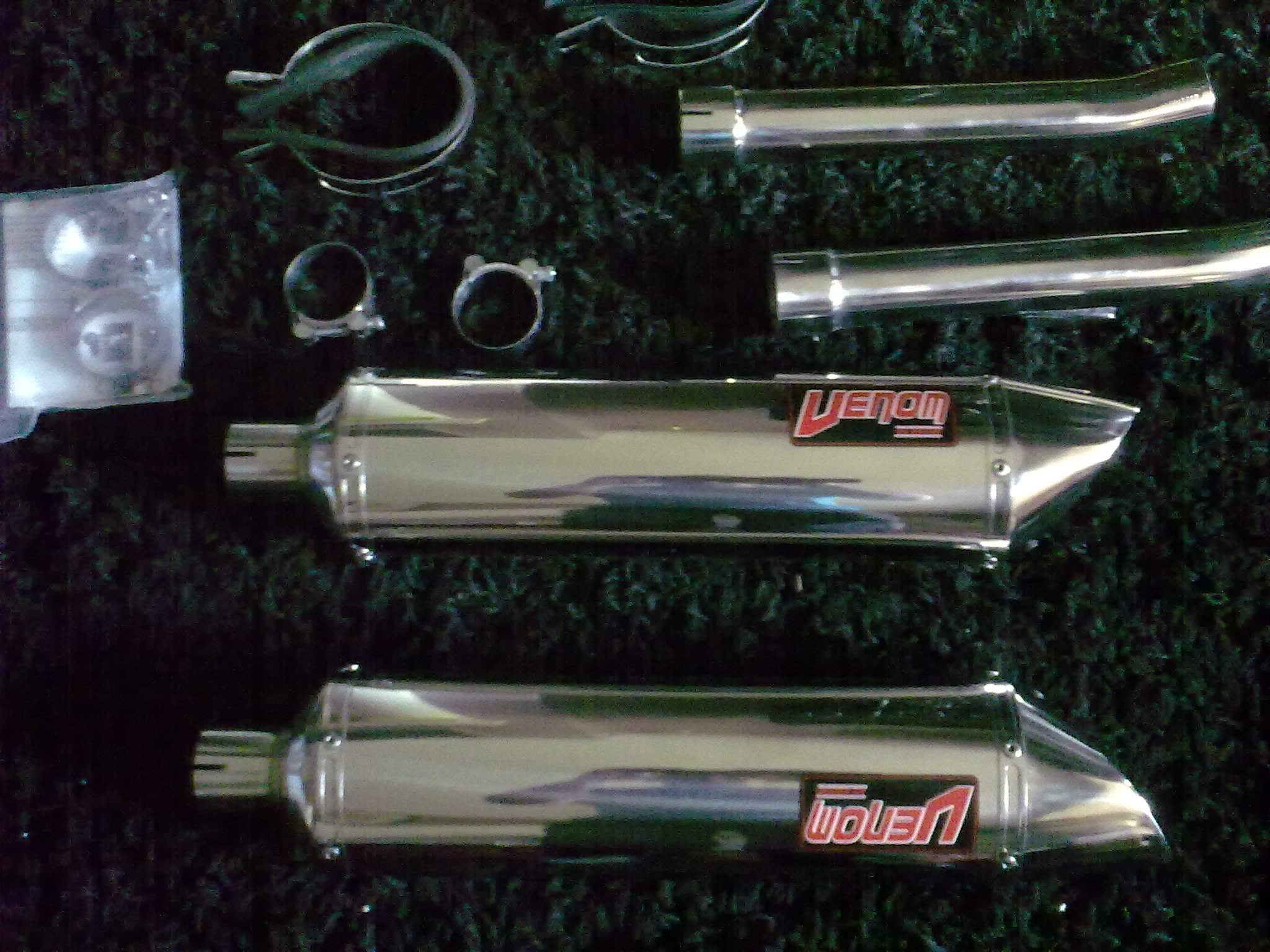

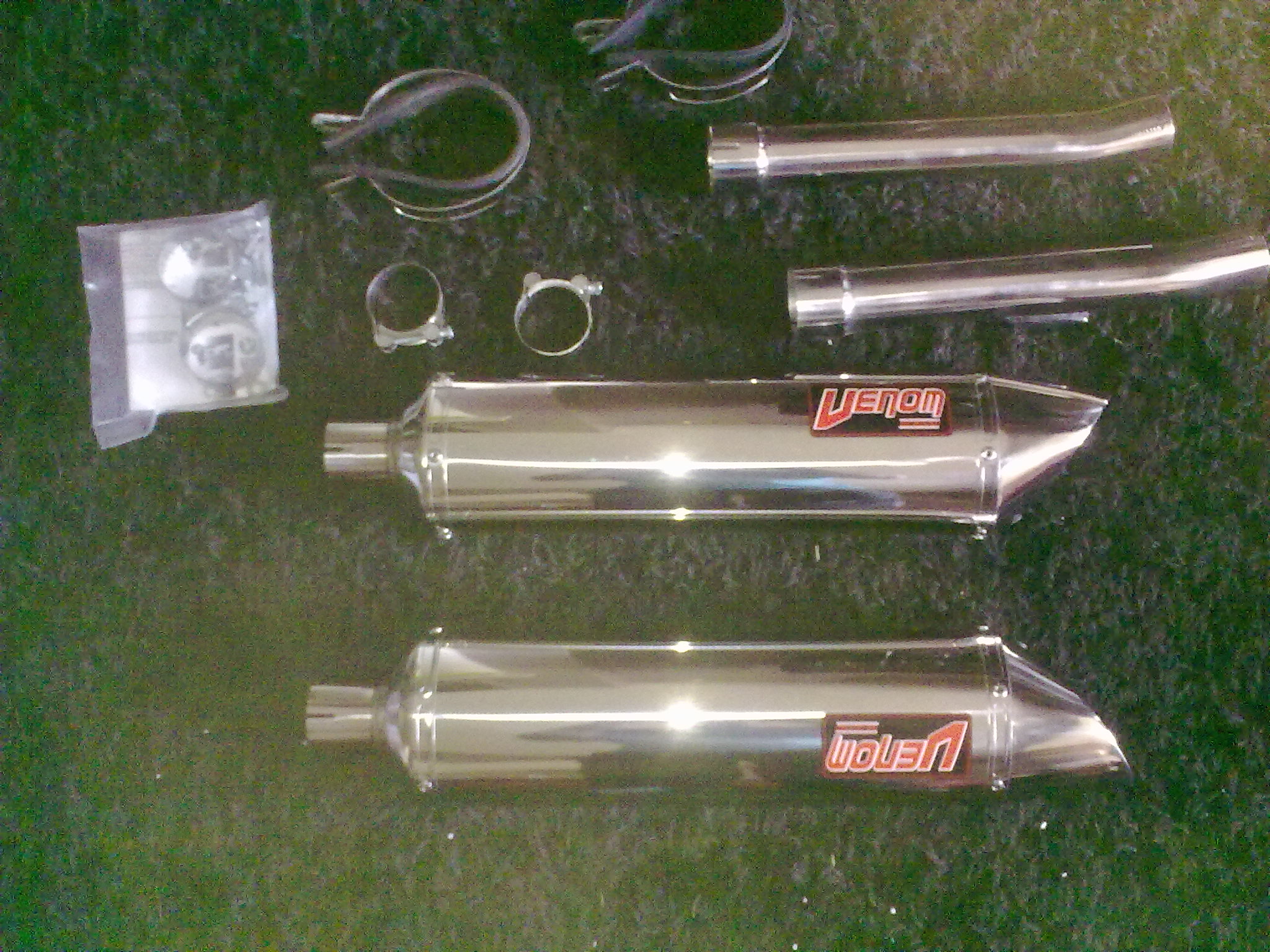

Thanx all, tested the old one, went down to brentwood to get a new one, in MRS Girly micra, as im not to well, wish i took the bike nagshead road wow, great country lanes,
and the fella in shop had right leg in cast, got hit of his bike, anyways driving home, abit down coz in a car nice biking roads, good weather too, got home fitted the element all works good, Thanx to all your helps, then Mrs said thought id waight till you fix that first, this came for you when you was out. she was right to do so to. I am one not well happy chappy
Sounds like a slip up with the slip ons :wink:
Hope to be well enoth to put em on this weakend, try to do ickle vid&sound before an after.:smiley:
