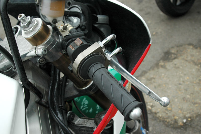

i fitted a q/action throttle to my NC30 gotta say its the mutts nutts, the one i have fitted is a 60 degree one with a nice titanium case, it took me about 2 days to get used to it but now cant imagine life without it! less ache on the wrist due to less movement but not recommended for those with rubbish throttle control… you gotta be sooooo smooth also watch those wheelies they get a bit jerky at first also come up a lot quicker than expected… relearn how to ride your bike before any stunt monkey antics
I love that picture, and the QA throttle. I want one… bugger…
I got one on my racing SV, its great on the track where you need all or nothing type scenarios. Not sure how good it would be on potent bike on slippery wet london streets though. With practice I am sure you would be fine. That pic put up certainly makes it look the dogs danglies.
