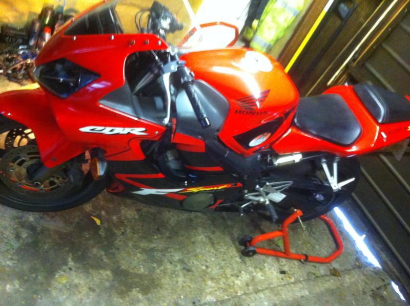

But Got Some Bits Done Today Here Was The Bike This Morning

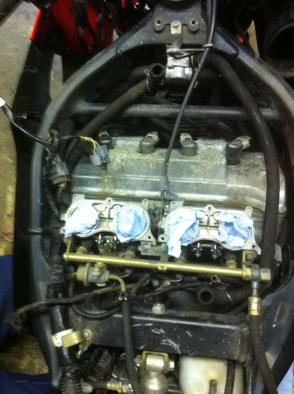

So Firstly You Disconnect The Battery, Remove The Tank And Airbox So You Have This:

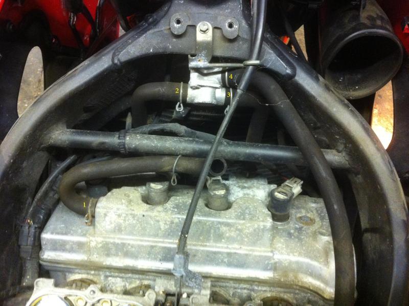

First The Clean Air Mod Which Is To Stop The Engine Hydrolocking When You Hit The Deck Also Apparently Gives You Extra BHP But I Cant Confirm This

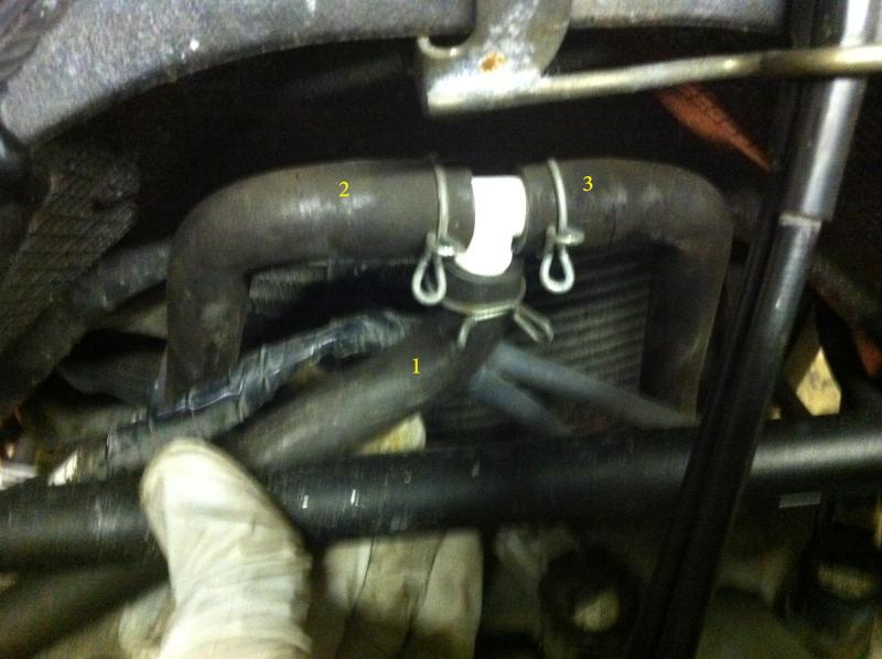

So You Start With The 4 Pipes And Air Valve You Will Be Removing The Air Valve And Pipe 4…
So After Removing The Pipes From The Valve And Taking Pipe 4 And Valve Away You Need To Use A T Piece To Connect The Remaining Pipes So They End
Up Like This:

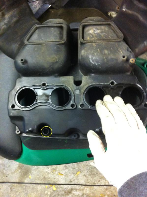

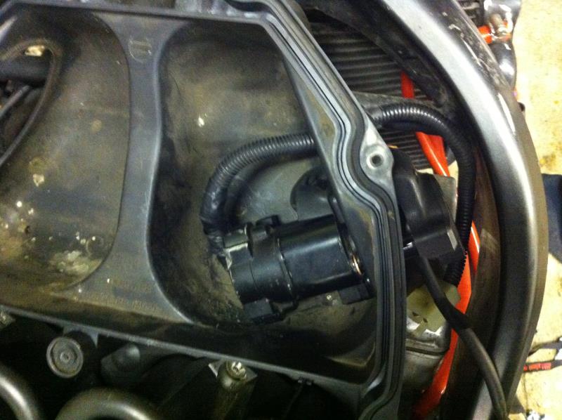

Now The Number 4 Pipe Went To The Air Box So Now That Needs Blocking Off I Used A Bolt Here Is Where Needs Blocking Off Under Airbox

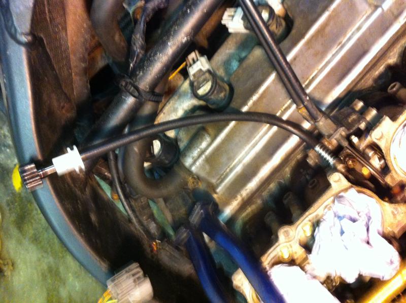

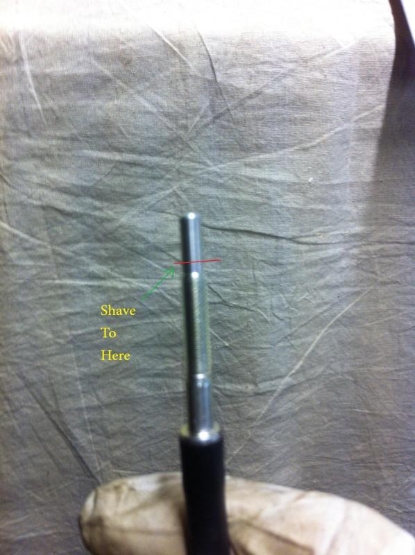

So Clean Air Mod Done Now 2nd Idle Cable I Used One From CBR 600 F4I

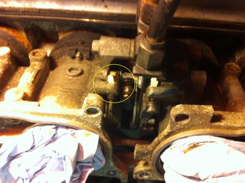

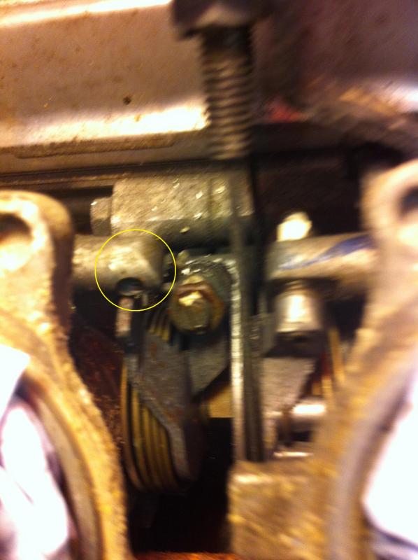

The End Of Idle Thats Un-threaded Will Need To Be Shaved Down About 3 Quarters Of The Way Otherwise You Be Revving At About 5000-6000 revs as Idle is longer then stopper screw

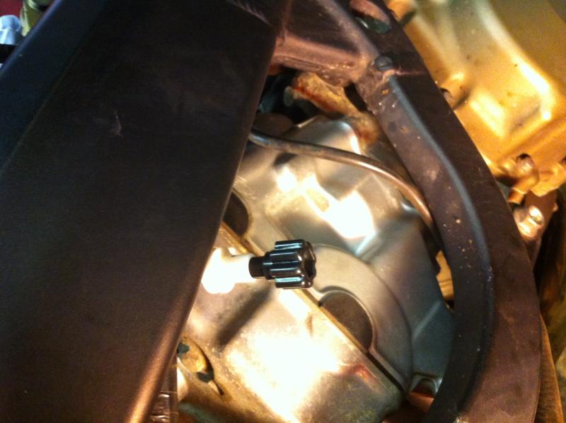

You Need To Remove Stopper Screw Which Is Pictured Below
Once Removed Looks Like This
Now Time To Add The Idle
Then Routed It Out Of Side Of Frame

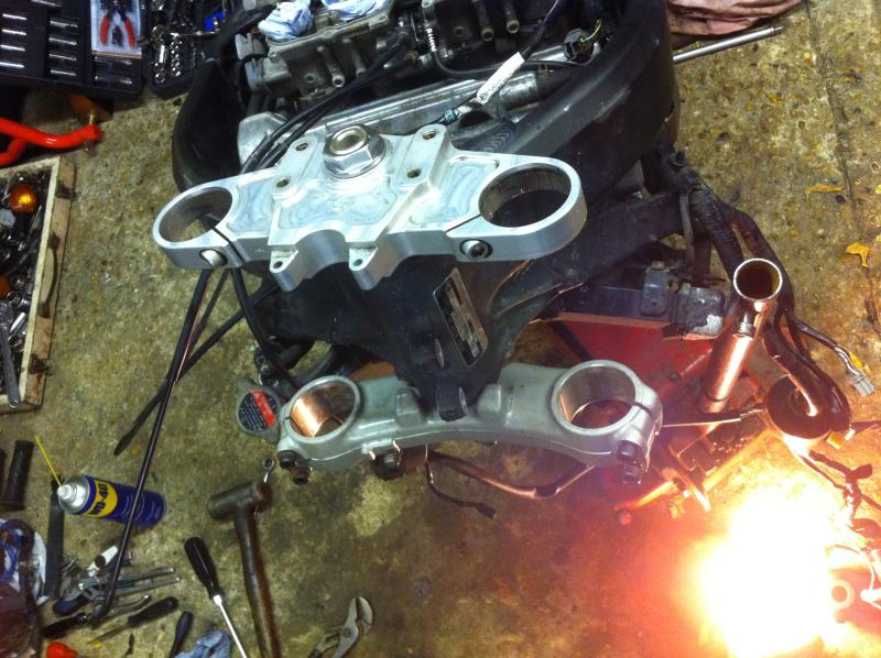

So Today Had Some Spare Time And Put The Front End In
Managed To Get Another Bottom Yoke Off Ebay
So Whilst Was Changing Front End Done Head Bearings Aswel

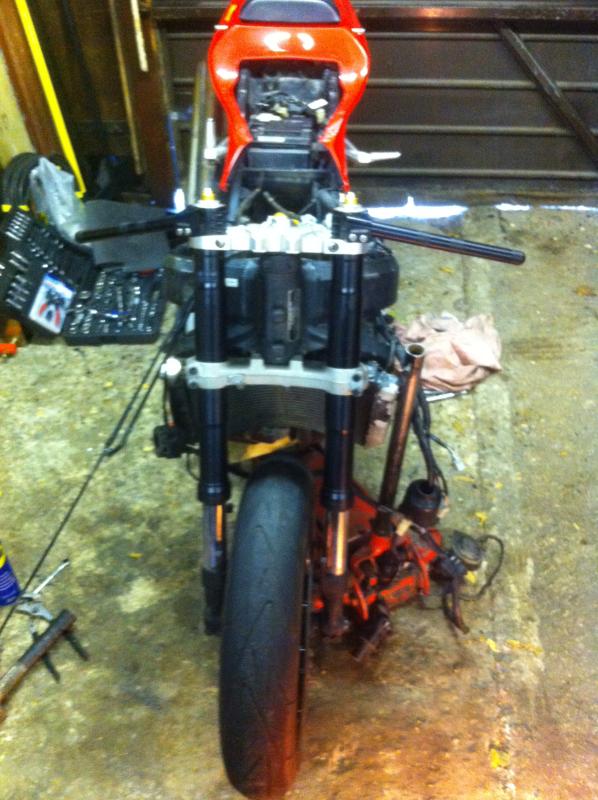

Used A 954 Bottom Yoke With LSL Top Yoke With 2002 R1 Forks And Wheel And Racetek Clip Ons Althought I Am Going To See How Get On With Them May Change To Straight Bars In Future…
First Change Bearings And Put Yokes On Is Straight Swap Just Bigger Yokes To Put 50mm Forks
Then Forks, Wheel And Clip Ons So Is Currently Like This…

What is hydroblocking? Just out of interest…
And what’s the reason for cutting down that idle screw?

And the idle screw when is standard has the bike at about 5000-6000 revs which is not the way forward as is alot longer then the stopper screw so but cutting down runs at 1000 revs and can change to desired level quicker then standard idle as straight to throttle bodys

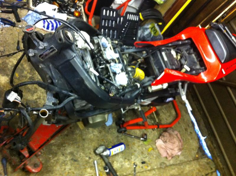

So been ages since actually done anything on bike as working on others and other commitments but finally got to do some stuff today

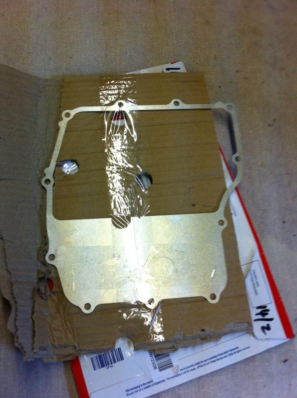

Wanted to put Wheelie Sump on… what it does is trap oil and 180’ the oil pick up so you dont get oil starvation and break your engine…
Also wanted to change oil and filter and new coolant…
Here is one i bough from guy in states i deal with
But that wasent the case as had to remove the downpipes to drop sump off but the studs where all messed up so have ordered new ones and also the drain plug bolt on water pump snapped so now have the fun of drilling that out hopefully all be sorted but next weekend then can actually get some more stunt parts on

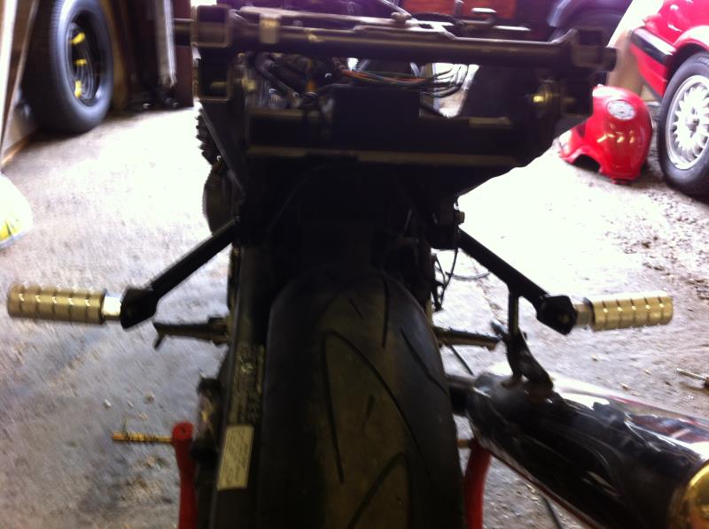

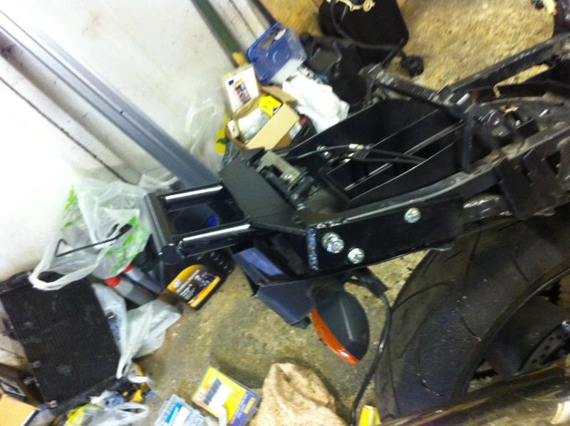

First Put Stunt Clip Ons On
Then Added Sub Cage And Pegs

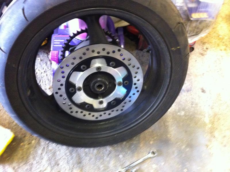

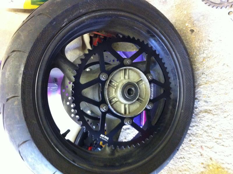

Then Bigger Disc on Rear Using Floater Is 320mm Front :slight_smile:
Then Sprocket 65 teeth cos you just gota

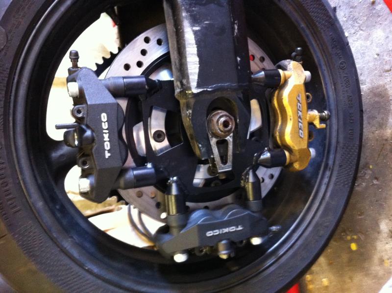

And finally put rear wheel back on and added Caliper bracket and Calipers for some Monster Brake love :slight_smile:

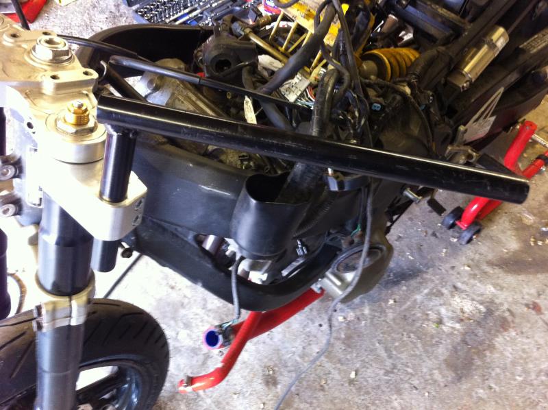

Put 12 Bar On Today
Also relocated ignition just drill some holes on side of air box and bolt down ignition and HISS
You got them blues at last! :slight_smile:
gotta put gold calliper in the middle…
+1
Its only because it will look better IMO but worth it for the sake of the 2 mins it will take.
Three calipers is frigging cool though!
Was only put on like that to show it when actually riding will only have the 2 to start then when get better will have the 3…
