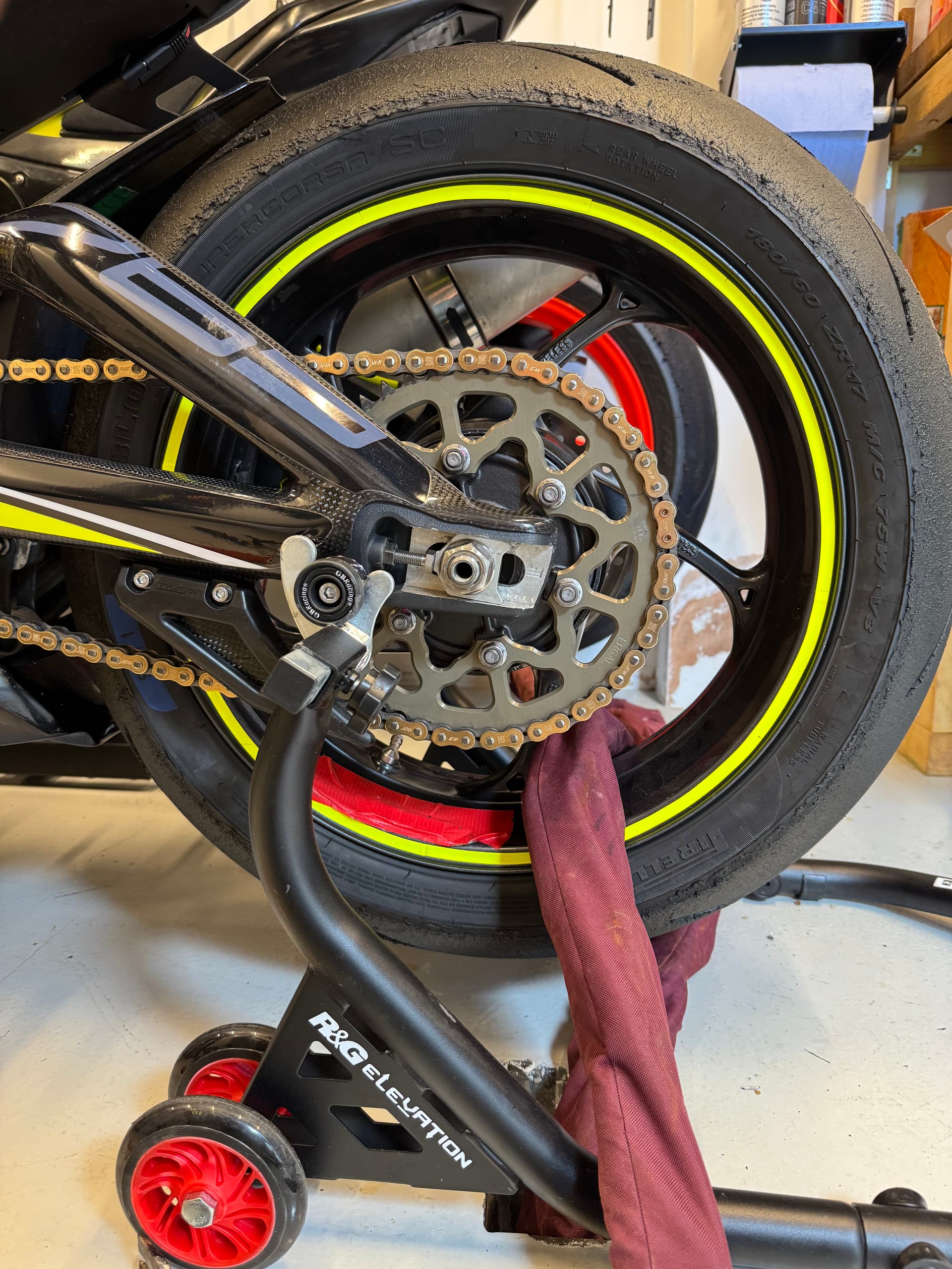

If you have a swinging arm that suits the cup adapter (more common name for the L ones), i.e. is generally flat and level, and it’s only for home maintenance, then they’ll be fine.
For actual paddock work, i.e. trackdays, no, cup adapters are no good, they are harder to use quickly and not as secure. For paddock work you need something like v-adapters.
The good news though is that the adapters are generally interchangeable, i.e. on the one linked they sell a v-adapter, so you could always upgrade later if you wanted, i.e. like our R&G ones are able to support different adapters by just sliding the adapter out after loosening the knob:
