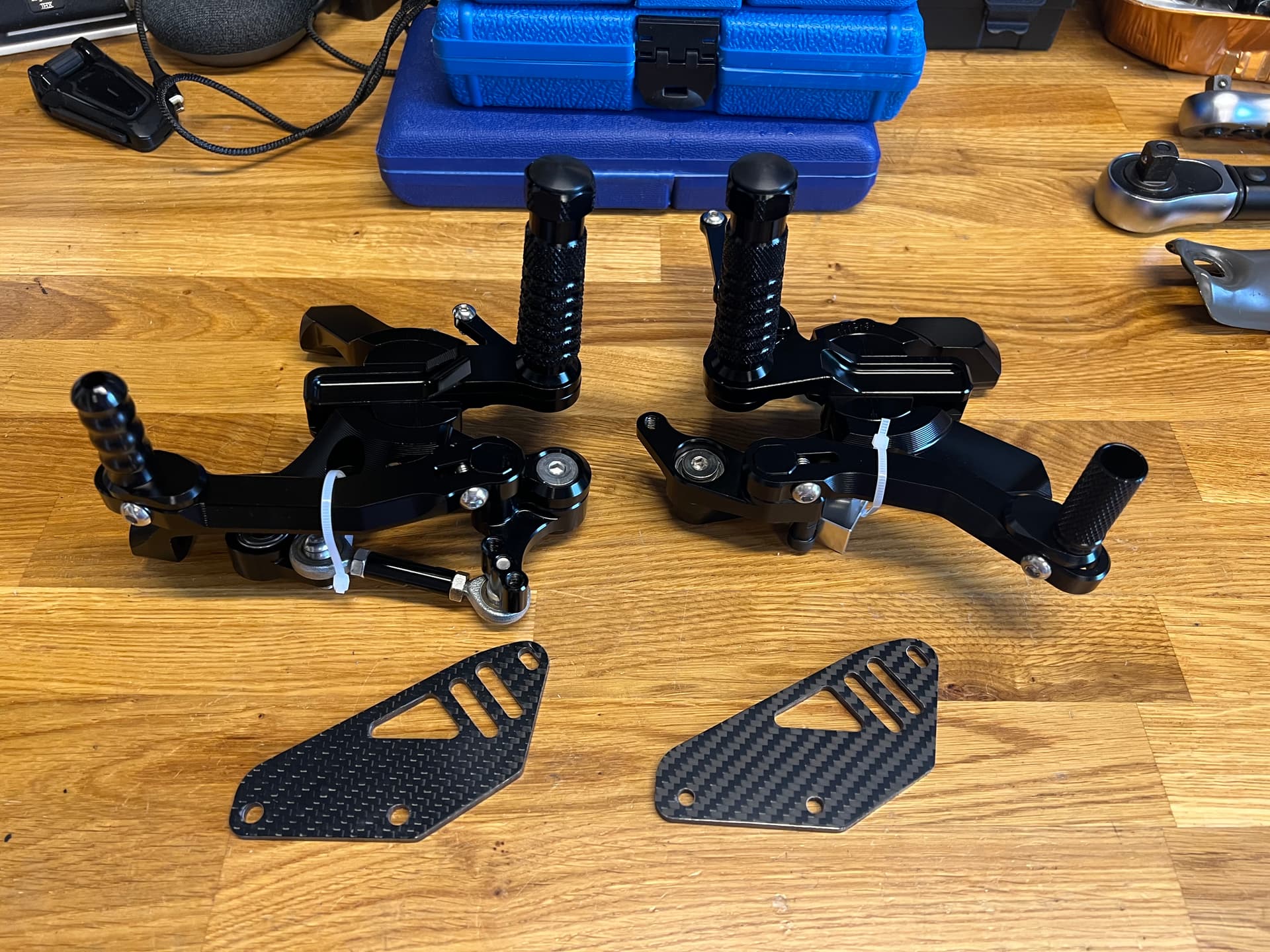

They look smart. All the adjustments you’d expect from aftermarket rear sets. Nice carbon heel guards too.

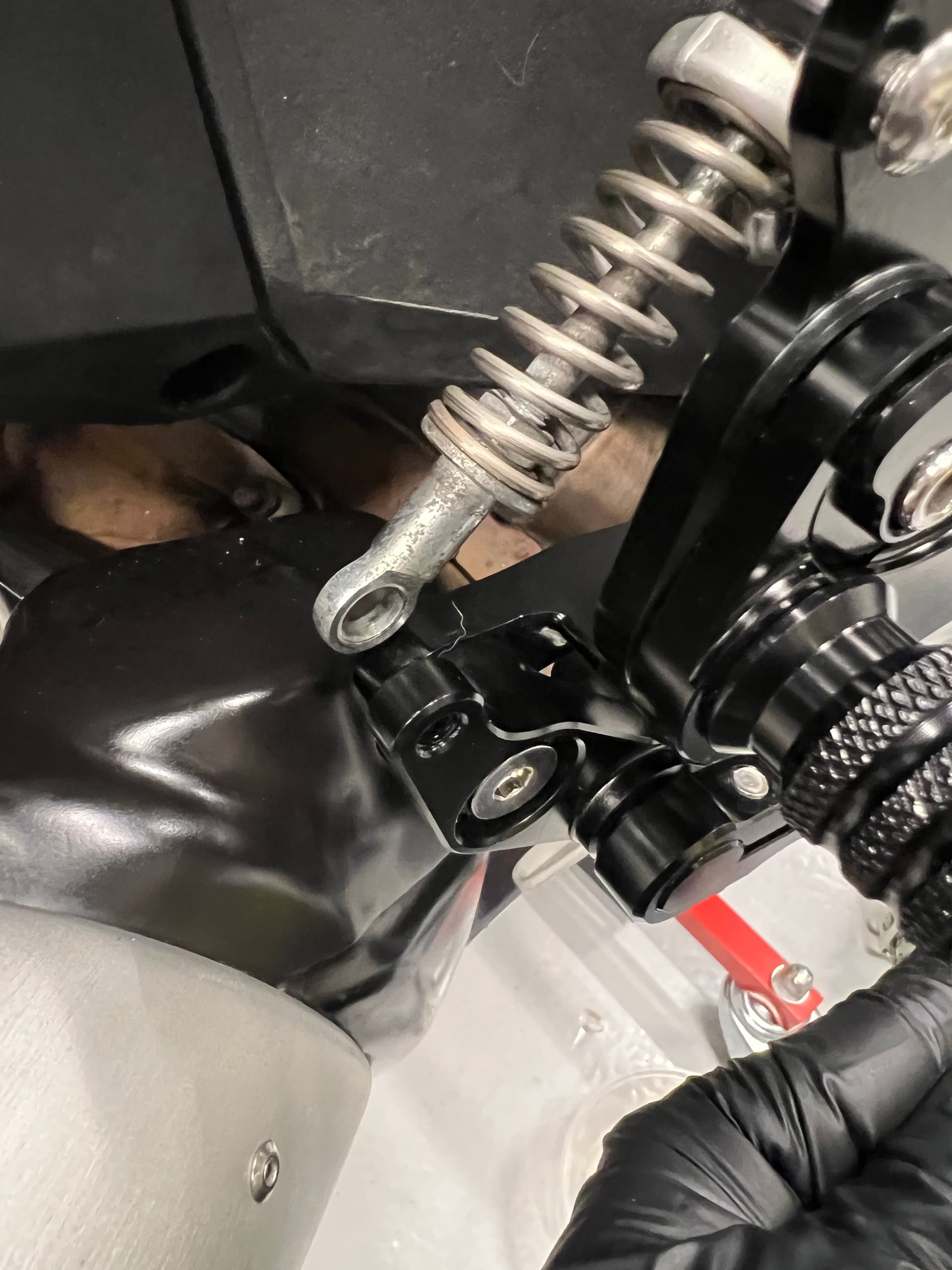

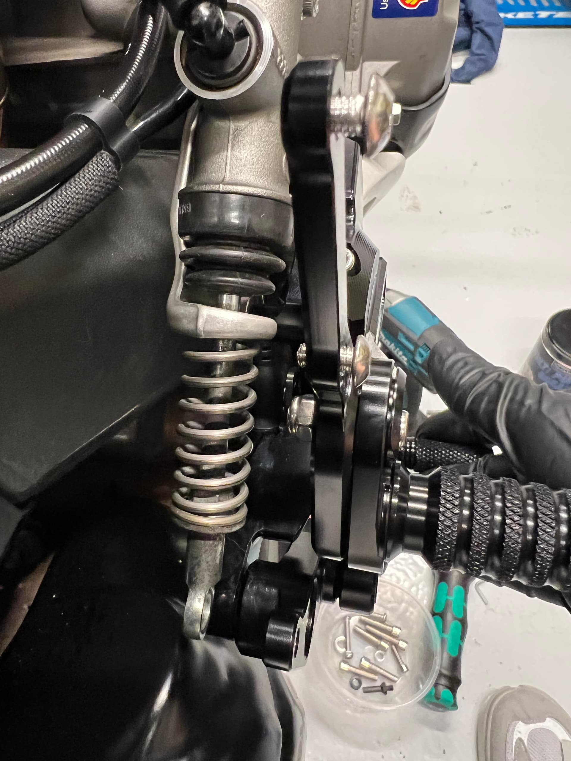

Ummm… There’s no way to mount the rear brake piston to the rears, and the spring is full extended in this position, so useless.

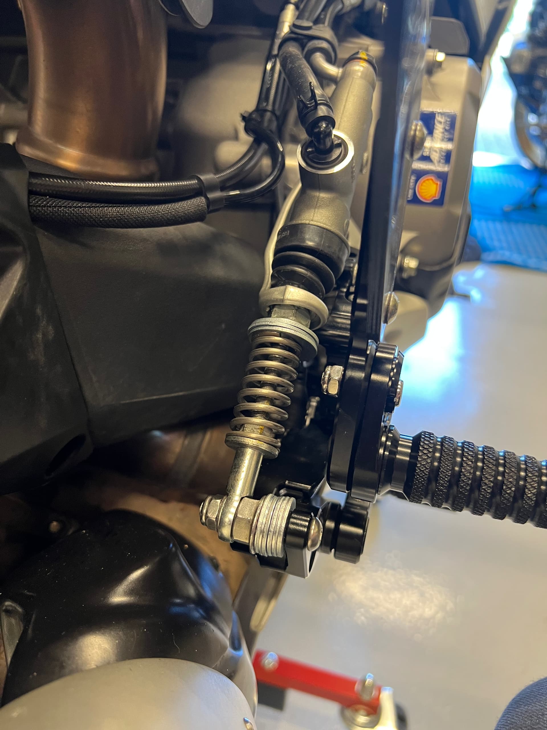

I fashioned up a way to mount it to the rears, and applied additional compression to the spring to ensure the foot lever returns to the resting position. A win I thought!
But no, the rear brake does not actuate. The piston is positioned too far outside the cylinder, it needs to be able to push further into it.

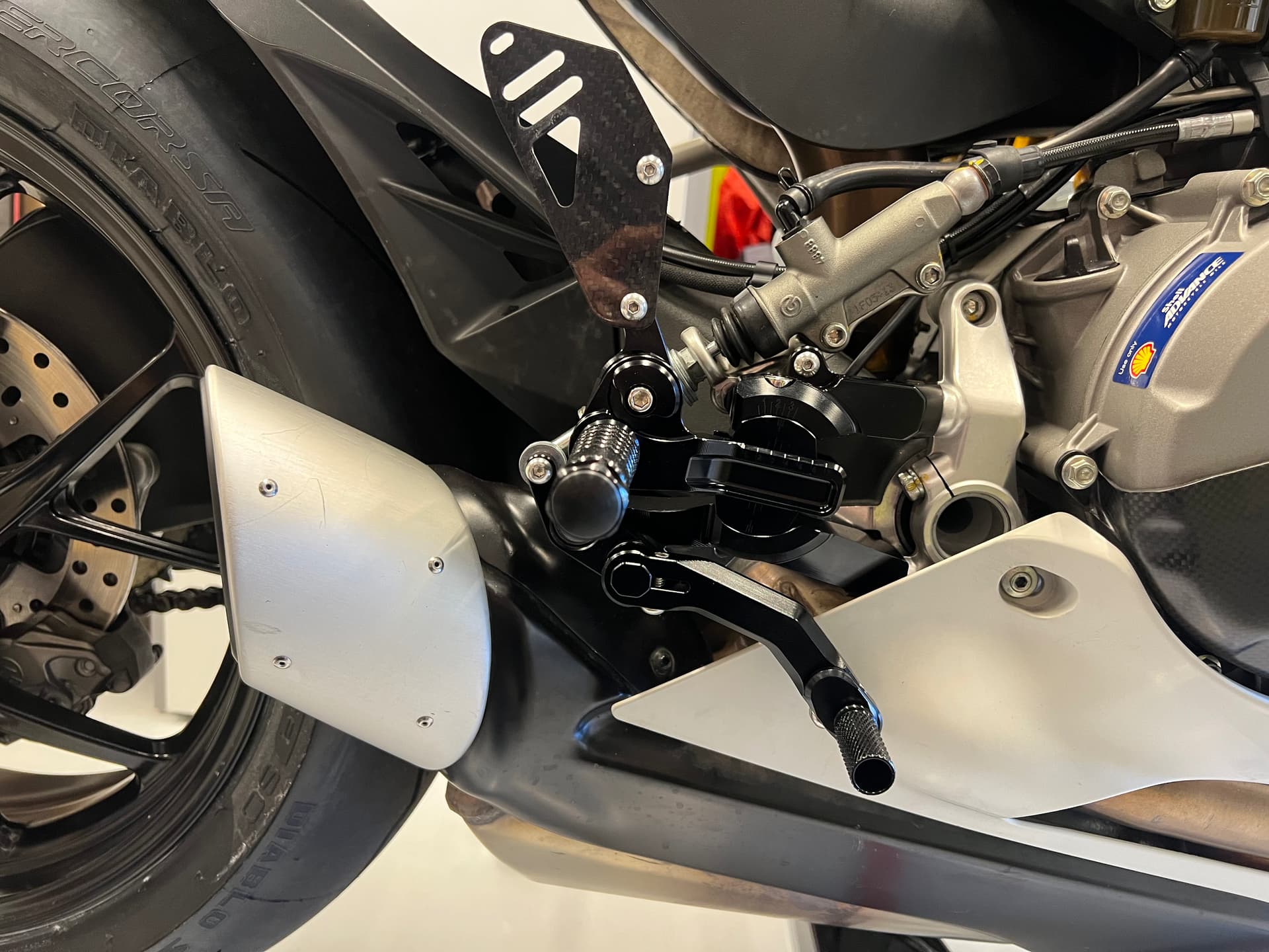

Installed on the left-side. This actually worked nicely. Annoyingly though, the 25nm torque setting for the rearset-to-bike seemed too high and I stopped short of the click as it felt like the thread was starting to stress. Ayeeeeeeeee.
