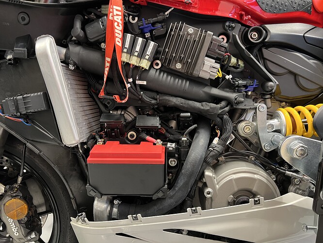

Fitted a lithium ion battery to the Panigale V2. The Troy Bayliss special edition V2 comes with one, so this is about trying to match that, make it a bit lighter for the track.
The OEM one weighed 2550g and the new one 649g, so nearly a 2kg saving. Feels massive in hand.
Ignition turns on. Not tried starting it yet as it was a bit late. Maybe tomorrow :slight_smile:
Are these numbers the right way round?
either way! 2KG that is insane!!!
Hahah, good spot. I’m tired :slight_smile:

Starts and runs fine. Of course, even though I have a dozen chargers and adapters, of course I don’t have the right combination and have to order yet another adapter for one of my Noco chargers to be able to trickle-charge it.
and who said proprietary tech was dead!!
Noco make great chargers, but their use of proprietary connectors is a shameful practice.
