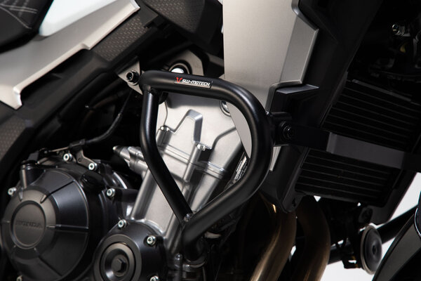

I put SW-Motech bars on my 2016 CB500F and found the very simple to install, and the ones for the CB500X are an identical design.
The official Honda ‘radiator shroud’ looks like it offers the same protection so may be a better choice if you also want a bar for mounting lights, albeit at a premium.
Unfortunately the design of the F does not allow any mounting points for light, bu I have fastened mounts onto the ends of the Motech bars… Not that I have installed the lights yet because Covid shielding started shortly after, but at least on the F the headlamp is awful and extra lighting is needed to ride at night. I would think the 2017 X has the same headlamp.

I cannot remember all the details, but did research before picking SW-Motech over Givi. What I do recall was that the tubs are slightly thicker (27mm vs 25mm) and have less of a bend making them less likely to break. Or something like that?
But the Givi bars essentially start perpendicular to the bike then making a 90° bend to go forward parallel to it, whilst the SW-Motech ones come away and forward more diagonally so the tubes bend at a smaller angle.
Mind, the main selling point may have just been them having a better shape to fit lighting.
If the tubes are thicker so they don’t deform as easily, then that means more force is being transferred into your engine and frame when they hit the deck. ie; a crumple zone doesn’t work very well if it doesn’t crumple.
A fair point, though I suppose it depends where and how fast you crash. Fortunately I only ever fall over quite slowly!
