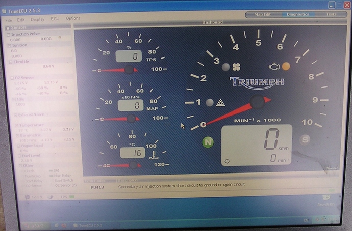

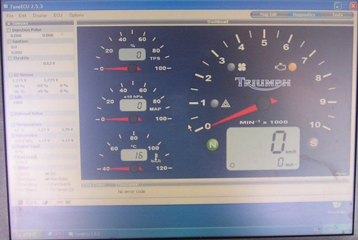

There’s really no risk in plugging it into TuneECU, just plugged in it will show you any fault codes. The risk only comes when you start fiddling with the map, don’t fiddle with the map. Read the codes and save yourself c£75.00 of hard earned. Here’s one I did earlier. The P0413 fault code was due to a poorly connected plug, more TuneECU showed me exactly where, amongst the many sensors to look, secondary air injection circuit.
Before and after cleaning and re-connecting the wiring loom plug/socket from the ECU to the secondary air injection loom.

Triumph didn’t think so, they upgraded the ECU software from 2014 onwards. Not sure if TuneECU have caught up with that as yet, read the instructions and FAQ with care
