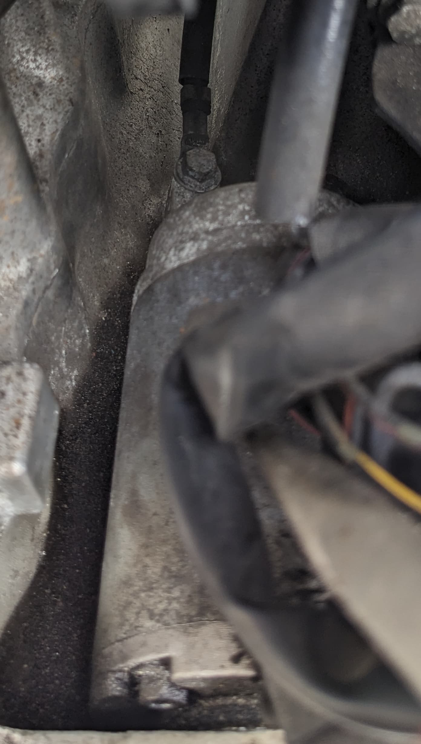

By “check” do you mean make sure the connections are clean and there is no visible damage to the wires? So far, I’ve only found a bit of corrosion on the inside of the positive cable that connects to the battery(bottom pic), is that of concern?
