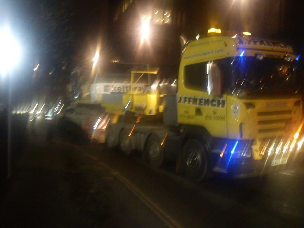

Fir instance … one of these … plus attendants
cost a lot more than one of these plus attendant …

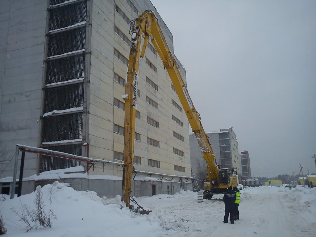

If you need to move 1 ton of steel you can use one of these
If you need to move 100 ton of steel … without doing lots of back and forth or having lots of the above you need one of these …
Now there is a production saving obviously but it aint as big as what you might think it is . Feel free to research how much it costs to get Justin to move something big across london as opposed to getting men to take it apart using lots of runs with a transit and then rebuild it at the other end . My argument is fact based , Its my job . In this area I am an expert witness with many many years experience on the super huge projects . I have worked on projects that added 30% more homes to a town . That scale of work needs massive infrastructure and planning that building one home on a plot does not even have a comparison with . Plug into the street hahahaha you gotta build the ferking street and the dual carraigway and the shopping center and all the other thing people and familys need that move into those homes .
