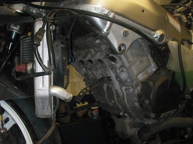

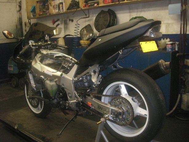

Bike is prepared and ready to begin
My old engine before it is taken out…

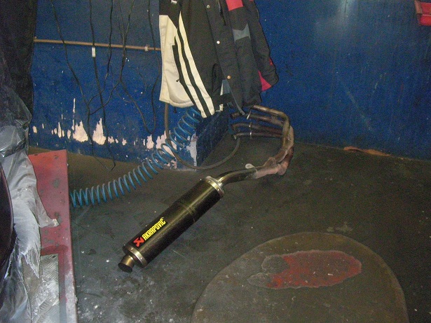

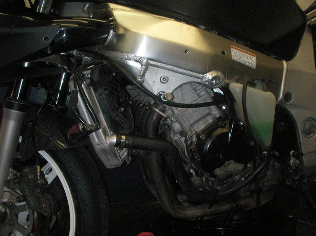

Pipes off, and placed in the corner

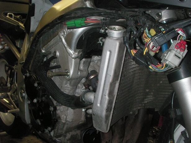

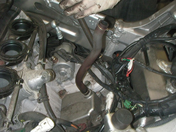

All hoses and electronic clips undone and the unbolting begins!

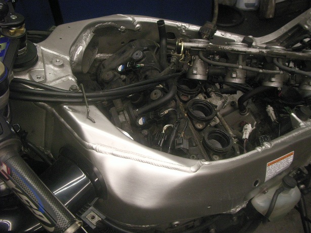

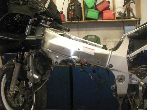

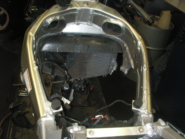

Very quickly after that we are left with just a shell…

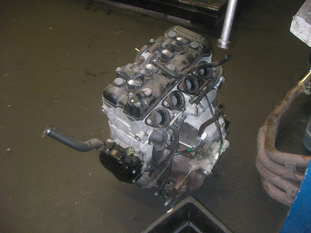

Then I changed the plugs on the new (old) engine and it was ready to be slotted into place…

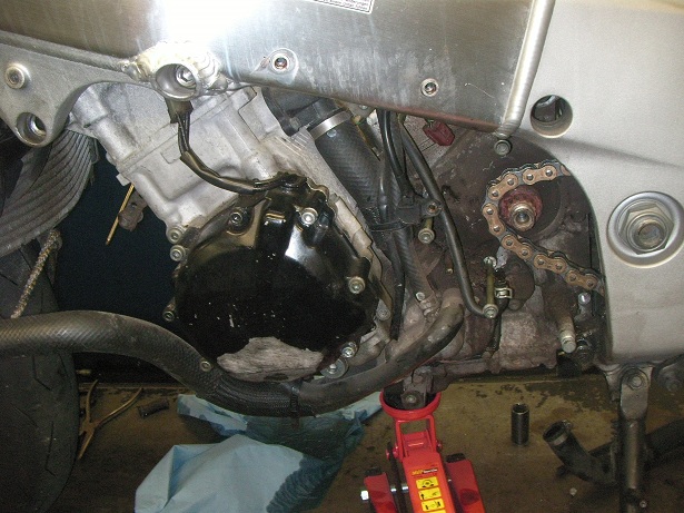

So we heaved it up…well the jack heaved it up :smiley:
