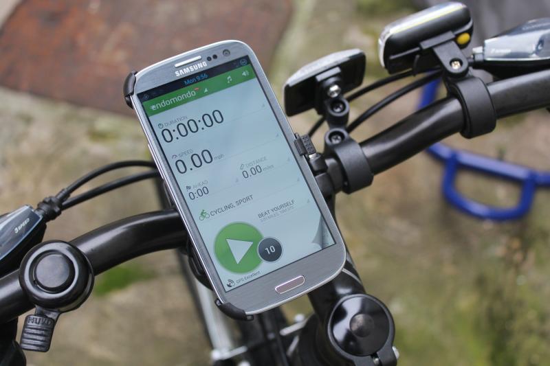

In the car I always use Google Navigation and recently I’ve been wondering how best to mount my phone on the handlebars and fit Bluetooth into my helmet.
The BT helmet may well be covered for as little as £40 - http://amzn.to/YhCaLP
Someone on another forum has one, says it lacks any base, but generally pretty loud and clear.

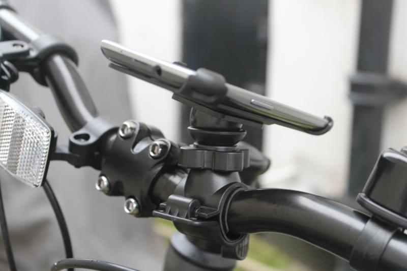

The mount, I’ve order the same one I have on my bicycle for only £7
I’ve found it surprisingly sturdy. Whether I will trust it at high speed on a bike… not sure.
I also then need to figure how to keep it dry when it’s raining. I might go for a proper water proof mount for around £50… but maybe after I’ve upgraded to the Galaxy S4 :slight_smile:

Need to see more of the Note 2 mount, the bit I can see looks to be identical to the bracket on my S3 mount…
they probable are the same mount but with a case instead of a clip i trust the case alot more just in case it does fall off the phone is protected and its protected from weather as well
The mount on mine is a scree fitment with a second security screw .
I thought that, but it’s actually hard to unclip even using both hands to do so.
Thats good means it shouldn’t fall off lol
