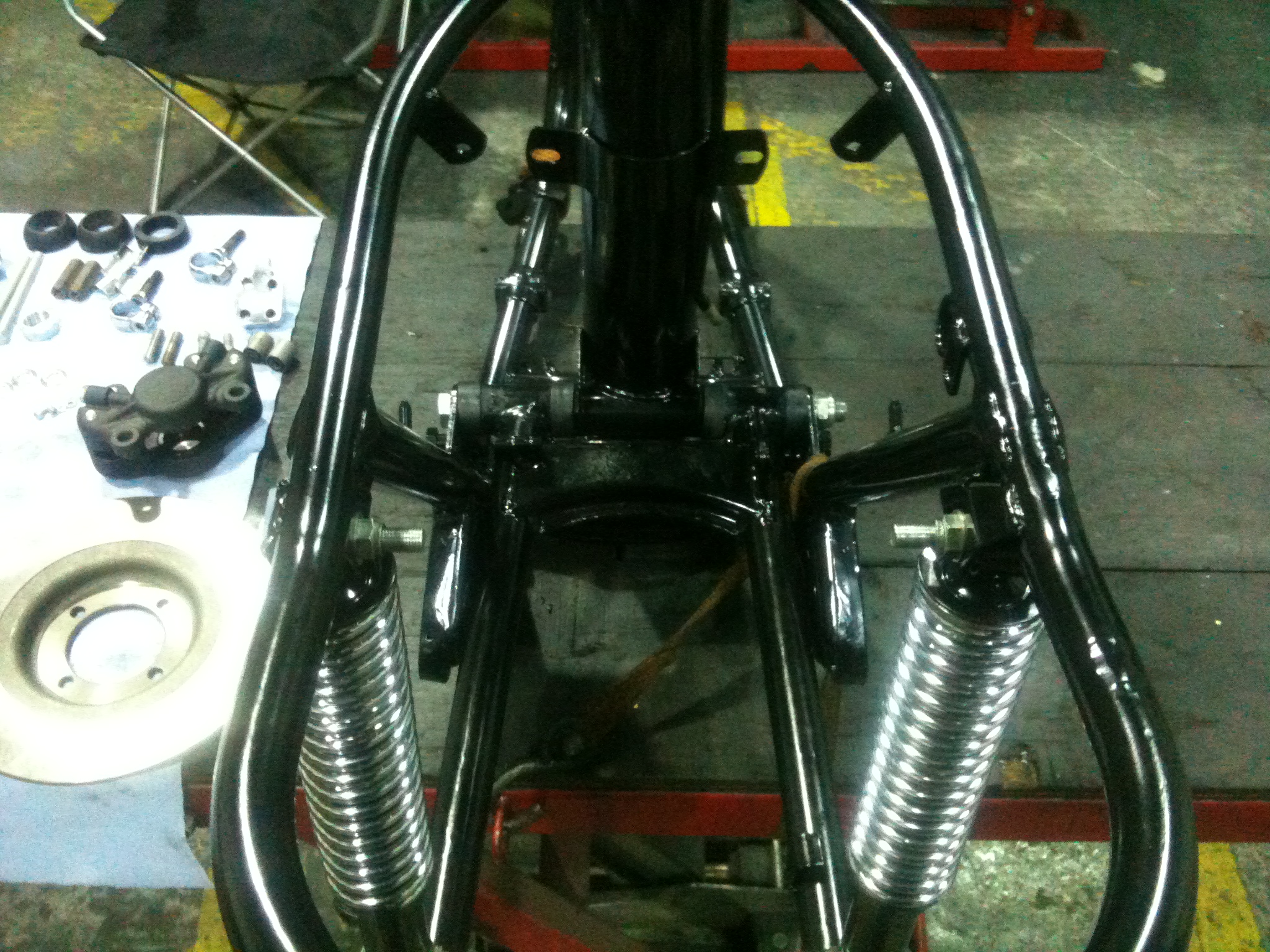

well, ive hit a brick wall today!! no parts in the stores!! ive built the back wheel up, tyre on, sprocket on, disc on, NO rear wheel spindles!!! so i thought id put the ignition box on!! no mounting plates for that!! so i thought id put the front brake on and bleed it through!! NO, waiting on parts for the front master cylinder!! i might see if theres a coil tray in the stores and stick that on!
im off down to L.F. Harris in torquay the week after next to build the engine from scratch, i was hoping to have a rolling chassis sorted by then, just depends on the parts!!! i’ll just stick a rod through as a spindle for the time being!!:hehe:

only the one pic from today, just put a bit of bar through as a spindle so i could move it about, managed to make up a plate to mount the black box so will fit that in the morning:D
box on, coil tray on, done my seat!!(what a pain in the arris)!!
