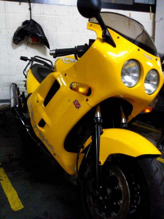

Triumph Daytona 900 £500

Hmmm. Slightly tricky one this. The bike is in lovely condition, but the throttle cable is a bit iffy with the oxford grips… I might take those off and fit the Triumph grips I still have at home if they will fit… Throttle grip seems to shift on the throttle spline and jam open. Not what I want riding a bike. So I will strip it down and have a look. Choke is nice and smooth.

Just stripped the throttle down. Cable had slipped off the guide. I’ll drip some 3-1 oil down the cable as well as it is a bit stiff.

Took beast for MOT today. Failed on binding rear caliper, so a very easy fix! Quite happy with that as it is really in great nick. Just sorting the battery and away it goes. Insurance for a year is £106 TPFT with Zero NCB. Cannot add to other policy as that is a single bike policy, but not a big deal. At least it is almost legal to ride! MOT and then Tax.
